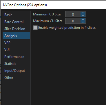

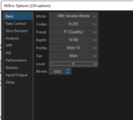

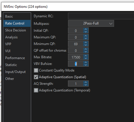

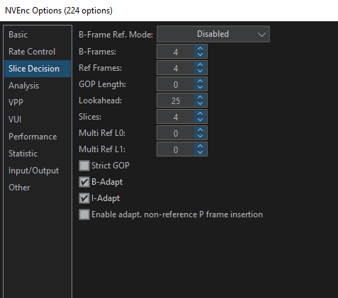

I want to encode movies in small size but good quality output. I have tested multiple settings but not able to get good quality result. Below are the setting in staxrip that i have changed from default, rest all the settings are kept as default:

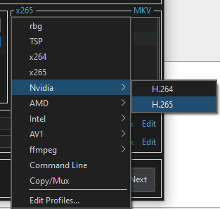

NVIDIA -> x265
[Attachment 70601 - Click to enlarge]
[Attachment 70572 - Click to enlarge]
[Attachment 70573 - Click to enlarge]
[Attachment 70574 - Click to enlarge]
[Attachment 70575 - Click to enlarge]

NVEnc is not x265; the x265 encoder does not use the GPU, so it usually takes more time, but instead it is able to do a lot more complex calculations, so it can superseed NVEnc quality-wise by far.
