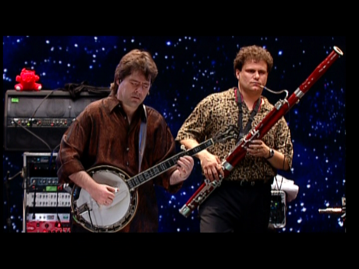

  1. Hello everyone, today I'd like to share a goal I've set myself and that'll be a good learning curve as well.
    One of my favourite music show is Live at the Quick from Bela Fleck and the Flecktones and the best available quality is in DVD9 which I own. The first step I've done is to remux it to a single MKV file with MakeMKV. This is the only step so far I've done as it's the only non-destructive thing I could do. Here's a screenshot for reference.
    [Attachment 70550 - Click to enlarge]
    Here's a list in which I think the order is right of things I'd like to validate on how to get the best results with the goal of watching this in 1080p and 16x9 while keeping in mind that the end product needs to look better than before I'd processed it. I would like to do everything possible to work with the less destructive options and best practices.
    1. Remux with MakeMKV
    2. Crop the top and bottom black bars from DVD9 letter-boxing
    3. Upscale the video to 1080p
    Also I've seen many up-scales on YT in 60 fps. Shouldn't we keep the original frame rate?
    Thank you!

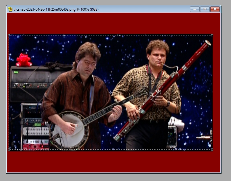

    That DVD frame is skewiff. The red is the black space around the frame; the marquee is the true 16:9 frame:
    [Attachment 70559 - Click to enlarge]
    If you want it to be totally black-bar free, you'll need to lop off the large right margin and the small left margin. Also, the video itself isn't quite 16:9; you'll need to trim off the top and bottom a bit. How you do that in AVISynth I do not know.

    The left and right black bars needs to be kept since the interview parts are taking the whole screen.
