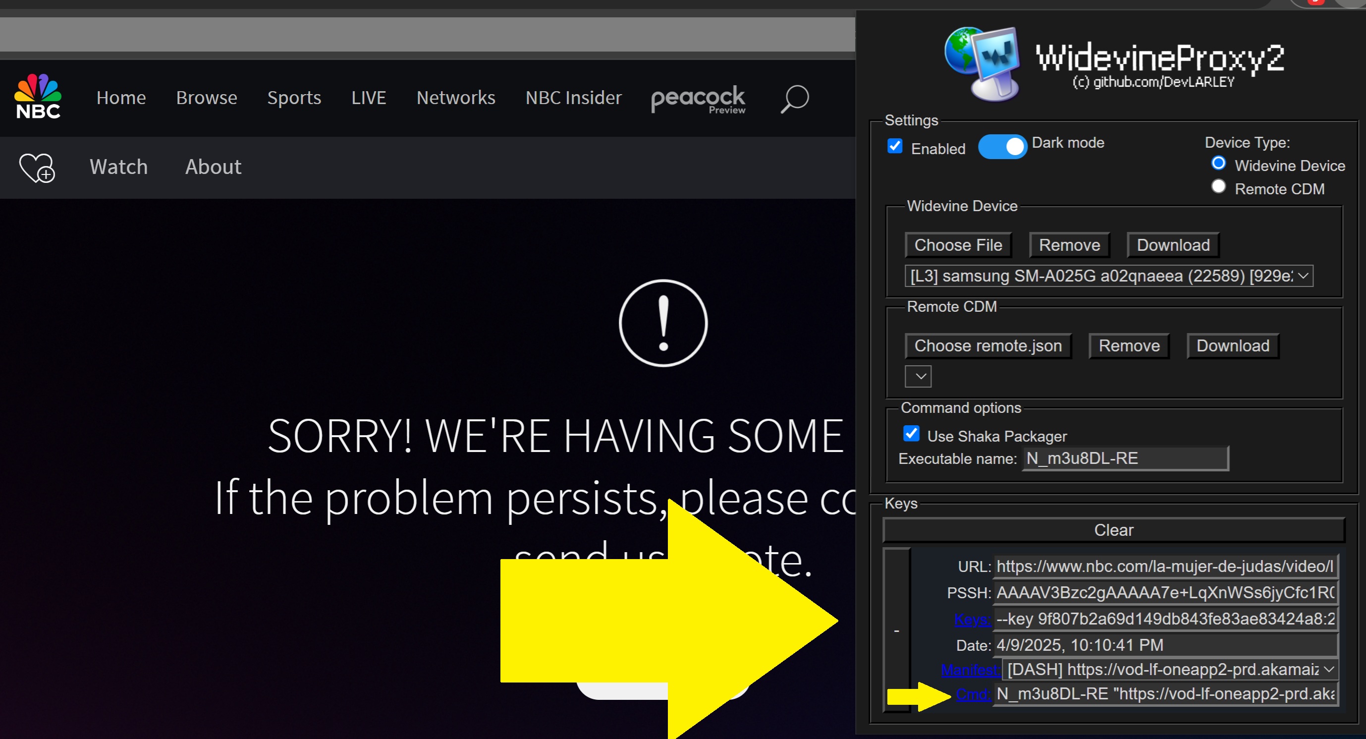

  13. The server is not authenticated in the zone. it says. why? thanks a lot!! N_m3u8DL-RE https://vod-lf-oneapp2-prd.akamaized.net/prod/telemundo/cVw/uDo/9000436644/17386912548...Narrative=true -M format=mkv
    How can I get key...? N_m3u8DL-RE "https://vod-lf-oneapp2-prd.akamaized.net/prod/telemundo/CiH/iYE/9000436649/1739224047141-sMWln/cmaf/mpeg_cenc_2sec/master_cmaf.mpd?audio=all&subtitle=all&forcedNarra tive=true" --key e9fec92723384fe3935768bd72043eca:87f94eeb9a7b9e9d2 eaf0bb5cc821bc2 -M format=mkv
    This link format? Thanks!!
  14. Thanks but I cant install to my chrome the widevine proxy. Can you help me step by step, please? Sorry, but I am stupid a little bit for this.
  15. Hi. Can you write me all 126 episode N_m3u8DL-RE links, please?? Thank you very much!!!!
