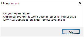

    On running the script via VirtualDub, the processing stops with the error -
    [Attachment 70568 - Click to enlarge]
    So presumably the appropriate codec is missing to decode the avi video?

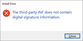

    On searching for solutions to this issue, I thought the appropriate codec to install could be "Cedocida DV codec", I downloaded this codec and tried to run the accompanying ".inf" file to install this codec but got the error -
    [Attachment 70569 - Click to enlarge]
    Tried several times to install this codec but continued to receive this same error message with the codec not being installed I believe.
    Is this Cedocida codec the right codec to use here? If not, then which codec should be used instead?
    If this Cedocida codec is the correct codec to use, then why won't it install? I'm running under Windows 10 Pro 64 bit.

  8. fourcc LAGS is for lagarith. Install lagarith
  9. Thanks for clarifying that!
    Lagarith downloaded and installed.

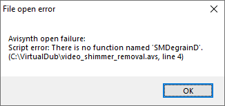

  10. SMDegrainD is dogway's version of SMDegrain . I renamed the function with "D" to differentiate it between other versions.
    https://github.com/Dogway/Avisynth-Scripts/tree/master/SMDegrain
    https://github.com/Dogway/Avisynth-Scripts/blob/master/SMDegrain/SMDegrain.avsi

    Tried running the script named "video_shimmer_removal.avs" which contains the code as mentioned previously, ie

    But again got an error message about there is no function SMDegrainD !?
    [Attachment 70582 - Click to enlarge]
    What is wrong now?
  12. plugins+ is for 32 bit filters. plugins64+ is for 64 bit filters.
  13. I edited the avsi function name to "SMDegrainD" on line 93 . If you don't edit it, you can call it SMDegrain (no D)

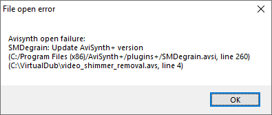

    As far as I'm aware all plugins (I've added) are 32 bit(?)
  15. Update AviSynth+ version means your avs version is too old
    I'm using r3961 (3.7.3 test 9) x64 . All plugins x64
    https://forum.doom9.org/showthread.php?t=181351
    Or you can try using a different SMDegrain version .

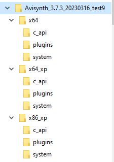

    Unzipped AviSynth+ V 3.7.3 test 9 directly to C: drive.
    Directory structure looks like this under C: drive -
    [Attachment 70592 - Click to enlarge]
    Then tried running Version() script (in version.avs) under VirtualDub using VirtualDub 32 bit executable (VirtualDub.exe) and then the 64 bit executable (VirtualDub64.exe).
    Both VirtualDub executables returned the same error message after running the version.avs script -
    [Attachment 70594 - Click to enlarge]
    I believe that suggests that AviSynth+ has not been "installed" correctly!?

  17. If you have a valid avisynth+ install, all you need to do is replace avisynth.dll in Windows\System32 directory for x64 ; or Windows\SysWOW64 for x86 . A previous install is required for that method of upgrading, because of registry entries.
    So re-install this old 3.7.2 version first, then copy/paste the new avisynth.dll to "upgrade"
    https://github.com/AviSynth/AviSynthPlus/releases

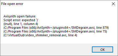

    EDIT2: Still running AviSynth+ V 3.7.2. I managed to get the video_shimmer_removal.avs script sort of running under VirtualDub2 64 bit executable.
    But now get this error -
    [Attachment 70597 - Click to enlarge]
    What is wrong now?

  19. Use x64 for x64, "xp" is just for legacy OS (it refers to windows xp), but it's the only one provided for x86
    For the SMDegrain.avsi script, make sure you download it correctly, not an .html file . Open it in notepad to check
  20. OK. Copied the AviSynth.dll file from the x64 sub-directory of the latest AviSynth release (v 3.7.3 test9) to C:\Windows\SysWOW64 directory which replaced the existing old version of AviSynth.dll. But on running Version() script via VirtualDub2, I still get the message that AviSynth+ is still at V 3.7.2. So the 64 bit replacement of file AviSynth.dll didn't seem to upgrade AviSynth+ to V 3.7.3 test9!?
    I copied the script for SMDegrain directly from here using copy raw content. So the content shouldn't have any html nor anything else that might cause issues, I believe(?)
    Below is attached the SMDegrain,avsi file that I have.

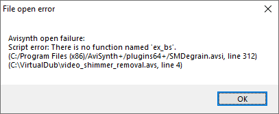

  24. Thanks for the zip file!
    Replaced my version of SMDegrain.avsi with your version.
    Ran the shimmering script again, but this time received another error message as below -
    [Attachment 70604 - Click to enlarge]
  25. ExTools.avsi is a prerequisite for that version
    https://github.com/Dogway/Avisynth-Scripts/blob/master/ExTools.avsi

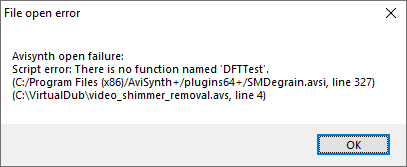

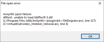

  27. The error message tells you what the problem is. Search google for "avisynth DFTTest"
    http://avisynth.nl/index.php/Dfttest
    https://github.com/pinterf/dfttest/releases
  28. Thanks for the links.
    Downloaded appropriate file and installed.
    Ran shimmer script again, made some progress, but got this error in the end -
    [Attachment 70609 - Click to enlarge]
    I used Google to search for file libfftw3f-3.dll, which seems to be a system file and which should be installed in C:\Windows\SysWOW64 and/or in C:\Windows\Sytem32 directories, I understand.
    Google search turned up a fair number of results for this file, but it is not clear if these files are 32 bit or 64 bit. Plus there is contradictory advice as to how to install this file. Usually the advice is to copy the same file to both system directories (regardless if the file is 32 or 64 bit!?)? Restart computer and/or run regsvr32 on the file to register the file on the system.
    Downloaded this file a few times from different sites. I tried several times to run regsvr32, but this resulted in an error message to the effect that the libfftw3f-3.dll file may be the wrong version for my system. Tried running the shimmer script again anyway, but again got this same error message.
    One site in particular here, has literally dozens of 32 bit and 64 bit versions of file libfftw3f-3.dll! So how do I know which version of this file to download?
    EDIT: Never mind! I finally found the libfftw3f-3.dll files (32 bit and 64 bit) from here! Hell of a job finding these files!
    Another error was found after running shimmer script, "MSuper" was missing. I found this in MVTools which was downloaded and installed.
    As of now, the shimmering script seems to be working at last!!
