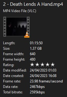

    Thanks, but it's not that. As I wrote, half the mp4 files on the flash drive play just fine on the TV: the other half, the ones with no video data showing in Windows Explorer, don't. They hang in VLC on my PC as well (whereas the exact same files on the hard drive play OK).
    Just to be 100% clear, here's a sceenshot of a 'good' mp4 in Windows and one that won't play. Only the files I copied to the flash drive after turning off indexing (that's my best guess for the cause) have the video data missing and won't play.

    This is the info for the (working) file on the hard drive:
    Complete name                            : F:\2.mp4
    Format profile                           : Base Media
    Codec ID                                 : isom (mp41/avc1)
    File size                                : 1.34 GiB
    Duration                                 : 1 h 13 min
    Overall bit rate                         : 2 595 kb/s
    Frame rate                               : 23.976 FPS
    Encoded date                             : 2023-04-24 03:55:25 UTC
    Tagged date                              : 2023-04-24 03:55:25 UTC
    Writing application                      : vlc 3.0.16 stream output
    And this is when I copy the file to the flash drive:
    Complete name                            : G:\2a.mp4
    Is that the data you were asking for?
    As for the drive not being genuine.. that may be so. I can test whether it reached a limit by deleting all the non-working mp4 files on it and then one or two of the OK ones and see if the first ones I copy back are functioning properly and then the problem restarts. Maybe the indexing thing is a red herring - I was only guessing. That said, the 'bad' files do not disappear when I reconnect the drive; they seem to be there permanently.
