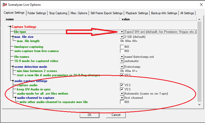

    Are your setting for type I or type II? Also try Sclive instead.
    [Attachment 70486 - Click to enlarge]
    I'll try that app soon.
