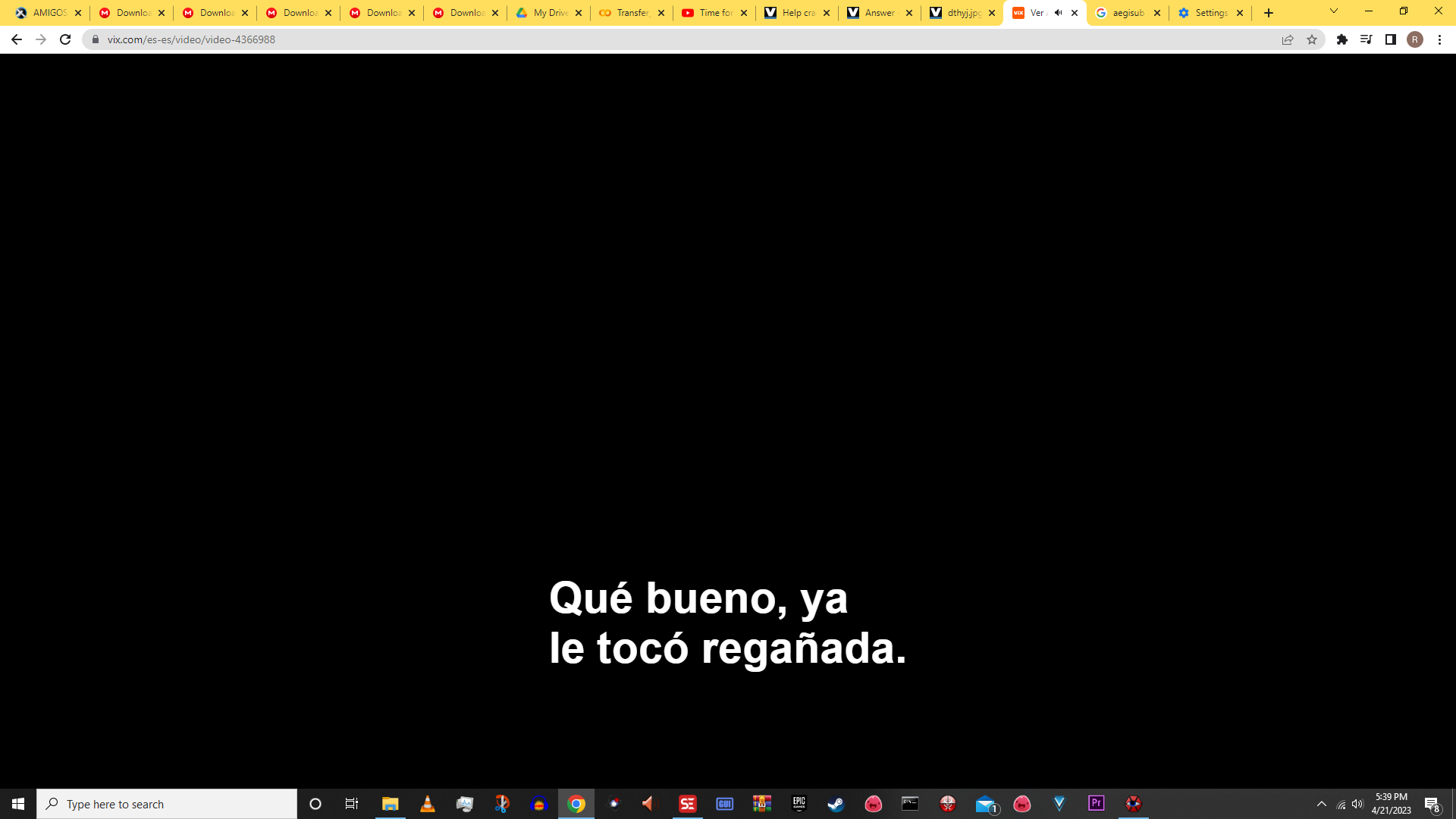

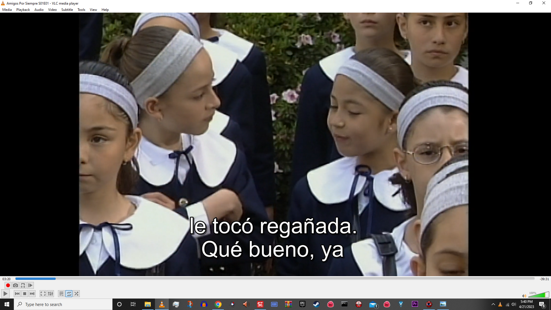

    Hi i download subtitle from xml and convert to .srt but when i play the video the subtitle position got wrong
    example:
    Hi, How are you
    I`m Fine
    become:
    I`m Fine
    Hi, How are you
    do you know how to fix it without change it one by one?
  2. SRT doesn't really support explicit positioning of subs. You're problem is probably a result of overlapping (in time) subs and the way particular SRT renders deal with them. Some subtitle editors let you automatically fix overlapping subs, set minimum time between subs, max line length, etc. You'll have to analyze what causes your problem and try those fixes.

  8. The xml timings are wrong.
  9. I don't think the xml timings are wrong. But the way the renderer stacks subs that occur at the same time are the opposite of the way the program that converted them to SRT stacked them.
    xml
    <p end="00:03:22:24" xml:id="p55" begin="00:03:19:24">Qué bueno, ya</p>
    <p end="00:03:22:24" xml:id="p56" begin="00:03:19:24">le tocó regañada.</p>
    SRT:
    36
    00:03:20,000 --> 00:03:23,000
    le tocó regañada.
    Qué bueno, ya
    So this appears to be a problem with the conversion program.
