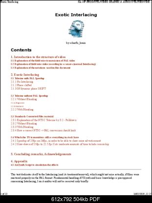

    Unless I'm misunderstanding something, but shouldn't VCR footage be fully interlaced instead of progressive?
    No. A useful guide here:
Name:	Exotic Interlacing(English).pdf

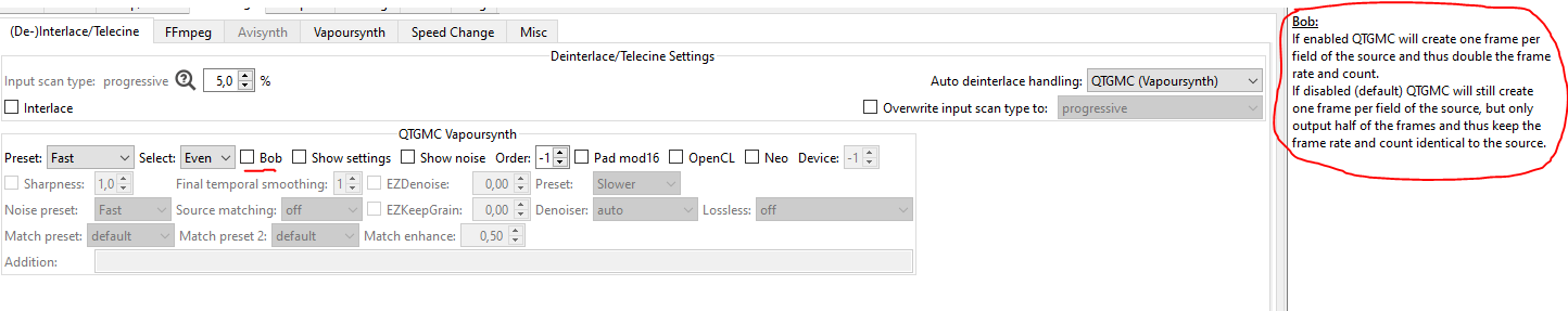

  13. Originally Posted by oln View Post
    Which "bob" setting?
    I was referring to the one you can tick in Hybrid. Not sure how it'd look like in a "raw" script.
  14. Ah I see. When you use it in a script bob is what's done unless you explicitly specify "fpsdivisor=2" to output at half frame rate, so hybrid's author changed around a bit how it's specified in the GUI.
