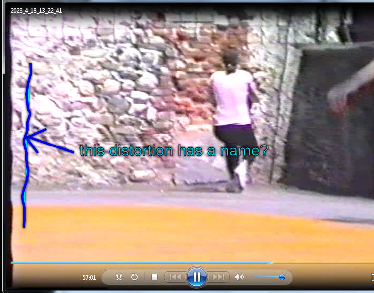

  6. thank you very much, and another question:
    the "distortion" showed on the image has a "technical" name?
    there are existent plugins/algorithms/tools that can "align" the video ? ( these clips are coming from a VHS-C camcorder and are all showing these "waves" ..and are now on a standard VHS tapes)

  7. Captures & Restoration lollo's Avatar
    Jul 2018
    Italy
    skew errors, horizontal wiggle, time base errors, flagging. Other users may help you with a better technical definition.
    http://www.avartifactatlas.com/artifacts/skew_error.html
    Not really fixable in post-processing, you need a lineTBC in your workflow. If the defect has been "baked" in the vhs recording at the time of its creation from the VHS-C transfer, is there forever.
  8. very thank you Lollo!
  9. [QUOTE=lollo;2687435]
    I was thinking the same.. no software are able to "unskew"... BUT (after a lot of experiments) i bought a Philips VR1000 that with the integrated TBC can restore the vertical alignment (very well) also on tapes recorded from VHS-C with a bad rotating drum
  10. Captures & Restoration lollo's Avatar
    Jul 2018
    Italy
    Excellent! A proper vertical alignment is (one of) the purpose of a lineTBC correction
