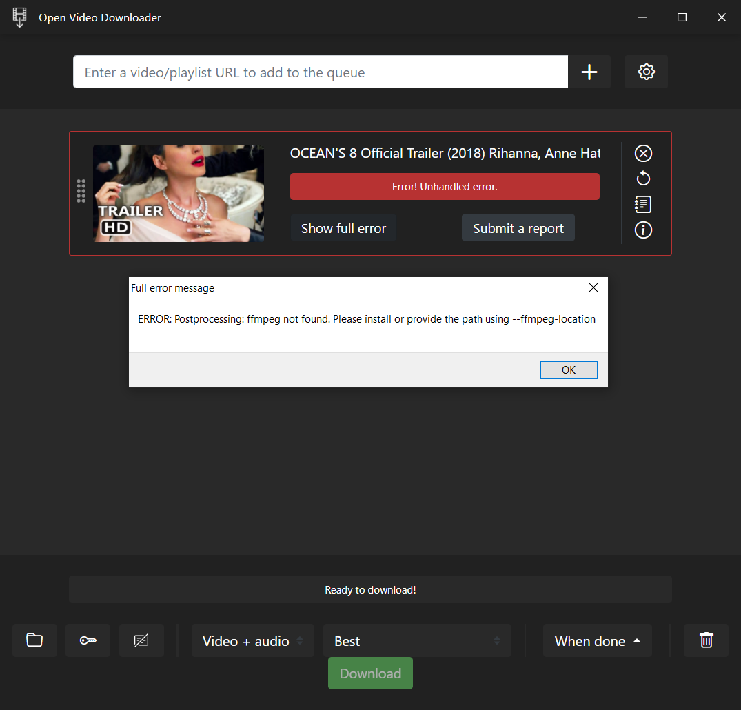

Trying to get Open Video Downloader working on Windows 10 but on trying to download a video with it I get:
"Error! Unhandled Error"
on clicking Show Full Error I see:
"ERROR: Postprocessing: ffmpeg not found. Please install or provide the path using --ffmpeg-location"
So I've installed ffmpeg into a folder called ffmpeg off C:\ and added that to the PATH environment variable but still no luck.
Note that inside the ffmpeg folder are three sub-folders - bin, doc and presets.
I also have youtube-dl.exe in another folder, not sure where to put that?
Where am I going wrong?

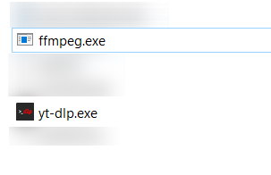

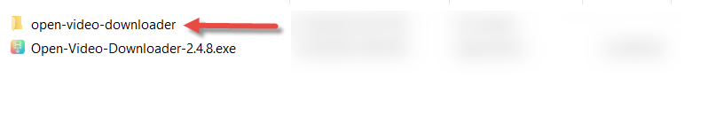

Then simply download ffmpeg and place it inside the "open-video-downloader" folder that was created by the application:
[Attachment 70418 - Click to enlarge]
[Attachment 70419 - Click to enlarge]

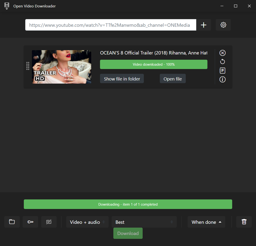

then restart the application and you should be fine:
[Attachment 70420 - Click to enlarge]
