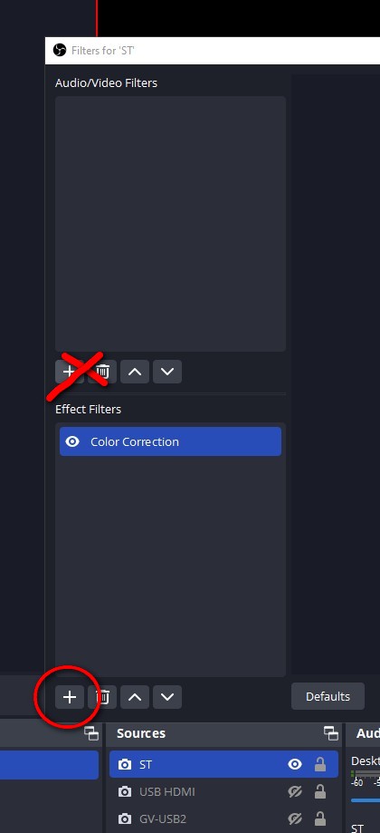

    On further investigation, you can indeed.
    RC on your source device, choose Filters. Click the lower + sign and click color correction, then OK. The color correction options and sliders, including Gamma, show up.

    I did all that. I get something called "Effect Filters". Clicking on the "+" sign brings up a list of audio filters (3-Band Equalizer, Compressor, etc.). Nothing for Color Correction.
    OBS Studio v 29.0.2 (64 bit)

    You're clicking on the + for Audio/Video Filters. Go down a box to the Effect filters area:
    [Attachment 70386 - Click to enlarge]
    In this example, I've already activated the Color Correction filter.
  7. The problem I was having was that the "+" sign for the Effect Filters was completely hidden by the task bar (720 x 1280) which is a bug as far as I'm concerned. When I moved the task bar to the left of the screen the "+" sign was revealed.
    There is plenty of screen real estate to shorten that window by 40 pixels so that the task bar doesn't cover an important part of the user interface.
    Thank you for your help.

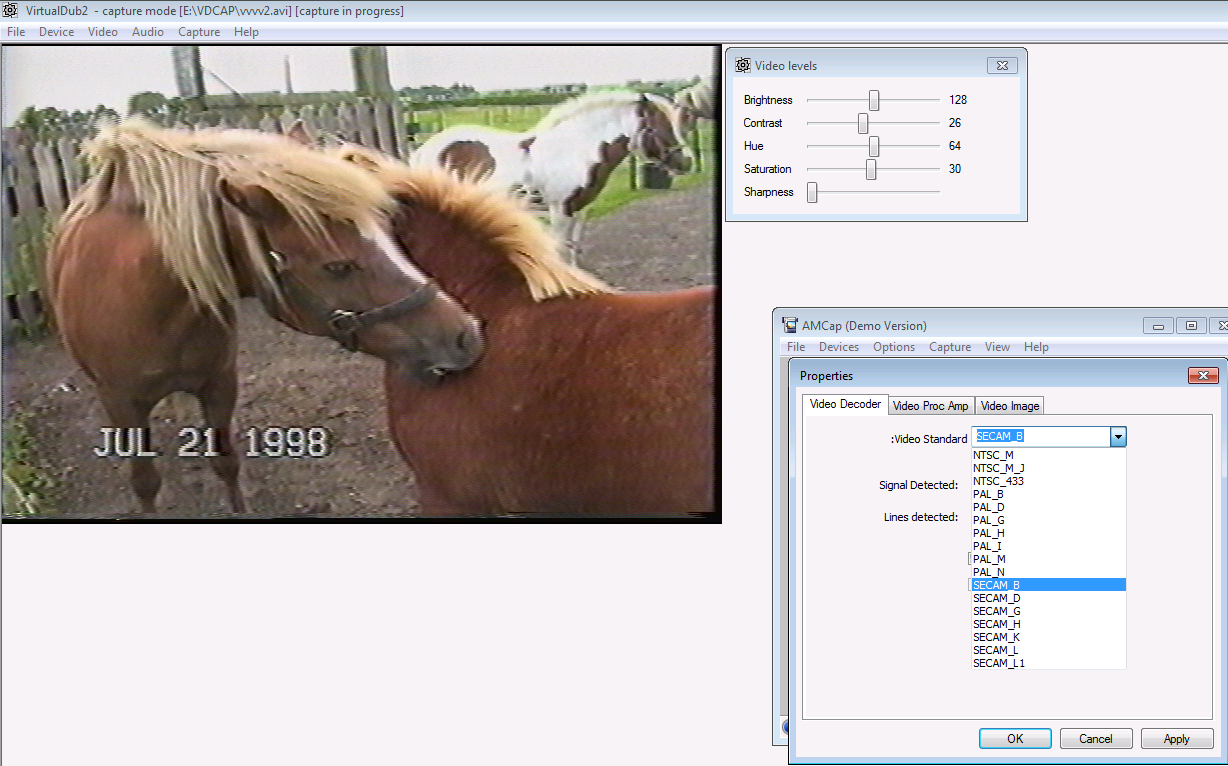

    You can also use some other capture program which lets you access the procamp settings during capturing.
    I use the Amcap tool for that
    Here using it to adust the video standard "on the fly" to SECAM B for PAL60 capturing.
    [Attachment 78362 - Click to enlarge]

    @Doman, yes, but Graphstudio will allow you to access the proc amp when you're setting the Brightness and Contrast using the VDub histogram.
    Using the Amcap example shown, i can change the procamp settings also during capturing/monitoring with VDub/Amarec and a Dazzle DVC100.
    Just ignore the error "device in use" when starting, you still can access/change the procamp settings.
    The Device properties for the GV-USB2 are greyed out during capture, I can't adjust the proc amp during capture with Amcap.
    Ok, possible it depends on the capture device/driver?
    Will take a look later at GraphStudio too.

    The levels tab is a shortcut for setting the proc amp levels itvl doesn't work with GV-USB2 it says something like no level driver available for this device, works on others.
    Not sure what you mean; what program are you in here?
    VD has a level option in the menu it gives you access to brightness and contrast without having to go into proc amp
