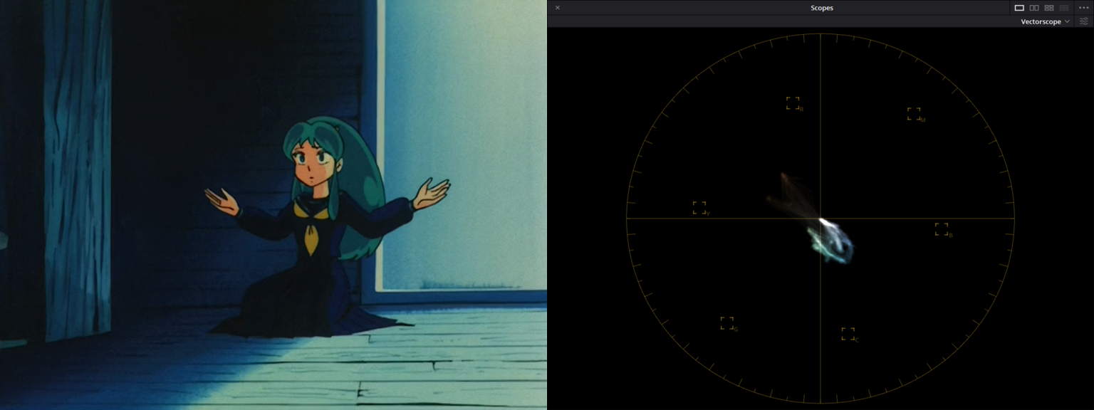

  4. Here is a blind test.
    The screenshot was taken with direct control over YUV to RGB conversion (601 matrix for SD, 709 for HD) . The HD versions were resized after the RGB conversion to match the SD versions
    If your playback chain is setup correctly, this is what the 4 samples should look like
    A vectorscope trace is attached to each
    Which one is "shifted" with the "green tint" ?

  6. Originally Posted by feynek View Post
    I would say B? This is so weird actually xpp
    Nope.
    So you thought there is a "green tint" in "b" ?
    a000000.png corresponds to sample04-sd-10bit.mkv . They were in reverse order

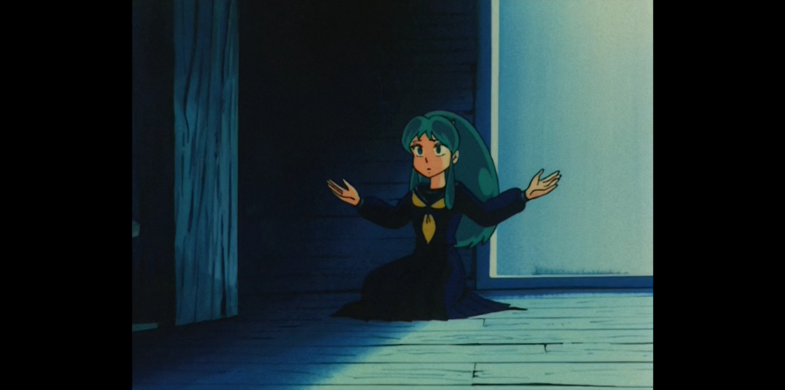

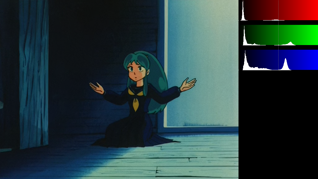

    But there is a mild shift in your screenshot for sample04 compare to 03. Attached are your SD samples 03,04 with RGB histogram
    [Attachment 70359 - Click to enlarge]
    [Attachment 70360 - Click to enlarge]

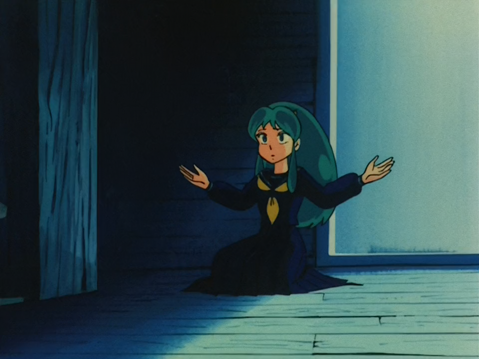

    My mpchc screenshots do not exhibit the shift .
    [Attachment 70361 - Click to enlarge]
    [Attachment 70362 - Click to enlarge]
    So underlying videos are ok. Something is probably misconfigured on your setup for playback . What decoder ? HW/SW decoding ? What renderer?

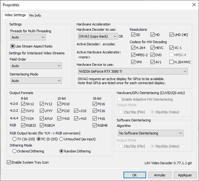

    So, I am using LAV with hardware decoding :
    [Attachment 70363 - Click to enlarge]
    Renderer is EVR (custom presenter)
