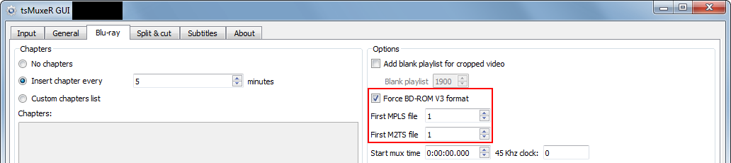

    3. Multiplex your UHD files with tsMuxeR. Remember to put the streams in the correct order. MultiAVCHD sometimes messes up the subtitle order if you add external subtitles, so double check. The file number can be set in the “Blu-Ray” tab. Default is to create 00000.m2ts. Change the number accordingly. “Force BD-ROM V3 format” should be set automatically on HEVC videos.
    Note: tsMuxeR uses different settings for subtitles. The default settings result in small subs. You likely want to adapt this. MultiAVCHD uses: Trebuchet MS, size 45, bold, 2 pixels border and 45 pixels offset from the bottom. I suggest increasing the font size even more for UHD.
    [Attachment 70331 - Click to enlarge]

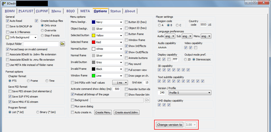

    5. Open BDEdit and load the MultiAVCHD Blu-Ray folder. Go to options and convert to version 3.00.
    [Attachment 70332 - Click to enlarge]

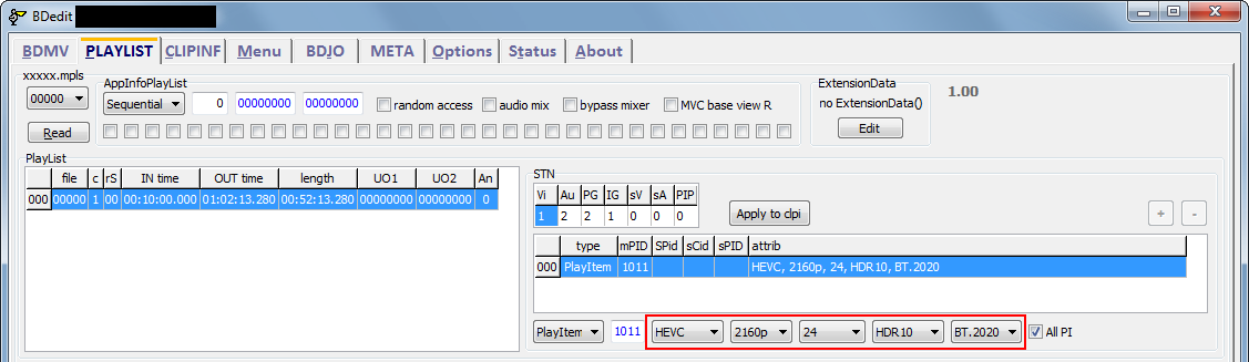

    6. For each replaced stream open the playlist and set the video parameters so that they match the actual file. Use MediaInfo to get the details.
    [Attachment 70333 - Click to enlarge]
    [Attachment 70334 - Click to enlarge]

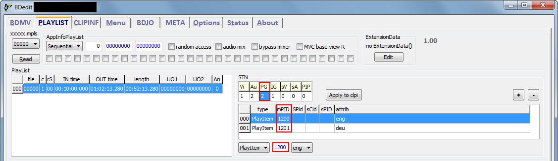

    7. Check the PIDs for audio and subtitles. I had to adjust the subtitle PIDs from 120x to 12Ax. Also use MediaInfo here to check the PIDs.
    [Attachment 70335 - Click to enlarge]

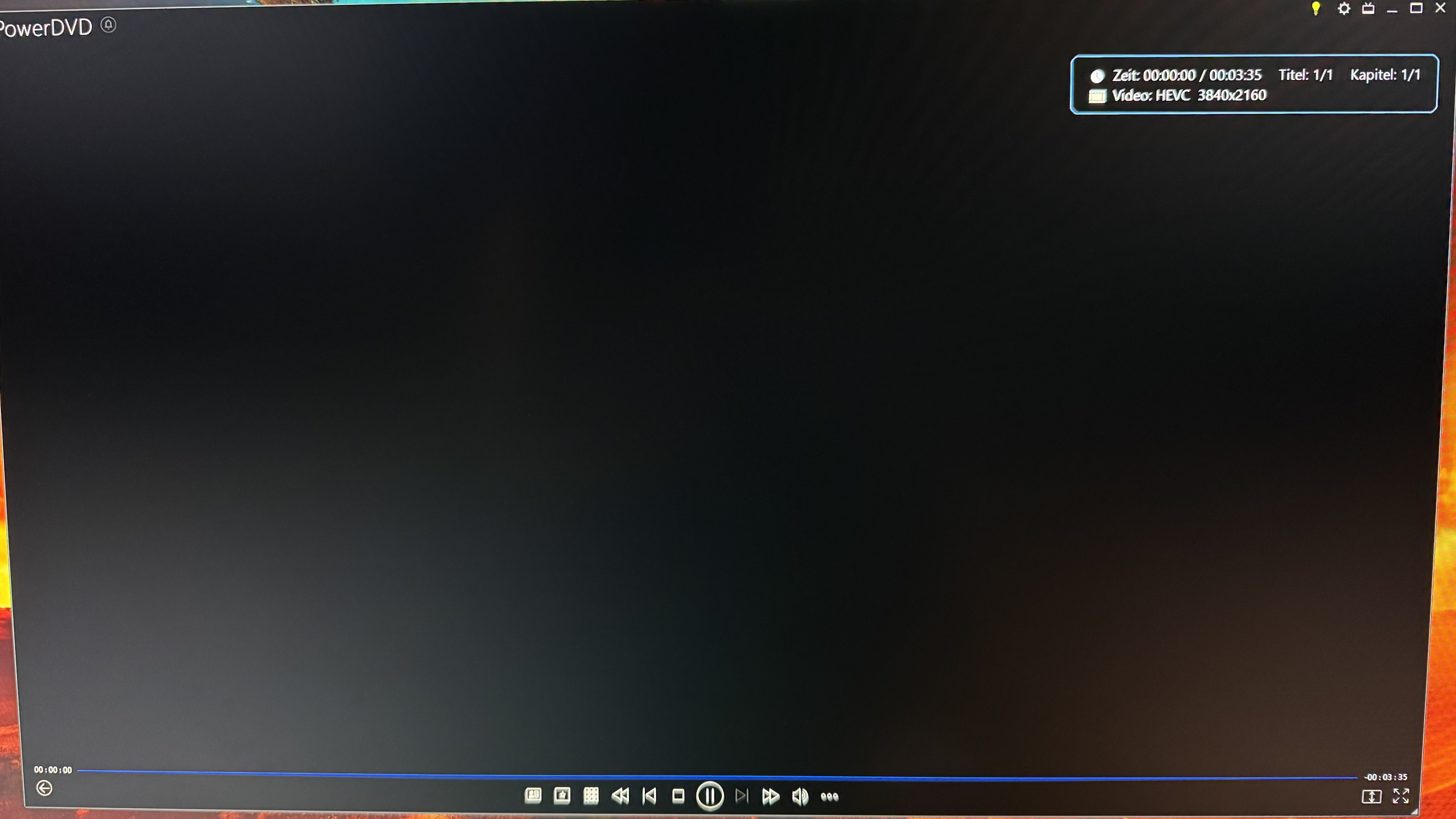

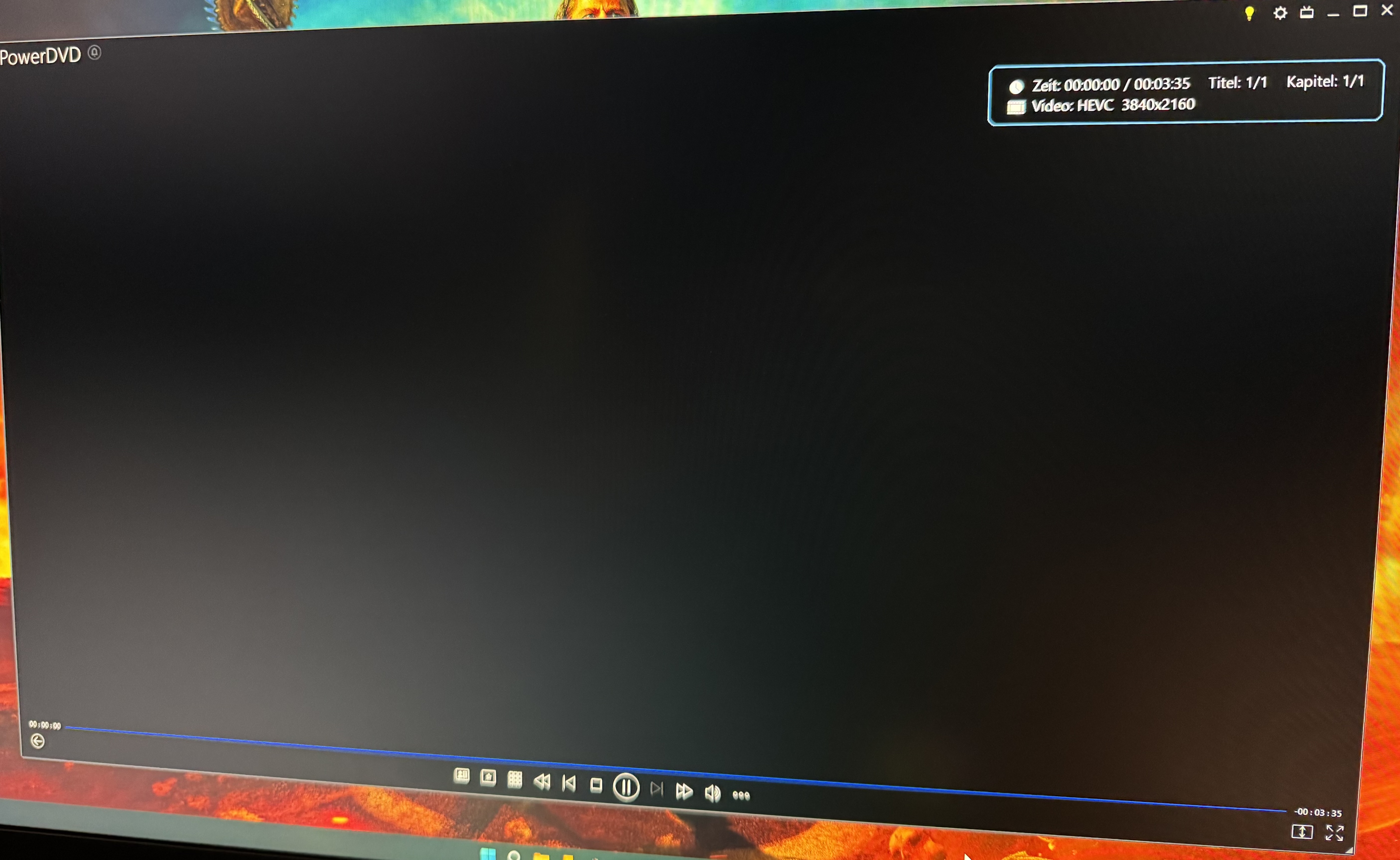

  3. Hello, it would be very kind if someone could give me a little tip. I did everything according to the instructions. Now when I start my Blu-ray with Power DVD, which I have with Multi AVC HD Author. And click on the changed 4k arrow, it shows me the correct resolution and the correct playing time of my little clip in the info at the top right. But it doesn't start. It just stands there. Do you have a little tip for this? That would be really nice.
