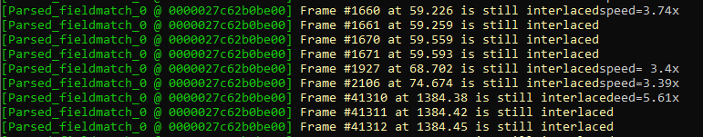

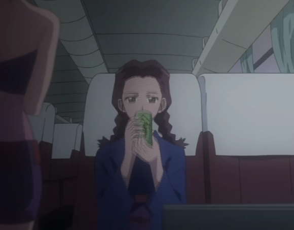

    But the result ends with these lines:
    I was told i have to deinterlace it, so i added -vf yadif=1 to the argument, but the result were blurry lines and low quality. Like, the video is watchable and those lines disappear, but the drawings are sightly more blurry compared to the sharp drawings of the originals.

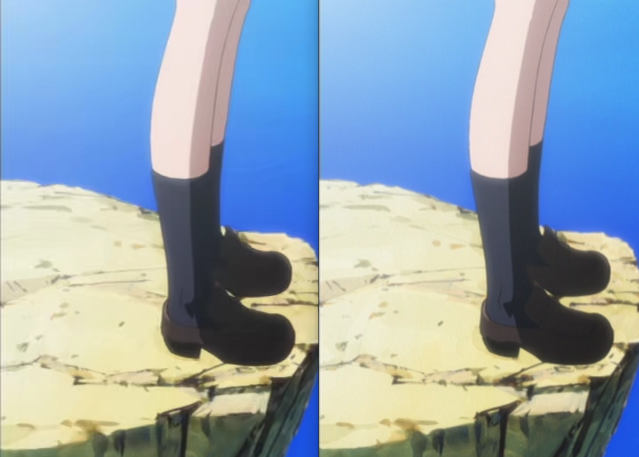

    See:
    Right is original, left encode.
    Notice how you can clearly see the line between the shoe and the black socks on the right, but on the left is so blurry it's not visible!
    It's just not as sharp.
    I tried a much lower crf but the result never looked as detailed/sharp as the original, so -vf yadif=1 is somehow ruining the quality of the outputs.

  2. Usually anime will be progressive content, just telecined for DVD
    You would need to inverse telecine to recover the original progressive film frames. Deinterlacing with yadif just reduces resolution in 1/2 because it's interpolating from 1 field, that's why it looks blurry . Field matching combines both partner fields, for full resolution
    For NTSC DVD (assuming that's what it is), sometimes ffmpeg can mess up reading the timecodes, so you should set the FPS . Yadif is only used for combed frames after the field matching, such as orphaned fields
    -vf "fps=30000/1001,fieldmatch,yadif=deint=interlaced,decimate"

    This improved somewhat, but there are still some differences.
    Original on the right.
    Your vf on the left.
    This works, the quality improved, but there are still liiiitle differences in the bone line being longer on the right and shoe definition being more noticeable. How can i make these settings stronger, so i get a better result that is almost 100% like the original?
    I think that if make these settings stronger it will completely work.

    Also, in both method i got this too:
  5. I think the filter sequence I used only works for 100 percent hard telecined video. For a mix of hard/soft telecine you'll need to specify the fps parameter. In fact, it wouldn't hurt to always specify the fps parameter for NTSC DVD sources.
    As for the "still interlaced" frames, PDR's addition of the yadif filter may take care of any frames still interlaced after fieldmatch (generally from orphaned fields or field blending).

  6. In your last screenshot, the loss in shoe definition in the shadow area looks more like lossy encoding problem, not a filtering problem such as deinterlacing vs. field matching.
    Use better encoding settings and/or higher bitrate , lower crf
  7. Yes, he should try a lossless setting (crf=0) and compare that result to the source to be sure where the losses are coming from.
  8. Note for libx265, crf=0 is not lossless. You need to enable lossless encoding with the lossless switch
     -x265-params lossless=1
