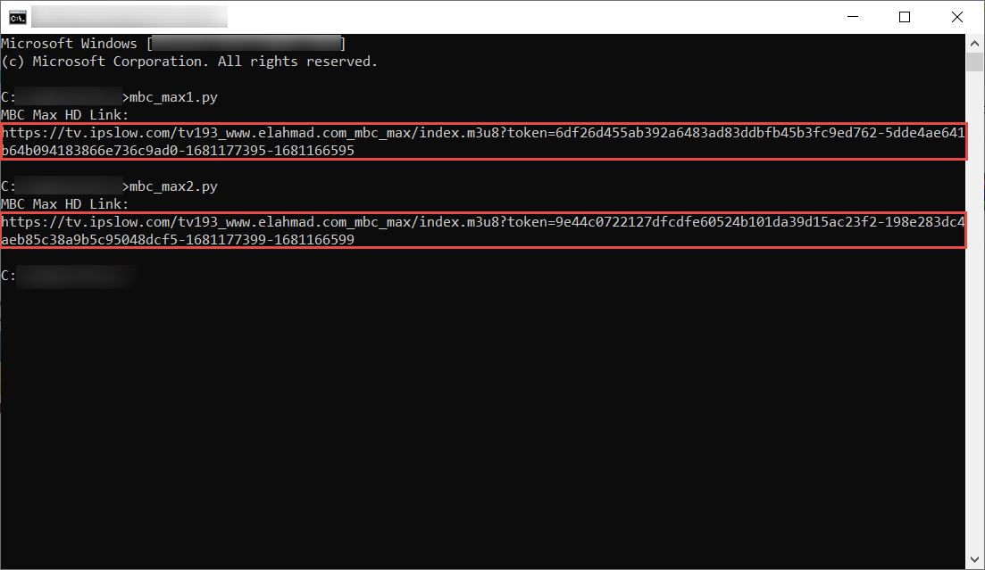

    [Attachment 70305 - Click to enlarge]

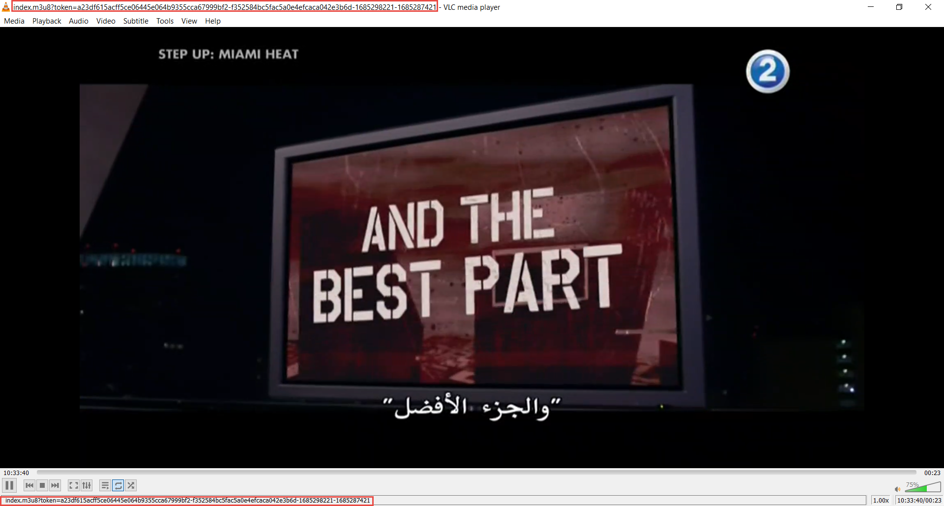

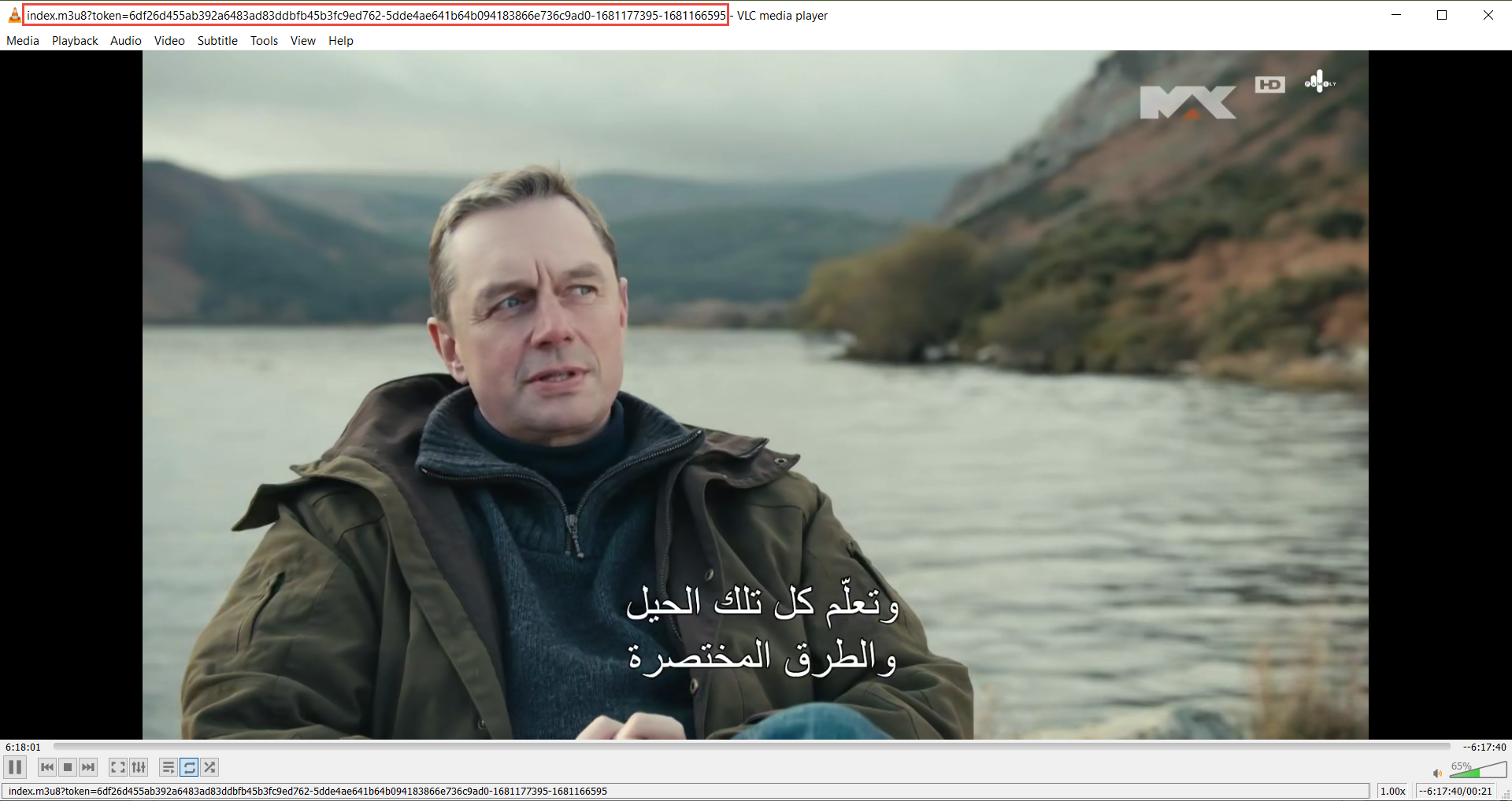

    as you can see links obtained in both .
    Finally running the links using VLC:
    [Attachment 70306 - Click to enlarge]

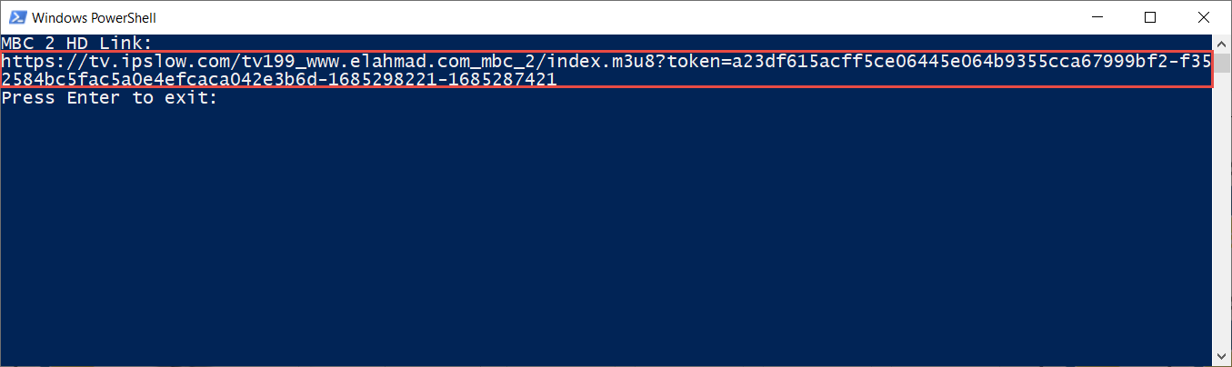

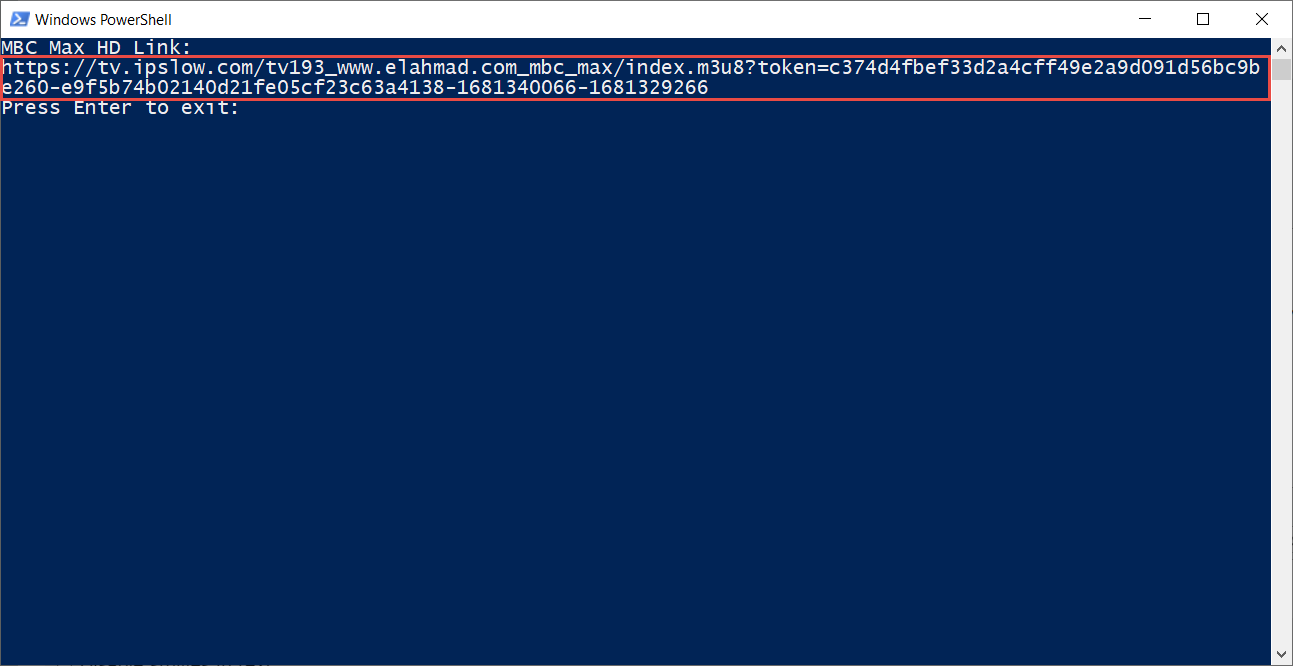

    "MBC Max HD Link:"
    $link
    Read-Host -Prompt "Press Enter to exit"
    [Attachment 70330 - Click to enlarge]

    - Testing:
    [Attachment 71297 - Click to enlarge]
    [Attachment 71298 - Click to enlarge]
    Good Luck !
