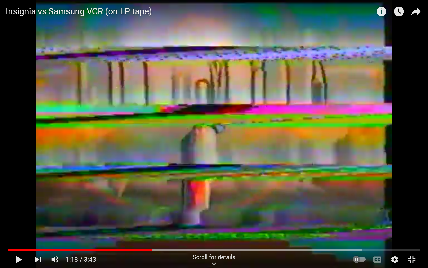

I had a few minutes to search. Go to the 1:13 mark of this video:
https://www.youtube.com/watch?v=Y6hZyZhbs74
He plays the same tape on several VCRs and it plays just fine (if you watch the video from the beginning, you'll see that the tape plays fine). However, when he puts it into a VCR that doesn't support LP, he got this very familiar (to the OP) image:
The noise bars on this are a little stronger than in the OP's video, but the spacing between the bars is very similar. -

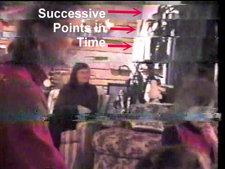

On the longer sample it is interesting to note that when the camera moves sideways there is an artifact very similar to a rolling shutter artifact where objects bend and wave back and forth. I don't know what to conclude from this and only offer it as an observation from which others may come up with a better idea of what is causing the problems.
[edit]Further observation: at the 5 second mark, it takes 3-4 frames to go from one scene to the next.
One conclusion: each horizontal band is coming from a different point in time. People may not like my LP idea, and maybe it's not correct, but as the head is spinning as the tape goes by, it is picking up video from different points in time.
It would be interesting to see what sort of effect you get if you have a VCR that can play these tapes in high quality slightly slow or fast motion. My JVC decks can do something like this.Last edited by johnmeyer; 8th Apr 2023 at 17:23.
This image shows what I mean. As the camera pans left, note how each band shows the edge of the wall and the window in different locations. At the top is the earliest point in time, with each succeeding horizontal band coming from a later moment.
