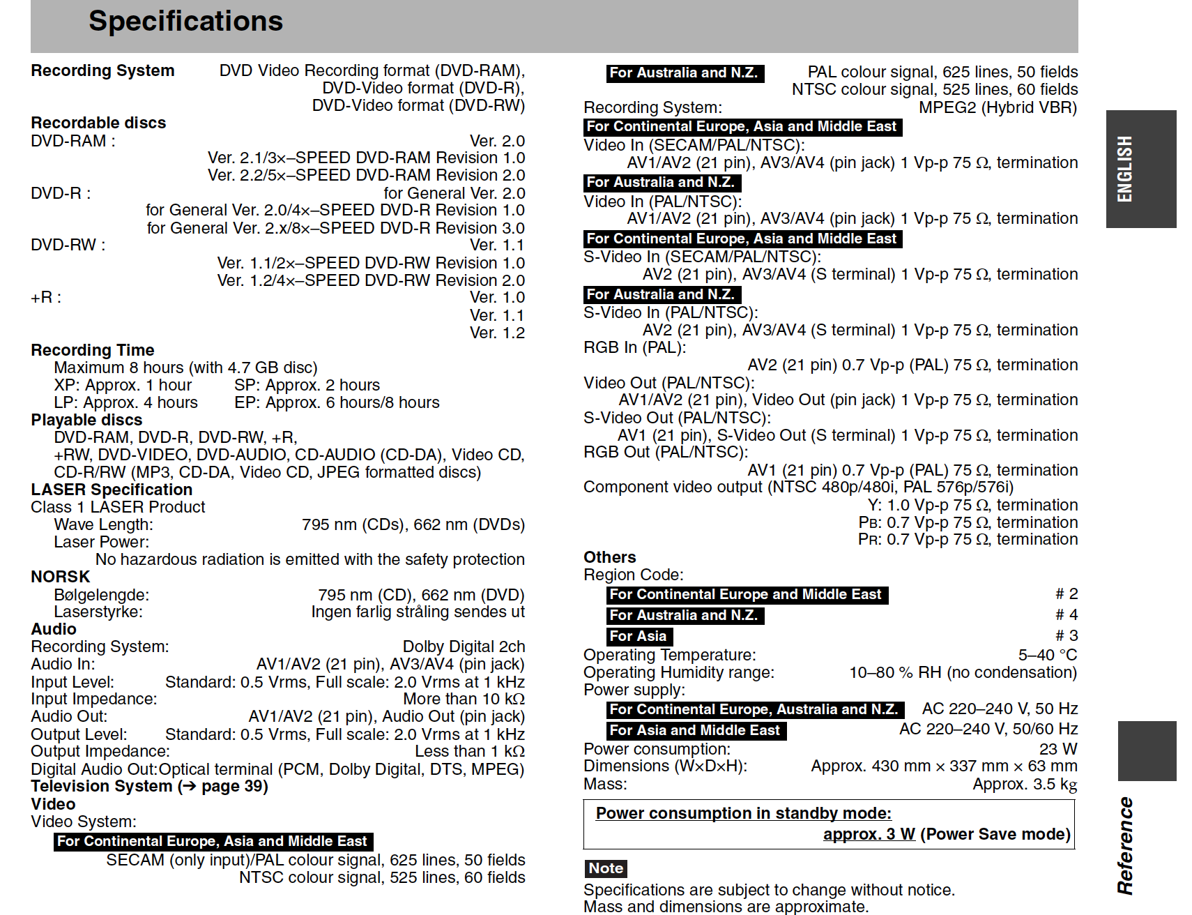

    Operating instructions for Panasonic DMR-ES10 DVD recorders that includes information for both a SCART version of the recorder and a US version of the recorder: https://panasonic.ca/viewing/all/dmr-es10/oi/rqt8020-1l/rqt8020-1l.pdf
    When playing an NTSC DVD, the version of the DMR-ES10 recorder with SCART can output a PAL 60 analog signal which has the same number of lines as NTSC (525) and a 60Hz refresh rate like NTSC but with the PAL color subcarrier at 4.43mhz, which NTSC doesn't provide. However, that doesn't mean that they could accept a PAL 60 analog signal or NTSC analog signal as input.
    The UK version of the Panasonic DMR ES10 DVD recorder (with SCART) is almost certainly designed to only accept PAL analog signals as input and then output PAL analog signals because the analog sources they were intended to record from all used the PAL standard. UK analog TV broadcasts used the PAL standard, UK video cameras used the PAL standard, and UK VCRs output video that used the PAL standard when playing homemade tapes recorded from UK TV.

  10. Originally Posted by usually_quiet View Post
    That's not correct, it (and other european model panasonic dvd-recorders from that year and on) can handle standard NTSC. They can be switched between PAL/SECAM (625-line) and NTSC (525-line) in the menus.
    As noted in the other thread, you preferably want to use s-video via the scart output, or the component output to avoid a brightness flashing issue.

  12. Video Restorer lordsmurf's Avatar
    I have the PAL ES10, and it can swap modes to NTSC. It works fine via s-video in/out. (But I bought it for PAL needs, don't use it for NTSC. Already have NTSC version, bought on release day in 05/06, whenever it was.)
    ES10 works great for anti-tearing needs, when net result is better outcome that other hardware/methods. Noting that it's not a TBC, not a TBC replacement. But it can be useful in the right situations.

  18. Member
    Aug 2006
    I missed that section, on P. 39 in the manual.
    TV SYSTEM
    Change this setting if you connect an NTSC television or to record NTSC video from another source.
    1 While stopped Press [FUNCTIONS].
    2 Press [e, r] to select “To Others” and press [ENTER].
    3 Press [e, r] to select “SETUP” and press [ENTER].
    4 Press [e, r] to select “Connection” and press [q].
    5 Press [e, r] to select “TV System” and press [ENTER].
    6 Press [e, r] to select the TV system and press [ENTER].
    •PAL (factory preset)
    – Select when connecting to a PAL or Multi-system television. Programmes recorded using NTSC are played as PAL 60.
    – Select to record television programmes and PAL input from other equipment.
    • NTSC
    – Select when connecting to a NTSC television. Television programmes cannot be recorded properly.
    – Select to record NTSC input from other equipment. The confirmation screen appears.
    The only source that it can't record from is the analog tuner since it isn't an NTSC tuner.

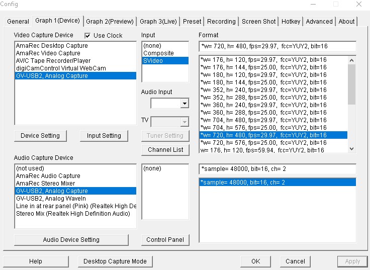

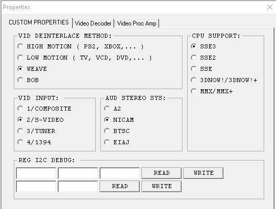

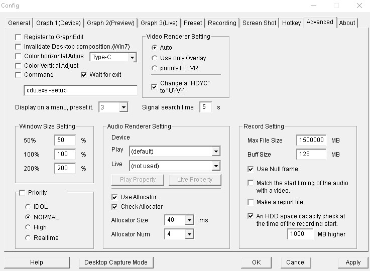

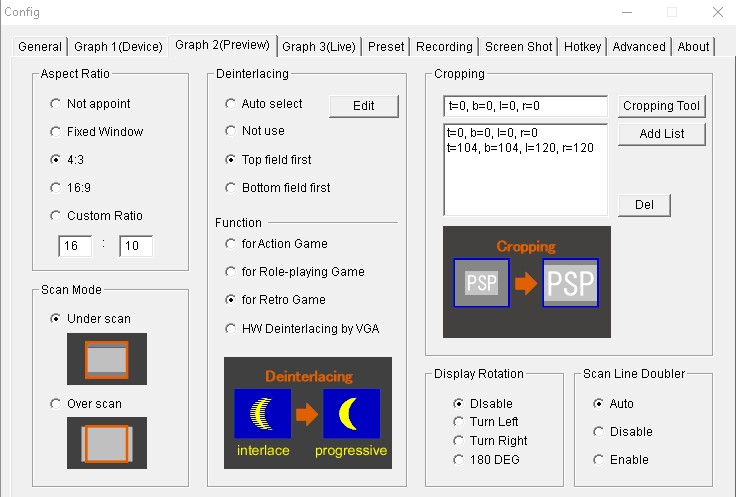

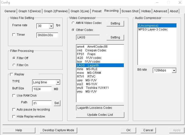

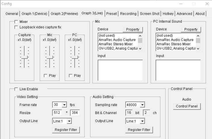

  23. Hi lollo,
    I did quite a bit of looking around on DigitalFAQ and this website for feedback on which device to purchase. It came down to the one I bought, the Hauppauge Live 2 (such as shown on your ytube channel) or perhaps a Pinnacle USB 510 / 710 USB. At the end of the day it was still a bit of a toss-up and although none seem perfect it seemed like GV-USB2 might be worth a try if I could get my hands on an authentic one and none cheap Chinese copy as it could do uncompressed AVI. I checked out some of the vids. on your channel and many of your posts along w/lordsmurf and many others which was quite helpful. Nice to see the results you get w/ your S9500U and Live 2USB.
    The tests with the GV-USB2 thus far have been thru both programs you mention, AmarecTV / Vdub 1.9...... on Win10 w/S9500 set with TBC (ON), S-Vid connection to I-O capture device, R3, Vid stabilizer (off). 720 X 480 avi w/ Lagarith capture on device. Am not upscaling or applying any filters at this point. Trying to get my head around the best basic capture at the moment.
    Currently I am experimenting with and trying to decide whether to leave the Video calibration on or off for best results. I guess it depends on the tape in some cases. There is also a "Tape Dub" setting, i.e. perhaps the mysterious "EDIT" setting mentioned previously by other posters also being on our deck but which I can not find anywhere in the function setup menu. I am making an assumption that the Tape Dub setting is what is meant. Any thoughts on whether this should be left off or should I turn it on? I believe one of the other users, Oln says to turn this on as it might turn off some unwanted processing. I'll do some tests on this.
    If I'm lucky enough to get my hands on a decent one, any ES-10 will only be used for those problematic tapes in the future as you say. Have also been checking out older Datavideo SE-800s for an external TBC should the line TBC of the S9500 not play well with some tapes. Not sure about it's TBC though as it is an older unit (not sure how good the TBCs were back then) with features I don't feel I would ever use so am still to do some research on that. Would be nice if the TBC-1000s and certain Big Voodoos were still available new or more plentiful used in good condition at reasonable price today!
    The I-O GV VHS caps I've made thus far do not seem to play back (look) too well w/VLC. This is could be an issue w/ some of my settings in VLC, age / condition of VHS recording I'm capturing and use of an LCD monitor. I am going thru the VLC settings and setting them to default. They look fine played back in Vdub and Win Media Player. Vdub seems to capture with the I-O GV fine. I had to connect the ADVC 110 to the computer via it's firewire to get the capture device recognized in Windows for capture in Amarec and Vdub though. I found that odd. Was having a heck of a time and felt like pulling out some hair.
    Anyway, also have an early 90's Sony 20inch Trinitron which I'll be hooking up and using for future monitoring and cap eval.. It's in great shape but so far only playing back the caps on LCD / LED computer monitors which doesn't look too pretty.... at least for the older VHS caps..
    I have a few screen grabs of my AmarecTV settings. Could I get your feedback on them. I think they are correct but not sure. Won't be doing any live streaming, just VHS (S9500U), Hi8 and 8mm caps (Sony DCR-TRV530 enroute) . Thanks again. SD

  25. Captures & Restoration lollo's Avatar
    Jul 2018
    Italy
    Still i think it's valid, not everyone, who is starting/trying to capture has all the knowledge needed, hence (still) the need for forums like these here, and ohters
    I am not saying that no help is needed, that's why this forum exists. I meant that the "computer" route is not that difficult once you have the right workflow, as it is the case here. And will provide much better results than the (supposed) easier way.
    I did quite a bit of looking around ...
    Thanks for sharing your experience with many details!
    mysterious "EDIT" setting ...
    In general I prefer the "edit"=off setting, together with "d3r"=on (this processing is what makes the image of the high end JVC S-VHS nice). But there is some higher ghosting at scene change, because the chroma noise reduction. On top of that, it also dependes on the tape, and finally I often use also the mode "edit"=on and "d3r"=off.
    Some discussion here:
    https://forum.videohelp.com/threads/399048-JVC-HR-S9600-comparisons#post2597201
    https://forum.videohelp.com/threads/401232-JVC-S-VHS-settings-for-capture-%28again%29
    Some comparison here: https://www.youtube.com/watch?v=X1jpyNRGNGY&list=PLCvrZEXO1laHx3S8NbicMC7e3mAr6svPh&pp=gAQB
    Could I get your feedback on them. Any thoughts on whether this should be left off or should I turn it on?
    They are ok. I use "999" as frame rate to force AmarecTV to capture at the framerate of the card, rather than at its setting. And do not deinterlace in preview window, to do not add extra activity while capturing.
    A guide to AmarecTV settings here: https://www.digitalfaq.com/forum/video-capture/12986-amarectv-virtualdub-inserts.html

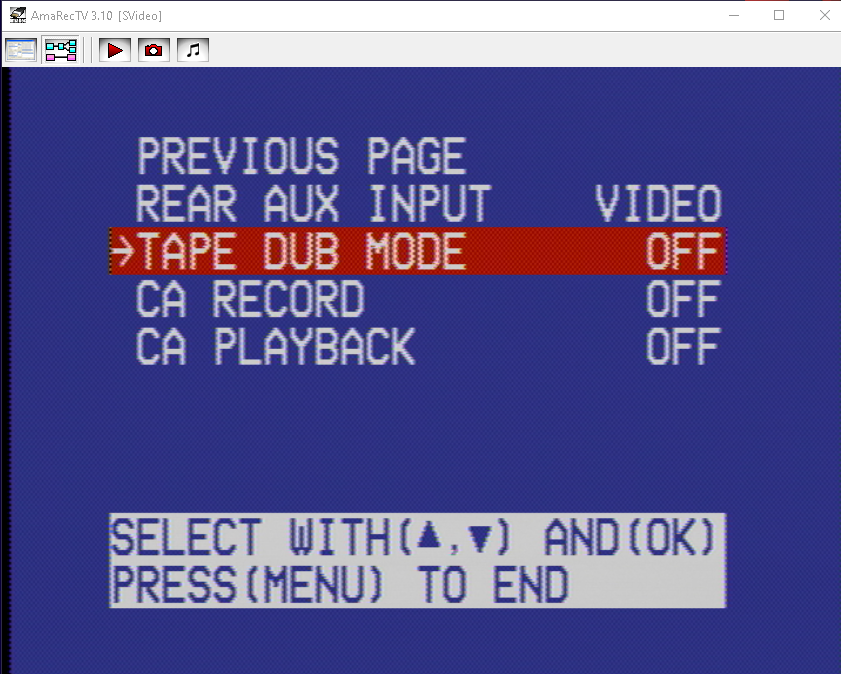

  26. Thanks for clarifying any confusion as well as for your feedback and the links, lollo
    I will alter the framerate back to 999, turn off deinterlacing in preview and keep experimenting. At some point I'll check back in w/ some observations and perhaps clips or some such.
    I am hoping to learn how to apply AviSynth and QTMG (sp?) to my caps as soon as I can. Looks a bit more complicated and am not quite there yet.
    Anyway, and sorry for this redundancy, I still wonder whether that "EDIT" feature that you mention having on your S9500 is the same as the "TAPE DUB MODE" setting option under the N. American S9500 Main Menu - Function Set? , SD
    [Attachment 70241 - Click to enlarge]
  27. The "Tape Dub" setting issue has been answered. Dug up and read the old manual.
    Turned on it does turn off the Active Calibration. By appearance it also seems to be turning off some other filtering that's going on behind the scenes but that is not stated in the manual as I read it. There is a noticeable increase in noise in the video playback when on.
    I have no doubt that this has already been noticed or known about by others on the board and posted about on the forum.
