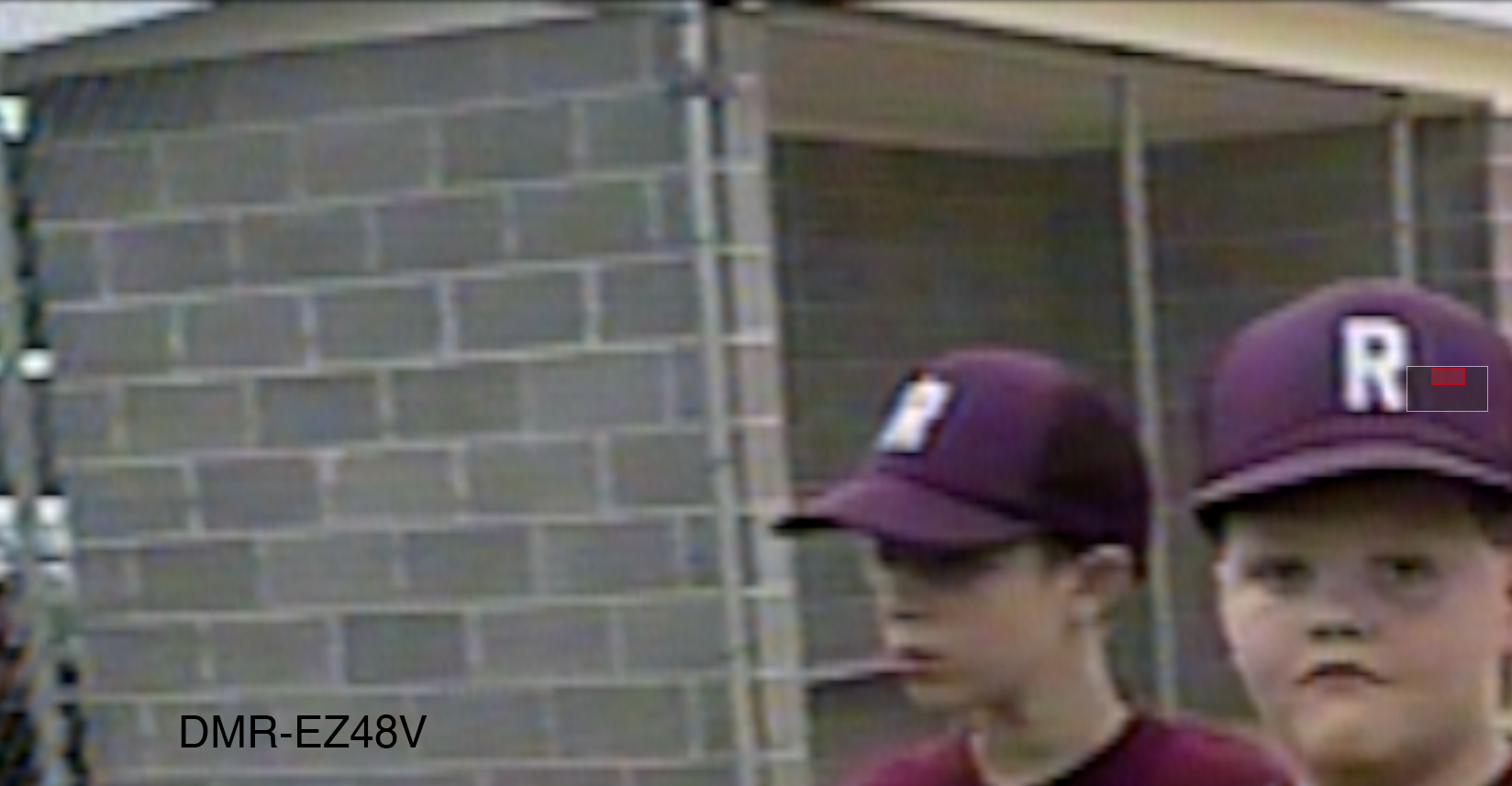

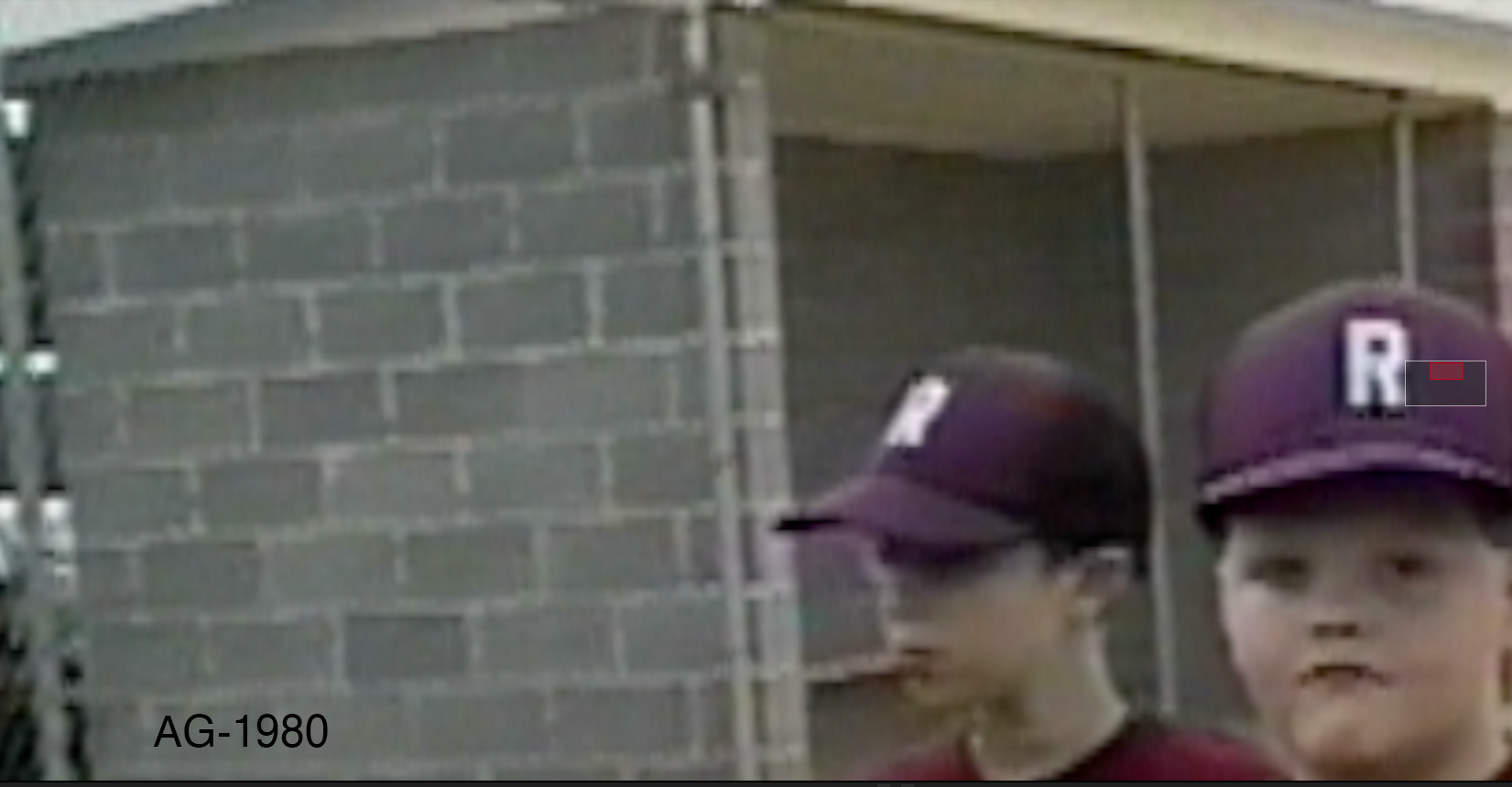

  1. I've been trying to transfer some rare family footage and I've been doing a comparison between my newly refurbished Panasonic AG-1980 and a Panasonic DMR-EZ48V.
    It seems that the AG-1980 footage has artifacts everywhere (take a look at the kid's mouth on the far right). Is there any reason for this? I'm using the built in TBC and also running it through my DataVideo TBC-1000 Full Frame 4:2:2. Any idea why this is happening?

    Apologies, I mean to say that the source, to my knowledge, is interlaced. I feed my AG-1980 / TBC combo into a Panasonic DVD/VHS with HDMI out and output 480i on the machine and capture in 525i using Blackmagic Media Express and a Blackmagic UltraStudio Mini Recorder.

  9. I feed my AG-1980 / TBC combo into a Panasonic DVD/VHS with HDMI out and output 480i on the machine and capture in 525i using Blackmagic Media Express and a Blackmagic UltraStudio Mini Recorder. Encoded in ProRes 444, sample images are from Final Cut Pro.

    525i is the only NTSC capture option in Blackmagic Media Express. Am I missing something?

    AG-1980 picture looks far better than the other VCR, but both got butchered by whatever workflow you're using.
    Far better? Based on what? I have the opposite impression looking to the provided pictures
    Originally Posted by s-mp View Post
    Imo it removes lots of details
    I agree. Picture from ES48V is better and more adequate for further restoration: https://imgsli.com/MTY4MTM0
    But we are just judging a fixed screenshot, so no real conclusions are possible.
  17. Capturing Memories dellsam34's Avatar
    Jan 2016
    AG-1980 is better in terms of less chroma artifacts. Resolution, interlacing and loss of details is caused by his workflow, Unless he posts lossless unaltered samples it's hard to judges other than the obvious chroma artifacts that the ES48V has.
