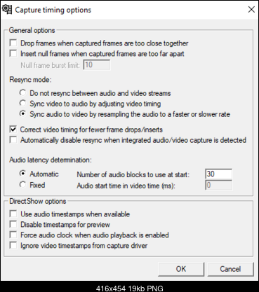

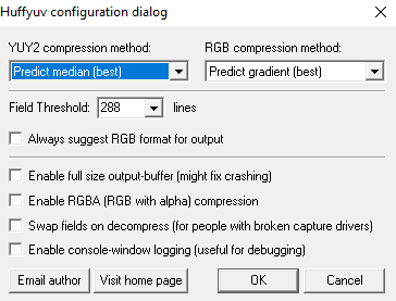

    Here are my vdub settings:

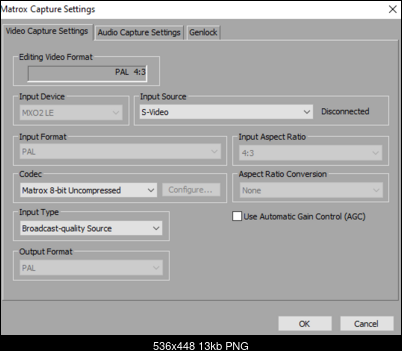

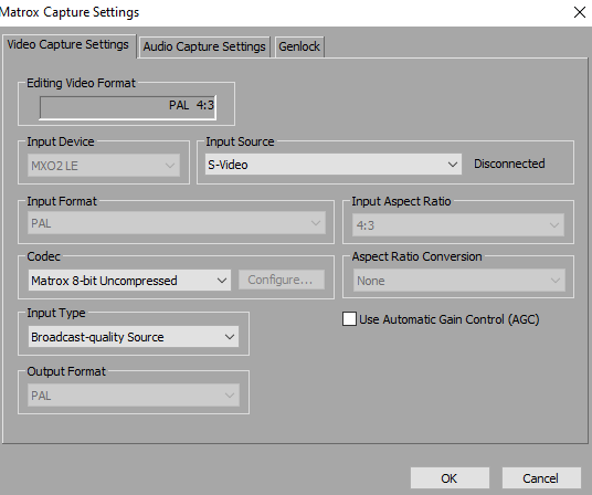

    And my Matrox settings:
