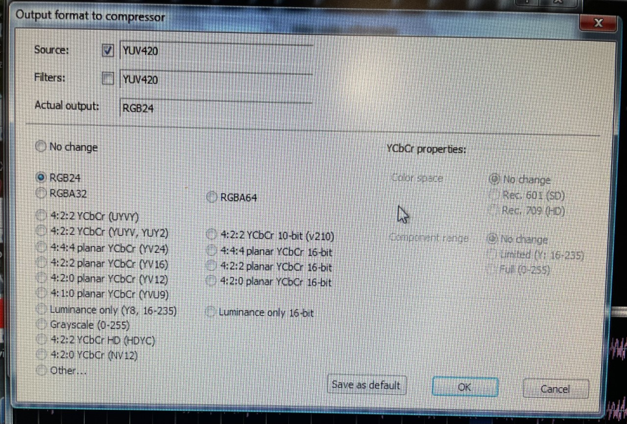

    Here's another little nugget. Maybe this is the source of my issue?
    When I selected HuffyUV compression, it wants to convert to RBG24.
    Which selection do I want in this configuration window?
  16. You want to capture as YUYV or YUY2. Then compress with huffyuv in 4:2:2 YCbCr (YUYV, YUY2) mode.
    With your current setup you are capturing as YV12 (YUV 4:2:0), converting to RGB, huffyuv is then converting the RGB to YUY2, and finally compressing it. So you have two useless lossy conversion between the capture device and the output file. That's a waste of CPU time and a possible cause of dropped frames. But not likely the cause of your QTGMC() problem -- which is most likely a version issue of all the filters used by QTGMC.
