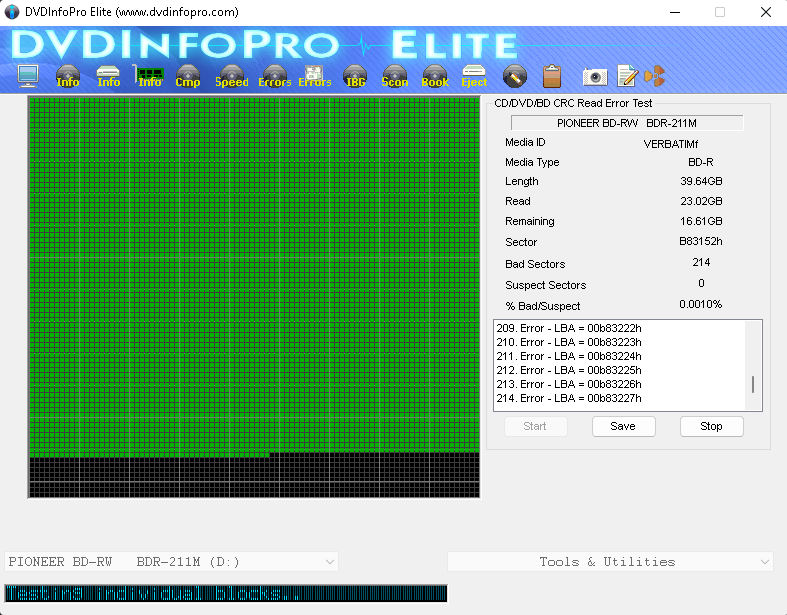

    When I run DVDInfoPro's CRC Error Read Test, it often gets stuck somewhere in the middle of the disc and outputs a long list of LBA errors. I uploaded a 175k .jpg screenshot, but it's not displaying when I Preview this post, so I don't know if it'll appear here?

Name:	lba errors.jpg

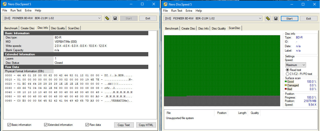

  10. I performed a CRC Read Error test on another disc late last night & it also stalled with a load of LBA errors, but it stalled about 20% into the disc.
    I just tested that same disc again, but via the Pioneer burner with similar results, but the LBA errors began at a much later point in the test. This illustrates the seemingly random nature of the freezes. As I mentioned, most of the time, the freezes occur around 1 hour & 20 minutes-ish into play. But I've had the same disc that froze at 1'20" later freeze at 30 minutes or 1'53".

Name:	lba errors - Pioneer.jpg

    Nero DiscSpeed 5 result with standard Blu-Ray BD-R disc that freezes
    [Attachment 84896 - Click to enlarge]
    [Attachment 84897 - Click to enlarge]
