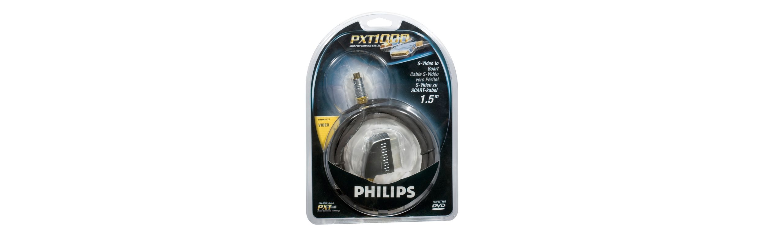

 EX95 to ES15 via SCART to VTR820E via SCART/svideo adapter. Someone said something about have to use SCART because going back between black and white does something. I am sure you guys know what I mean...

	SCART can be composite, s-video, or RGB. With VHS decks I believe it's usually composite.

 SVideo is better. Composite is the lowest common denominator.
 I do not have experience with SCART. AFAIK, depending on model you can choose whether you want to sent composite or SVideo or RGB through it using either hardware switches or menu settings.
	Exactly. Not all devices handle all three. Composite (the lowest quality) is usually the default. Hardly any consumer devices support SCART RGB (the highest quality). And no device can output (or input) composite and s-video at the same time because Composite and s-video's luma share the same pin.
	[QUOTE=jagabo;2688115] Consumer VCRs that is. (well stuff not aimed at consumer use would more often use BNC cables for both composite and RGB.) The only ones that output RGB from the VCR side are some of the vcr/dvd combos with recording (like the DMR-EX95V mentioned here.) and maybe one or two other rare models. There wasn't much point in putting a composite->RGB decoder inside vcrs as that was present in every TV anyhow. (Though external S-Video -> RGB dongles for better quality from SVHS decks to TVs that lacked S-Video was a thing)
 Other stuff like cable boxes, game consoles, dvd players and similar used RGB frequently. THe panasonic dvd-recorders will output RGB as well, though I'm not sure if they can record from it. Most things with SCART RGB output will typically output both RGB + composite by default + a signal that says there is rgb output which let the receiving device chose the preferred/supported signal. For S-Video or component over scart both devices has to be set to it manually since those are a bit of a "hack" and reuse the rgb and composite pins.

 Copy that.SVideo is better. Composite is the lowest common denominator.
 OMG! It all makes sense now! This whole time I was wondering why I could change the video output on AV1 (and such), but never understood what it really does! I thought it was like changing the input on a TV, but this was output, and that made no sense. Now it does! I can pick what signal "type" I want to go through the SCART cable! Wow.I do not have experience with SCART. AFAIK, depending on model you can choose whether you want to sent composite or SVideo or RGB through it using either hardware switches or menu settings.
 Thank for that!
	For the VCR just use the s-video output with a s-video cable to whatever device you have next in the chain. Scart won't have any advantage over it. Using scart can give the same result if both VCR and other device is set to use S-Video but unless you lack a S-Video cable it's easier to just use S-Video cables.

	Exactly what I planned on doing, now that I understand what scart really does. Why mess with settings when you can just use a s-video cable. I agree.
