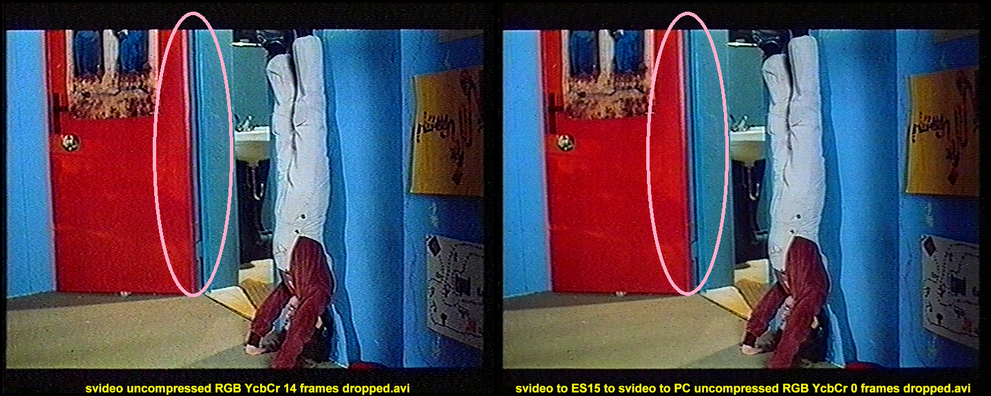

  13. Captures & Restoration lollo's Avatar
    Jul 2018
    Italy
    Originally Posted by plehoediv View Post
    The plan is to go from my VCR (S-VHS but no TBC. I honestly think my tapes do no need TBC)
    Your tapes do need a (line)TBC (the quote is from another thread):
    [Attachment 70297 - Click to enlarge]
  14. Originally Posted by lollo View Post
    Damn! I thought that it would be more obvious, but I guess not! Good work!
