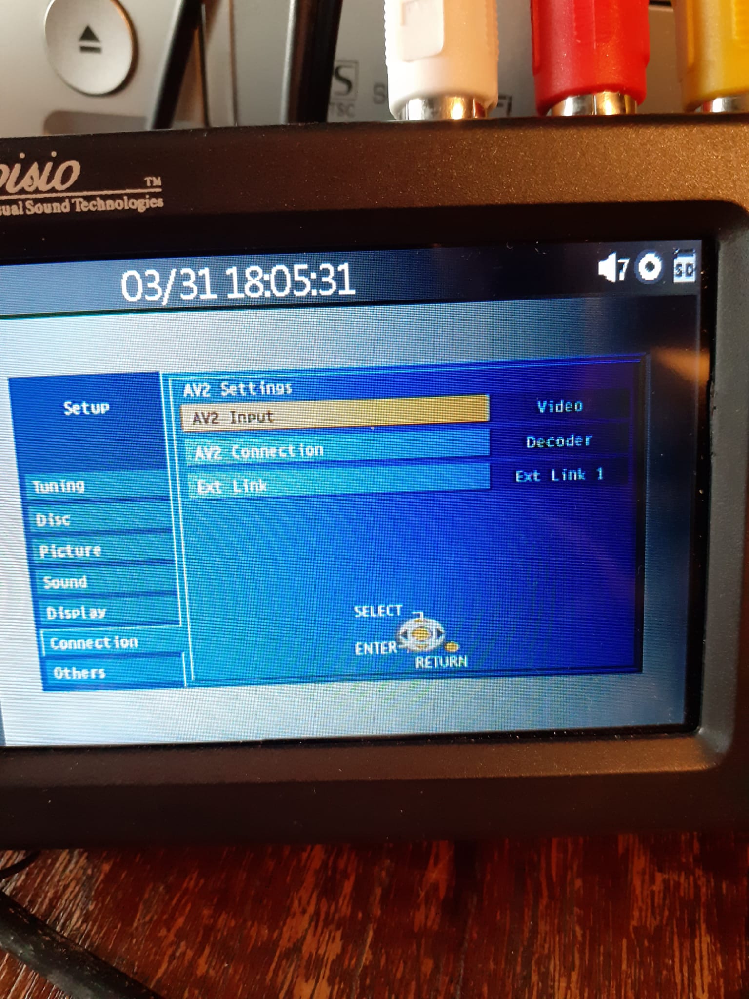

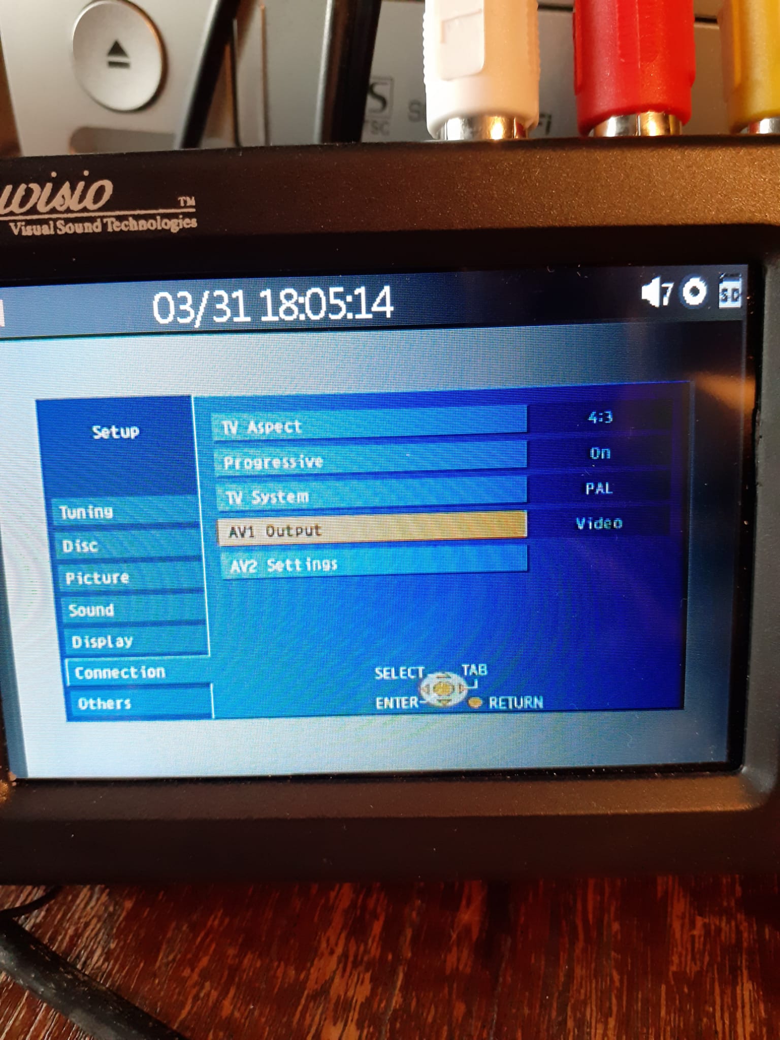

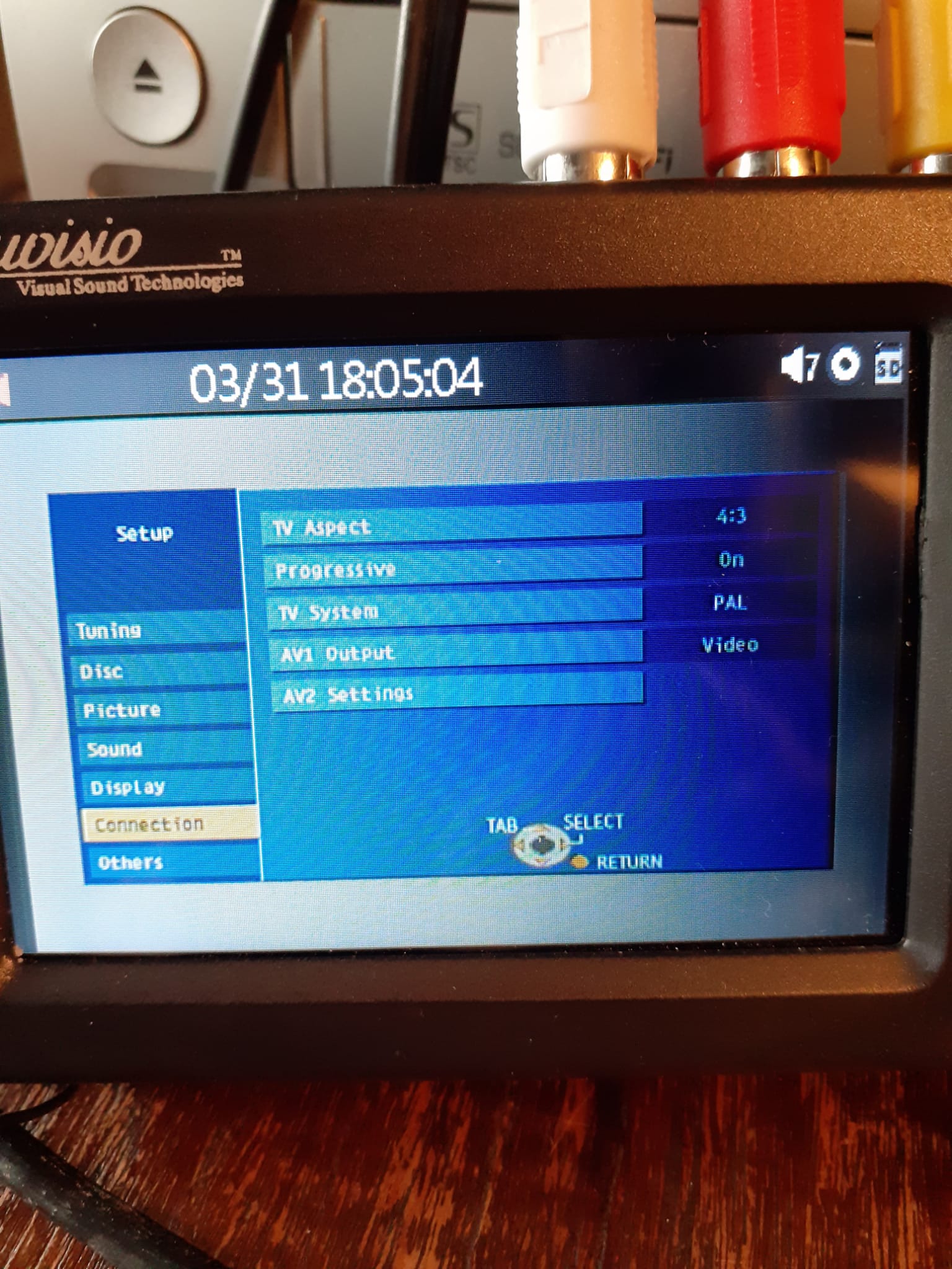

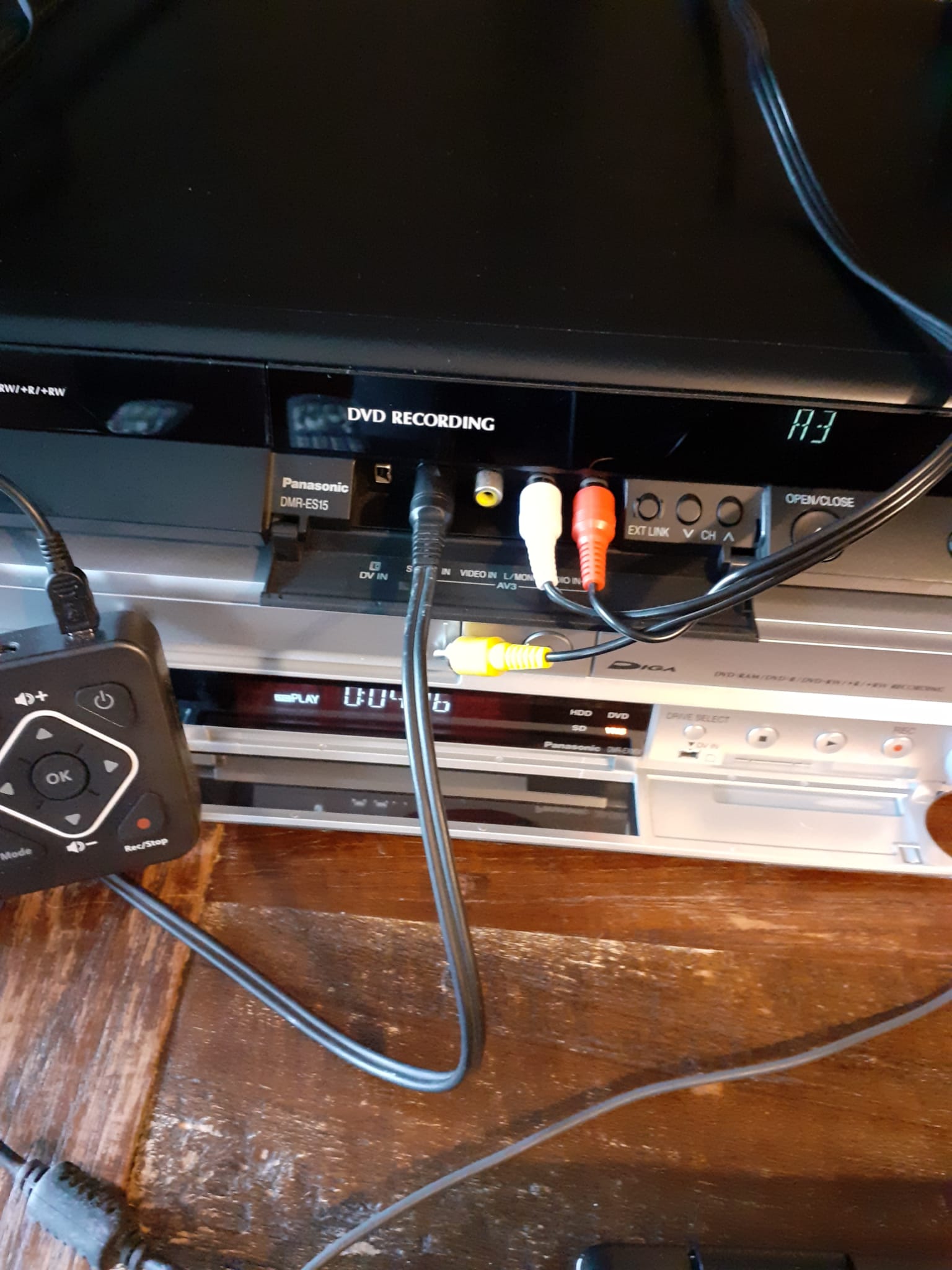

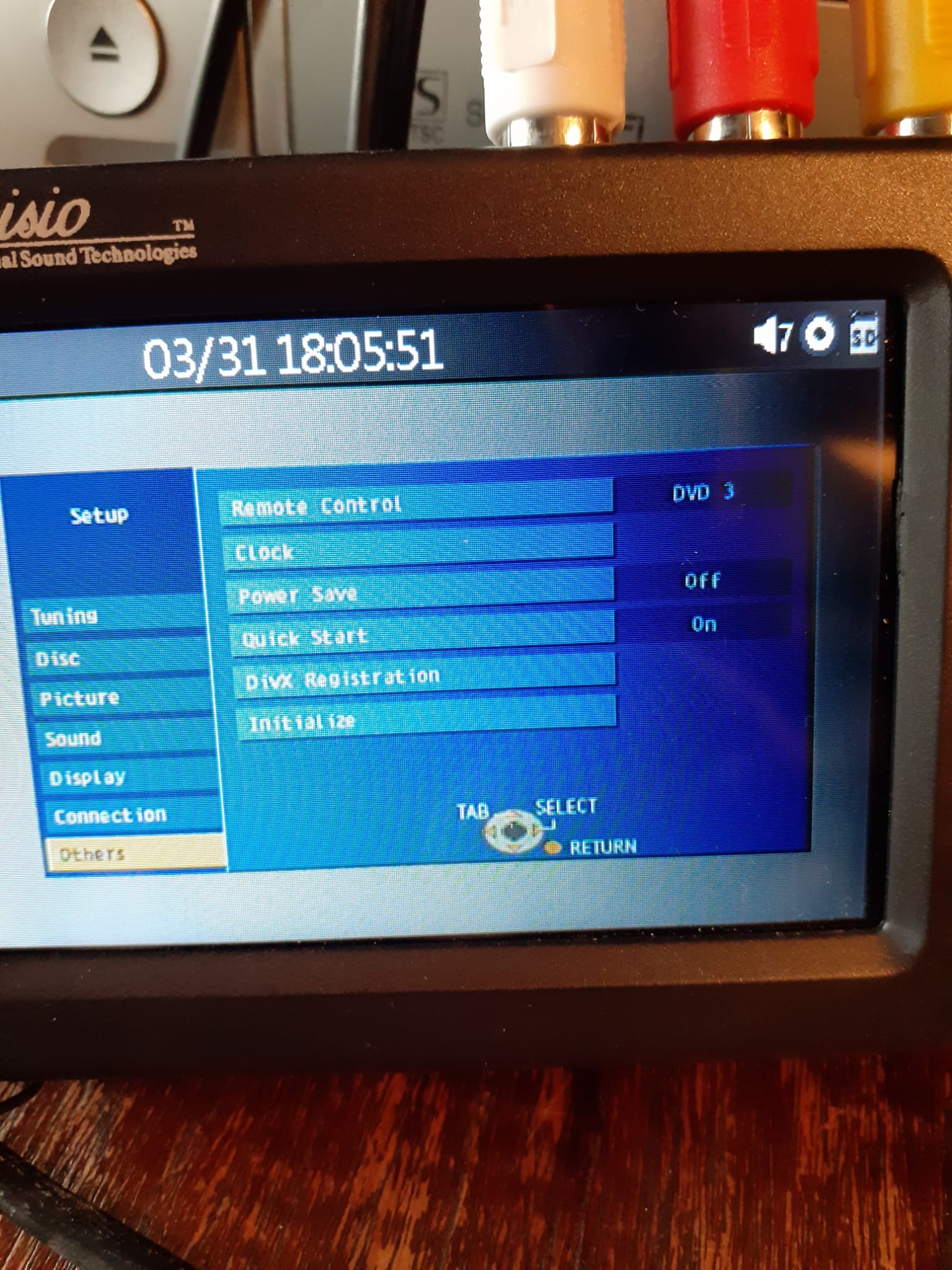

    Here is my setup. Please let me know what I can improve.
    DMR-EX95V VCR connected to ES-15 DVD Recorder via s-video for video, and RCA for audio. From the ES-15 I go to my little "video grabber" box via SCART to RCA adapter. The little grabber records on to a SD card. I used this setup before, without the ES-15. I read that the ES-15 has some sort of TBC, and that helps with the image quality.
    I also attached some pictures showing the settings of the ES-15, but since I have no clue what they mean, it would be really nice if someone can look over them and tell me if I should change something. That includes my cables. I know just using the yellow for video is the worst. I think then comes Red/Blue/Green. But what about s-video and scart?
    Thanks.
