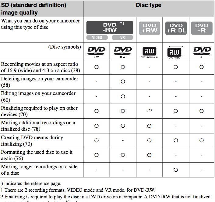

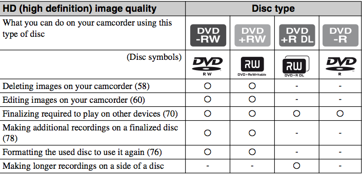

    [Attachment 70080 - Click to enlarge]
    [Attachment 70081 - Click to enlarge]

    DVD-R gets assigned DVD-Video
    DVD-RW gets assigned DVD-Video or DVD-VR, depending*
    DVD+R gets assigned DVD-Video
    DVD+RW gets assigned DVD+VR? or maybe DVD-Video. Note: +VR is not the same as -VR. (+VR is usually only available on Philips cam/re-corders).
    *I don't know the rule Sony uses to determine which of the modes DVD-RW uses, but would expect that the default would be the VR mode (for that disc), as am pretty sure that is the only time that that mode is possible (as it isn't possible with the other disc types).
    Clearly the incident you had was when the DVD-RW disc was not in the -VR mode like you thought it might have been. However, I am pretty sure that "automatically" only occurs AFTER the -RW disc has been formatted...
    From what I read, when you 1st insert the -RW disc, you should be presented with a "Formatting" screen. According to the many Sony manuals I looked at, that screen should have either "Disc Select" options, or the option to 1. Rec. Format, 2. Execute. If you skip "Rec Format" and go straight to "Execute" and answer YES, then it will format the disc in DVD-Video mode. If instead you press "Rec. Format" (and maybe press yes after) it will format the disc in DVD-VR mode. Once that ORIGINAL formatting has occurred, the disc is stuck in that format until you ERASE/REFORMAT the disc (whether in camera or in a computer), after which you should get those original options again. But, while in the format chosen, all Recordings will automatically know which format to record as (Video or VR), which is I think what Sony meant to say. So I think there IS an option to assign the mode, but it sneaks up on you at the beginning and isn't clear.
    Now, I didn't look at EVERY Sony manual, so I could have missed one. You didn't mention the model of your camcorder, that would help. Then, we could look up the manual ourselves to better help you out.
    Hope that helps,

    Thanks, I think I see it now. HD DVD-RW is always recorded in VR mode. SD DVD-RW you have the option to record in VR or Video. Thanks
    I still do not understand why HD DVD-RW can not be recorded in Video Mode?
  6. Member Cornucopia's Avatar
    The Dvd Video formats (DVD-Video, DVD-VR, DVD+VR, etc) are SD only. I expect the HD format actually being used is AVCHD, regardless of type of disc. You should be able to tell for sure by looking at the structure of a (finalized) disc in a pc. It should have the same structure as described in this article: https://en.m.wikipedia.org/wiki/AVCHD.
    Also, or alternately, after you initialize/format a disc you should be able to go in the menu to verify the disc & recording type, etc. I recommend that as a habit, every time, immediately after, so you won't be surprised.
