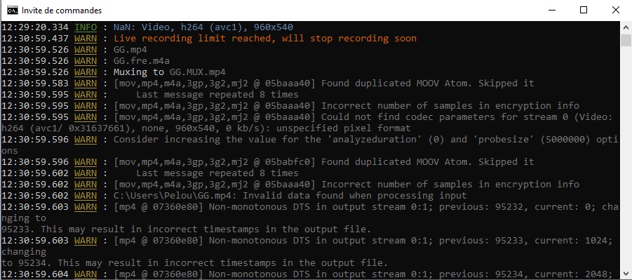

  6. Thanks NBA456017, it works but the problem is that it doesn't want to mux. I tried manually with ffmpeg but the audio track is the problem. I watched the video without sound, and no freeze though.
    [Attachment 70109 - Click to enlarge]

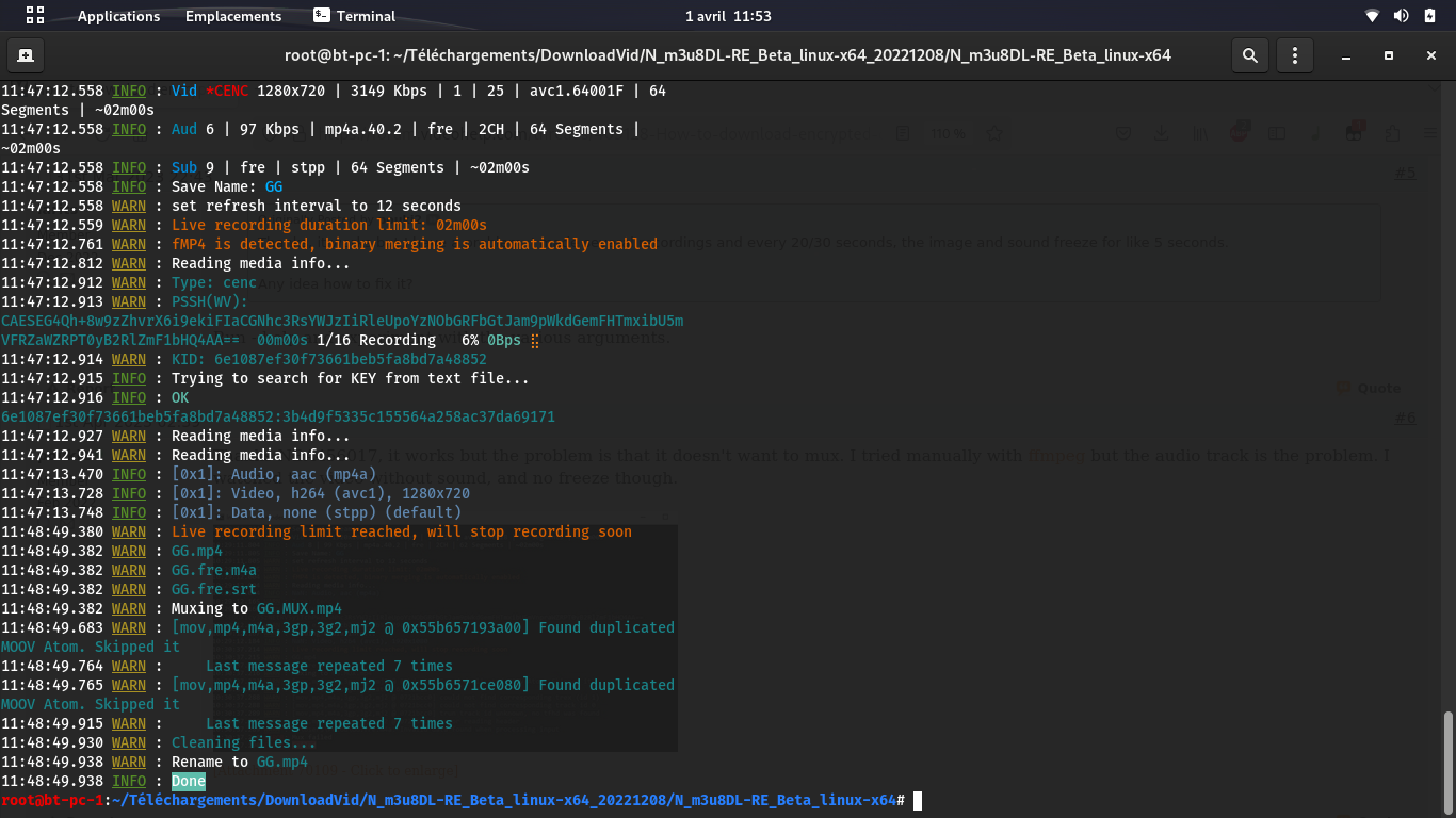

  7. Hello Pouki
    I think you can't mux because there is a problem in decrypting video.
    Put the keys you have found in a file "key.txt" In the folder of N_m3u8DL-RE
    Keys
    --key 6e1087ef30f73661beb5fa8bd7a48852:3b4d9f5335c155564a258ac37da69171
    --key 447d7f4af09f3e4895e4960e536d995a:bcbd7d825d82c1dc1b301cce1db6a063
    --key 433ffba670963e70857859a9dff4be04:51ede3a821229fe81e71282c8eff80e3
    --key 934bc7c6a0293d5b9e261a7324777503:13f4e2b05760045e1b11066974e57fe5
    --key 91d9467bd795318ba07c4867ff4381e7:5ca4d67cf1663d2146a9139575480a36
    you can now use the command from NBA456017 (with "key.txt")
    ./N_m3u8DL-RE --key-text-file key.txt --save-name GG "https://origin-caf900c010ea8046.live.6cloud.fr/out/v1/1b7883731a2a4c9daf16dde45a8162e9/dash_short_cenc10_m6_hdeindex.mpd" --append-url-params --mp4-real-time-decryption --live-real-time-merge --live-record-limit 00:02:00 --mux-after-done mp4
    [Attachment 70110 - Click to enlarge]

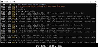

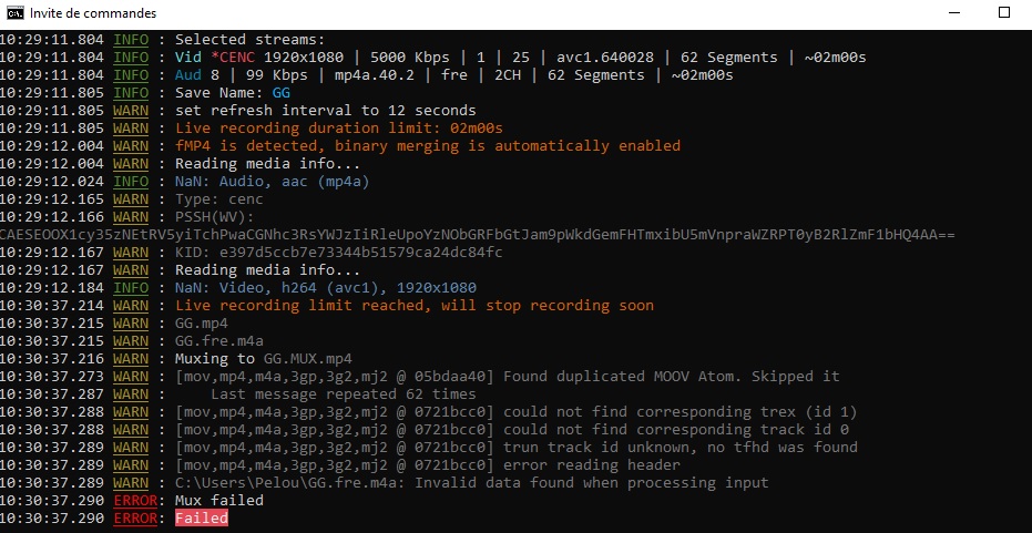

  8. Thanks Cedric , it mux now but at the end, I have only the sound, no video. I have this error message.
    I had the last version of n_m3u8dl-Re with windows (N_m3u8DL-RE_v0.1.5.3-beta), I tried to take an old one because I saw on your picture that you were using but it does not change anything.

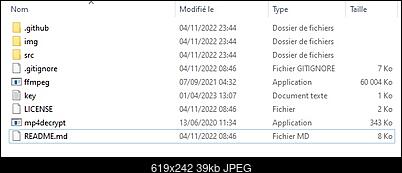

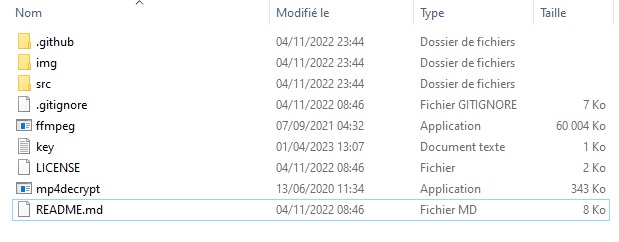

  9. Ffmpeg and mp4decript must be on the folder of N_m3u8dl-Re
  10. Yes they are in the file but still the same mistake.
