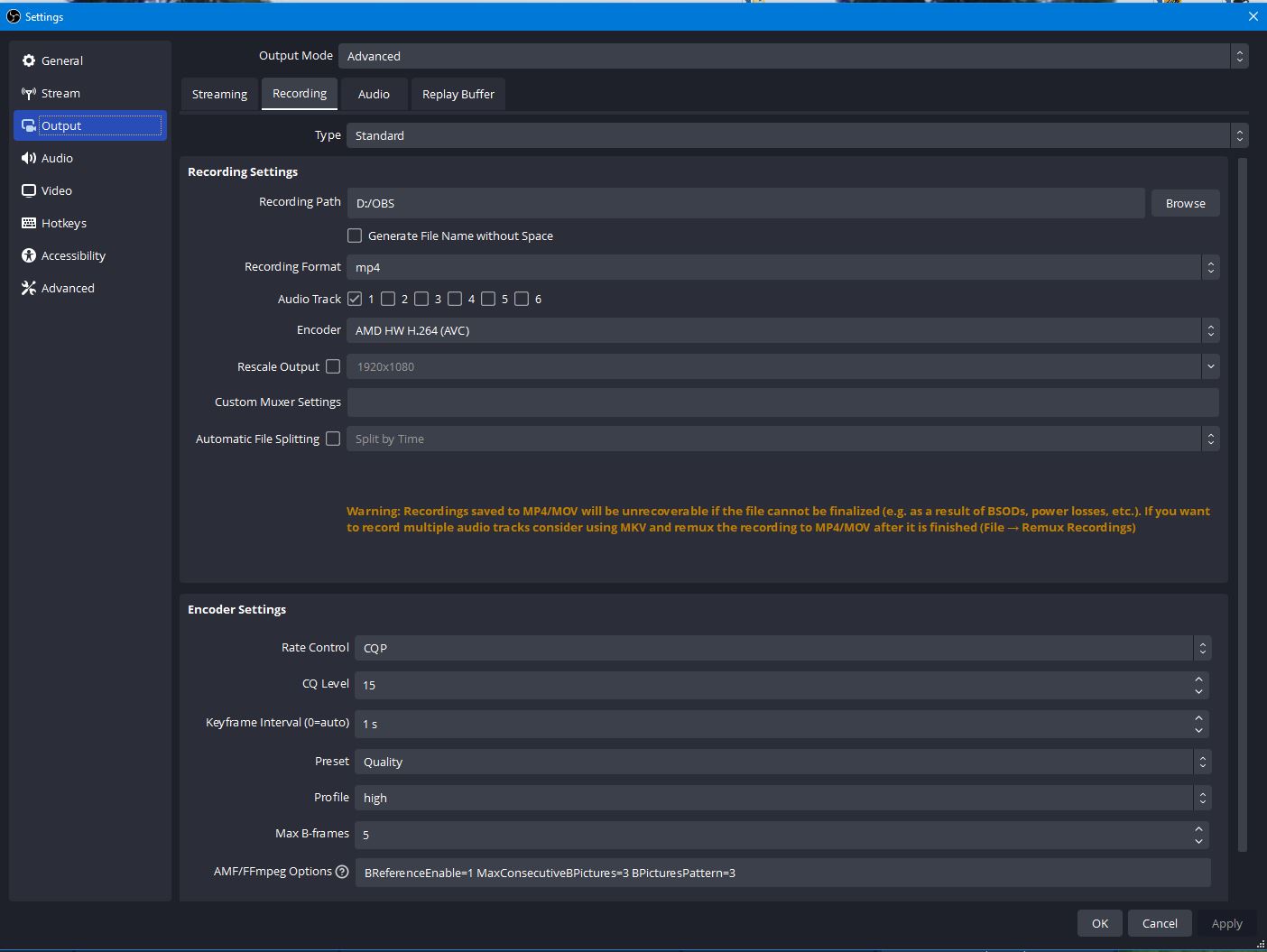

    I spent some time with OBS, can definitely confirm using the settings supplied by youtube video mentioned previously, that B frames are available with the AMD encoder set. I used this to output 3 B frames, I tested up to 4 ... Image
    [Attachment 70132 - Click to enlarge]
    BReferenceEnable=1 MaxConsecutiveBPictures=3 BPicturesPattern=3.
    I can confirm that testing with several different FHD clips that AMD AV1 always outputs 1920 x 1082.
    I use -bf:v n to set the 'n' number of B frames using ffmpeg with AMF encoder and it never outputs any B frames. I use this same syntax for Nvenc and QSV HW encoding. I use -x264-params bframes=n and and -x265-params bframes=n with CPU x264/x265 encoding and they all output B frames. I may be missing some required AMD ffmpeg syntax, perhaps its not -bf:v n, I have also tried -bframes n.

    I would like to add that, as I expected, the B frames working in OBS appears to be limited to h264, just tested using the previous settings that worked for h264.

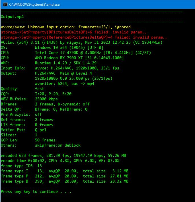

  18. You can use VCEEncC64 --help 1>help.txt to print out the instructions
    The syntax for all of them (NVEncC, QSVEncC) are basically the same
    Usage: VCEEncC [Options] -i <filename> -o <filename>
    -b,--bframes <int> set consecutive b frames (default: 0)
    You can use VCEEncC --check-features to see what is supported by your HW
    A quick check for h264 b-frames encoding
     VCEEncC --bframes 3 --codec h264 -i input.ext -o output.ext
    you can also try --codec hevc or av1

    AOK, thank you. I'll check that out tomorrow evening, it's near bedtime here in Dublin. So as I understand it the AMD encoder is part of VCEEncC64 ?
  20. Originally Posted by JN- View Post
    Yes

    Dublin
    Thanks PDR. In short, the B frames and presets work aok using VCEEncC64.exe. So I don't know why not using ffmpeg. Thats a nice program, putting all of the options like that at the start is simpler too, although maybe there is an order within the options. I had only 2 issues .. I couldn't succeed in outputting a different frame rate and I always got a warning when I enabled B frames, although that did still output B frames. I am going to paste a few notes to that effect below, plus the simple batch file I used to test.
    Using VCEEncC64 ..
    B frames ..
    When outputing B frames in h264 (max of 3) it works, the B frames are output, but I get 2 red lines at the top ...
    storage->StProperty(BPicturesDeltaQP)=6 failed: invalid param..
    storage->StProperty(ReferenceBPicturesDeltaQP)=4 failed: invalid param..
    See my post number 33 re: The “storage” lines with errors.
    B frames have a max of 3 with h264.
    B frames work with h264. A warning, not supported in hevc. No warning, none output in AV1.
    Presets ..
    Using h264 .. -preset works. default can be none set or "balanced", "fast", "slow". All 3 output different data rate and file sizes, so aok.
    Using AV1 .. 4 presets .. balanced, fast, slow, slower
    AV1 -preset works but default i.e. none set = balanced outputs the same file size and data rate as 'fast'.
    I cannot enable a frame rate change. Source is 29.97 fps. If I enter say --fps 25 I get a yellow warning ...
    avvce/avsw: Unknown input option: framerate=25/1, ignored.
    This is in the help file .. --fps <int>/<int> or <float> set framerate
    I tried ..
    --fps 25
    --fps 25/1
    --fps 25.0
    --fps 23.976 I get message .. avvce/avsw: Unknown input option: framerate=24000/1001, ignored.
    --fps 24000/1001 I get message .. avvce/avsw: Unknown input option: framerate=24000/1001, ignored.

  22. When outputing B frames in h264 (max of 3) it works, the B frames are output, but I get 2 red lines at the top ...
    I wouldn't call it "working correctly"...
    2 red lines on only b-frames ? or 2 red lines on every frame ?
    What about when using no b-frames ? Do the red lines occur ? Did you check other player to rule out decoding issue ?
    What were the characteristics of the source ? progressive/interlaced ? dimensions ? pixel type ?

    "2 red lines on only b-frames ? or 2 red lines on every frame ?"
    I may not have been clear enough, the 2 red output text lines are the VCEEncC64.exe's on screen output. The encoded output file plays and looks fine.
    [Attachment 70151 - Click to enlarge]

    I have worked around this but if I hadn't used OBS with hevc I wouldn't have known about this. It could arise in the future with some other output and so I am now prepared! Progress of sorts.

  28. Originally Posted by JN- View Post
    I cannot sort out/fix the error messages, any more than I cannot enable setting a frame rate.
    The error message "SetProperty(BPictureDeltaQP)=6 failed" sound like an attempt to set the QP for B frames 6 higher than the QP for I frames.
