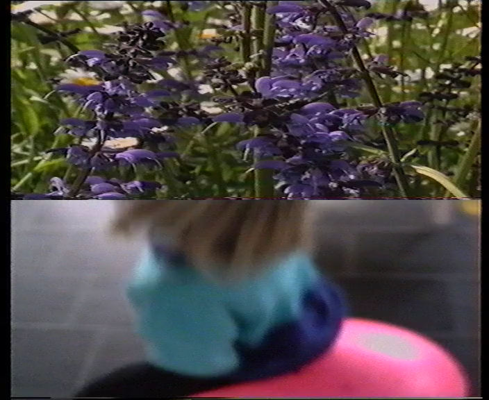

  5. The chroma of the two fields has been partially blended together. Here's the two fields with the chroma unblended.
    [Attachment 69999 - Click to enlarge]
    LWLibavVideoSource("field-muxing.mp4", cache=false, prefer_hw=2)
    SeparateFields()
    v1 = SelectEven()
    v2 = SelectOdd()
    c1 = MergeChroma(v1, Overlay(v1, v2, mode="subtract", opacity=0.33))
    c2 = MergeChroma(v2, Overlay(v2, v1, mode="subtract", opacity=0.33))
    # c1 and c2 are the cleaned fields
    # enable one of the following lines to see a single field, double height
    #return(c1.nnedi3(dh=true))
    #return(c2.nnedi3(dh=true))
    # otherwise, show them stacked
    StackVertical(c1, c2)
    AssumeFrameBased()
    There may still be a tiny bit of the blended chroma left. Adjusting the opacity parameters might help. Or maybe there's some chroma from adjacent frames.

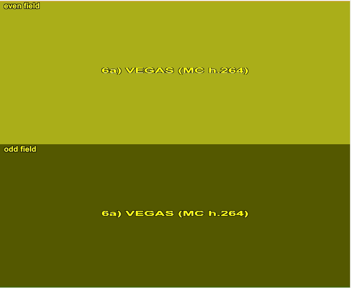

  15. Here some results from chroma blending/crosstalk/leakage tests of YV12 interlaced AVC encodes using different encoding tools.
    The source 'source_422i.avi' for the tests is interlaced YUV 4:2:2, one field RED the other field GREEN, which was converted to YV12 by the script
    LWLibavVideoSource("source_422i.avi")
    ConvertToYV12(interlaced=true)
    for providing the YV12 4:2:0 input to the AVC encoders.
    The attached file 'YV12 encodes.avi' shows the result of the encodes. Left side is the AVC encoded YV12 frame, right side are the separated fields.
    Surprisingly, only the commandline x264 and ffmpeg libx264 encodes returned clean separated fields in the original colors (cases 1 and 2).
    The NLE Shotcut (case 3) darkened the colors, and the RED field is actually out of RGB gamut. Enabling the 'Color Grading' filter in Shotcut (case 3a) gave fields colors closer to the original RED and GREEN fields, but with a faint horizontal line pattern. The NLE Kdenlive (case 4) is identical to the Shotcut case 3a.
    It seems to me like the NLEs added their own magic, or I did something totally wrong .........

  17. VEGAS recovers the RED and GREEN fields pretty well. Still some horizontal line artefacts with slightly out of gamut RGB values (clipped to 0) though.
  18. Vegas should be ok. The line artifacts are likely because you forgot to interpret the video as "interlaced", so it performs the chroma upsampling (internally vegas works in RGB) and then to 4:2:0 as progressive chroma sampling instead of interlaced.
    Shotcut and Kdenlive do not have proper interlaced support the last time I checked
    EDIT: yes - vegas is ok when you interpret "source_422i.avi" as "interlaced", and the timeline and export settings match. (It comes in interpreted as progressive and you need to manually assign)
  19. Originally Posted by poisondeathray View Post
    Thanks. It's just too bad. It seems still to be the case.
    This is what I am getting then for the 2 fields. No line artefacts, but the the separated fields are far from the original RED and GREEN ....
    [Attachment 70191 - Click to enlarge]
  20. I get red and green fields in vegas h264 interlaced 4:2:0 export
    Check your 1) file interpretation settings 2) project settings 3) export settings
  21. Originally Posted by poisondeathray View Post
    Thank you for the hints and for the sample.
    I did all this, but the problem seems to be my Vegas Movie Studio version 16 which has its limitations and cannot properly convert the 4:2:2 interlaced source to 4:2:0 AVC interlaced.
    I have to convert 4:2:2 to 4:2:0 with an avisynth script (ConvertToYV12(interlaced=true)), and because Vegas cannot read Avisynth scripts I use AVFS to produce a virtual .avi file for Vegas (same applies for Shotcut and Kdenlive btw.). The result is that the colors (fields) are eventually about right but with the scanline artefacts, see post#18.
    My Vegas Movie Studio can do the conversion without the AVFS workaround using its mpeg2 encoder. The outcome is correct, but mpeg2 instead of AVC.
    Anyway, a simple script + commandline (x264 or ffmpeg) does the job perfectly.
