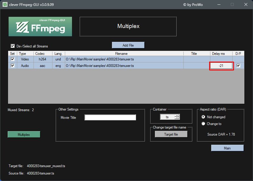

Use clever FFmpeg-GUI.
Load your video, click main, click multiplex, you'll see all streams and the actual delays of the audio- and substitle streams, if any.
Put in the stream delay field the value you want (in milliseconds) and click multiplex.
Done.

Interesting utility, so this did work. Either removing the delay from the AAC or just unchecking those tracks did leave the final file with [0 ms][0 ms] listed in gMKVExtractGUI and no Delay relative to video and the streamhashes even stay the same.
Thanks. Though I am curious what command it's actually running in the background.Code:ffmpeg -i $mkvfile -map 0 -c copy -f streamhash -hash md5 -v warning -
