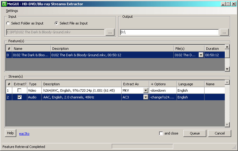

I'm hopeless with command lines but for the record, this is a command line similar to the one MeGUI's HD Streams Extractor used for extracting the audio from an MKV and changing it's speed.
Code:"C:\MeGUI\tools\eac3to\eac3to.exe" "E:\video.mkv" 2:"D:\video_T2_Audio - English.ac3" -changeTo24.000 -progressnumbers
Code:"C:\MeGUI\tools\eac3to\eac3to.exe" "E:\video.mkv" 1:"D:\video_T1_Video - English.mkv" -slowdown -progressnumbers

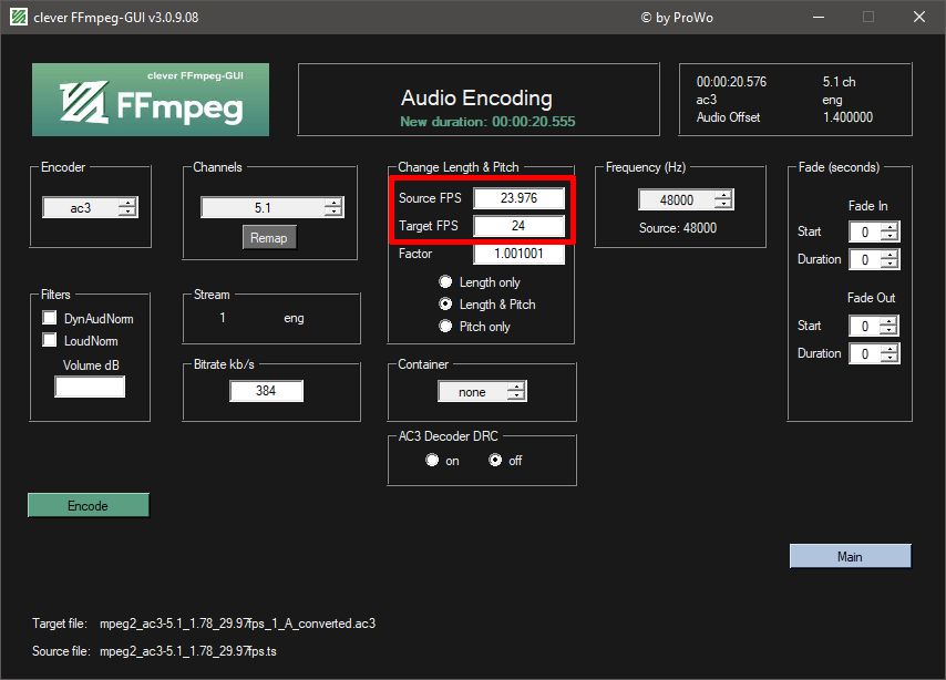

Use clever FFmpeg-GUI.
Load your AC3 5.1 file, click main, click encode audiostream, click go to the encoder, set the change length & pitch section like in the picture, click encode.
Done.
[Attachment 69990 - Click to enlarge] -

Looks like it works, including the fps change procedure from user ProWo! Thank you so much! But is there any method where I can verify that the fps has changed?
