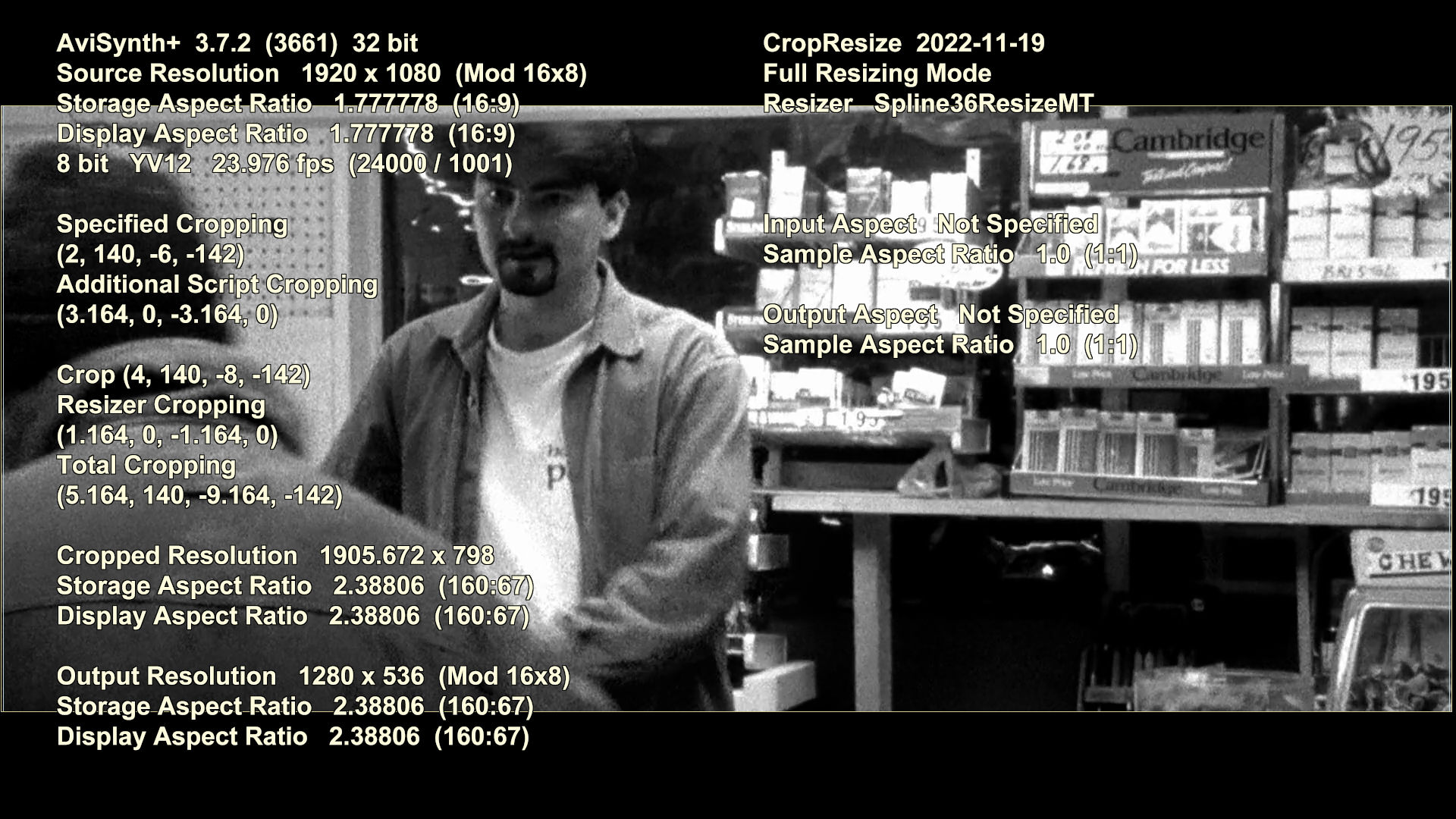

    You could also give CropResize a test drive. Unlike "normal" resizing it won't stretch the picture. If the source aspect ratio and the output aspect ratio (resizing) don't match, it'll crop some extra picture to prevent aspect error. Until you get used to it, it's generally better to only specify an output width or height (not both) and the script will take care of the other. CropResize also applies your desired cropping so there's no need to use Crop(). The following would output 1280x536 without having to round, because the cropping is exact (it uses the resizer to apply sub-pixel cropping if necessary).
    Preview:
    CropResize(1280,0, 2,140,-6,-142, CPreview=1, Info=true)
    [Attachment 69980 - Click to enlarge]
    CropResize(1280,0, 2,140,-6,-142)
    [Attachment 69981 - Click to enlarge]
