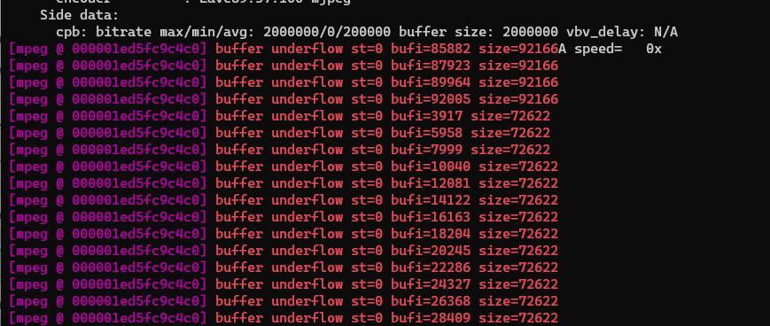

    If I specify a -maxrate and -bufsize, I then get the following buffer underflow errors happening in the mpeg code:
    [Attachment 70375 - Click to enlarge]
