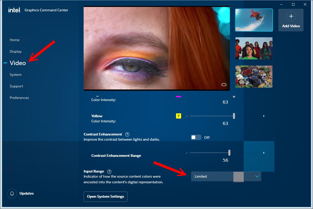

    Graphics card drivers usually have a video section where the conversion range can be specified. Here's the Intel driver on my computer:
    [Attachment 69948 - Click to enlarge]

  20. Originally Posted by rgr View Post
    And what does the Intel driver do when the source is in Full range?
    There are three choices: Limited, Full, and None. Limited and Full force incoming YUV video to be converted to RGB with the specified matrix. So a full range video forced to limited range will display with crushed blacks and whites. The None setting assumes limited range when the range isn't specified by the video. If the range is specified by the video (and the player and all intermediate filters pass that information to the graphics driver) it is displayed properly.
