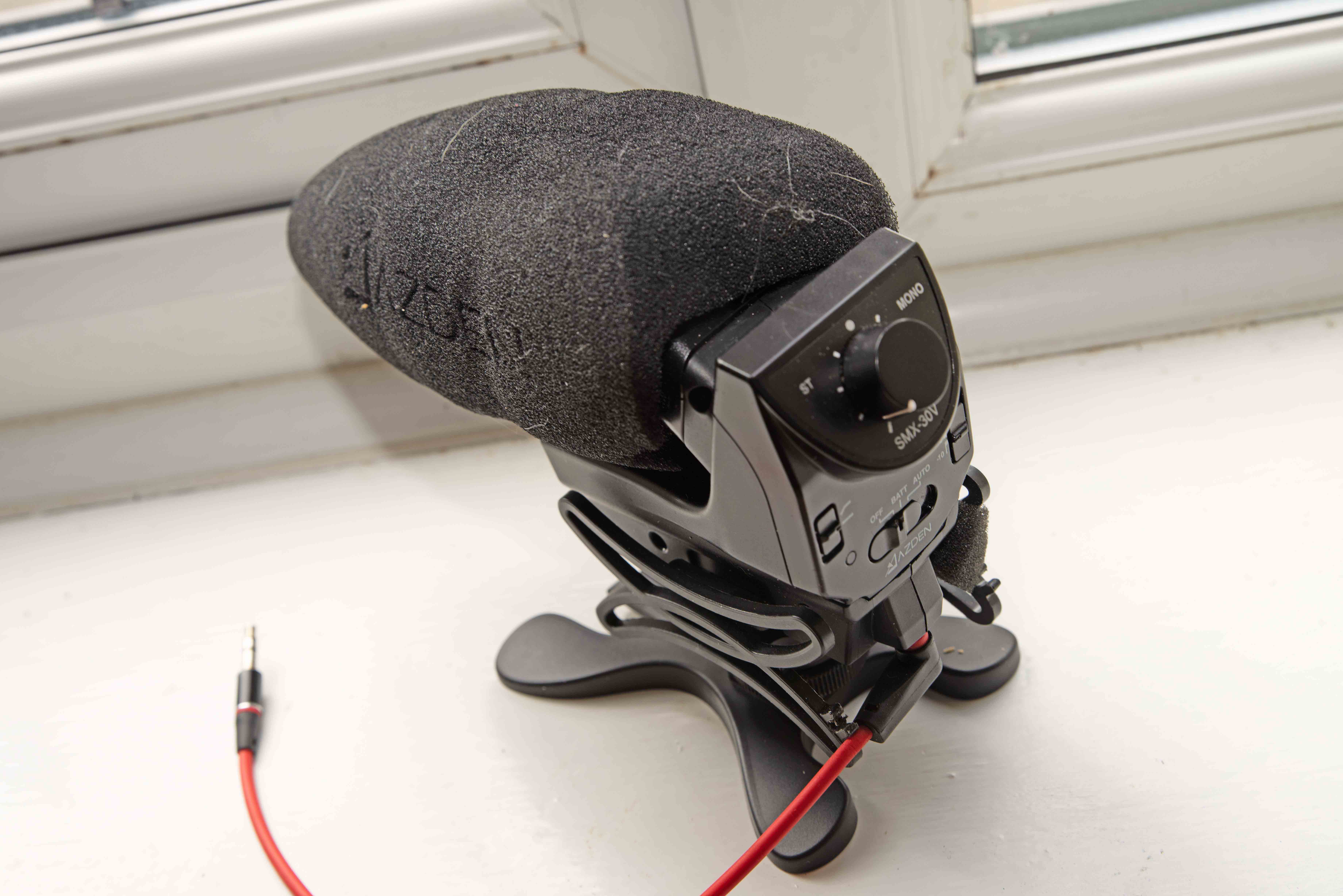

I now mainly use an Azden SMX-30V microphone with it for several reasons. to start with you can go from stereo to directional sound via a dial (used in my videos above) it can be powered from AA batteries or from the camcorder one, decibel and flat setting and a detachable audio cable , and cheaper than other well known makes
