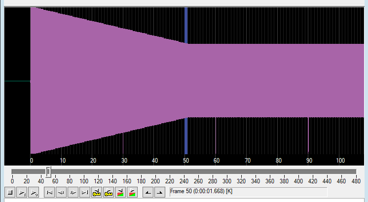

    VirtualDub's audio waveform of a constant amplitude sine wave after FadeFrom2xto1x(50):
    [Attachment 69897 - Click to enlarge]
    It would be useful to include the amplification amount as a variable too.

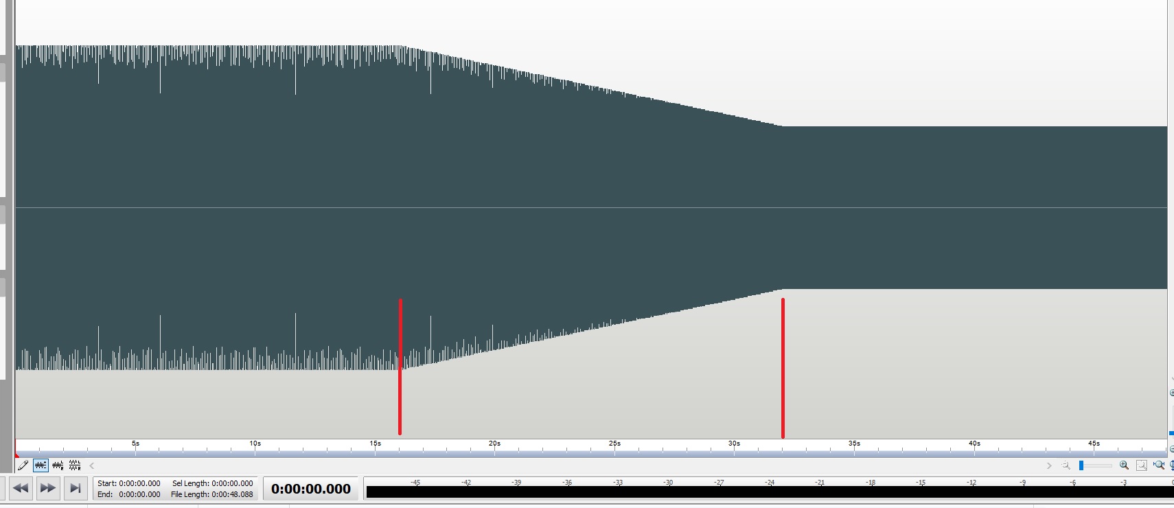

  13. I've given that script a workout, this time on a 'Tone Test' video and it's certainly an easy script to use. The video I used it on lasts 48 seconds with 1440 frames and this is my script (I changed the name of the function):
    function semifade(clip Source, float "StartGain", float "EndGain")
        NumFrames = Source.FrameCount
        a1 = Source.Amplify(StartGain*2.0).FadeOut0(Source.FrameCount)
        a2 = Source.Amplify(EndGain*2.0).FadeIn0(Source.FrameCount)
        Mixaudio(a1, a2)
        AudioDub(Source, last)
    LoadPlugin("D:\MeGUI\tools\lsmash\LSMASHSource.dll")
    a=LSMASHVideoSource("D:\Test Tone.mp4")
    b=LSMASHaudioSource("D:\Test Tone.mp4")
    audiodub(a,b)
    Trim(0,480).Amplify(2)++trim(481,960).semifade(2, 0.5)++trim(961,1440).Amplify(0.5)

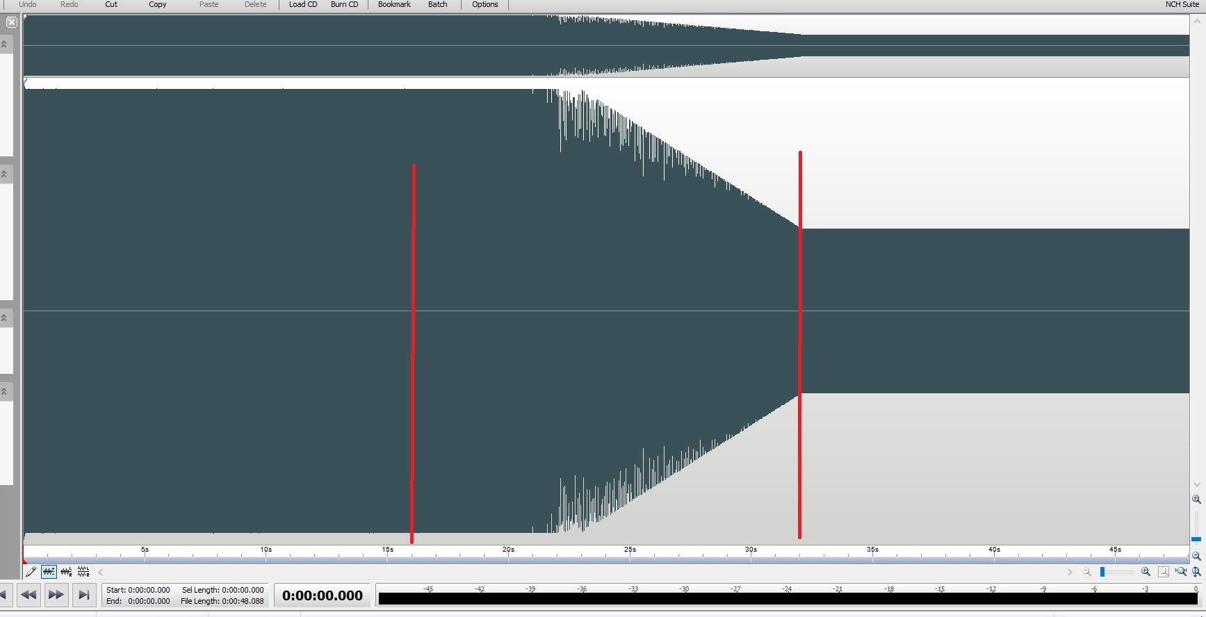

    As you can see, I've split the vid into thirds: loud/fade/low. Attached is the waveform and you can see that the fade ends exactly where it should at 32 seconds. Oddly, the 'loud' section seems to have overrun by 4-6 seconds. Can you identify any reason for that?
    Otherwise, terrific script, exactly what I was after.
    [Attachment 69918 - Click to enlarge]
  14. You have blown out the audio. The sections are the correct length but the middle section is maxed out for the first ~1/3 of its duration.
  15. You're right. Thanks a lot.
