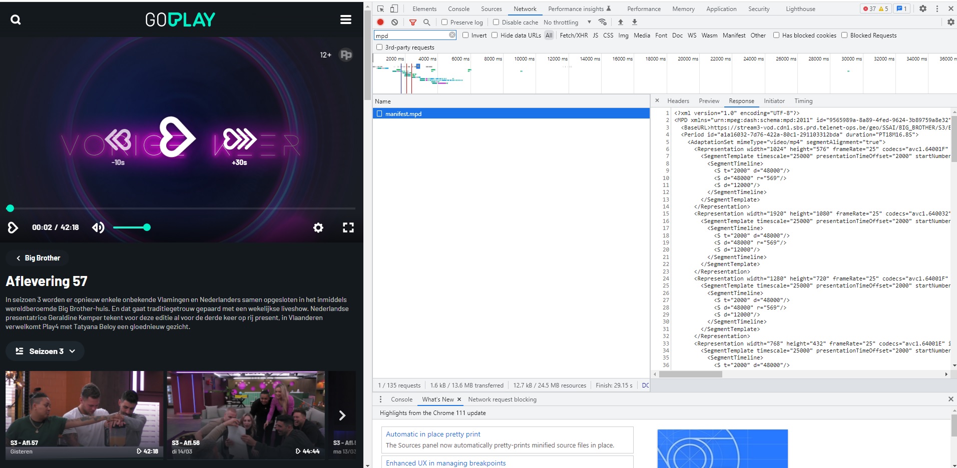

I opened Big Brother episode 57.
You open developer tools, network tab and search for mpd.
[Attachment 69830 - Click to enlarge]
This MPD doesn't have protection.
You copy the link of the mpd and use yt-dlp with it. -

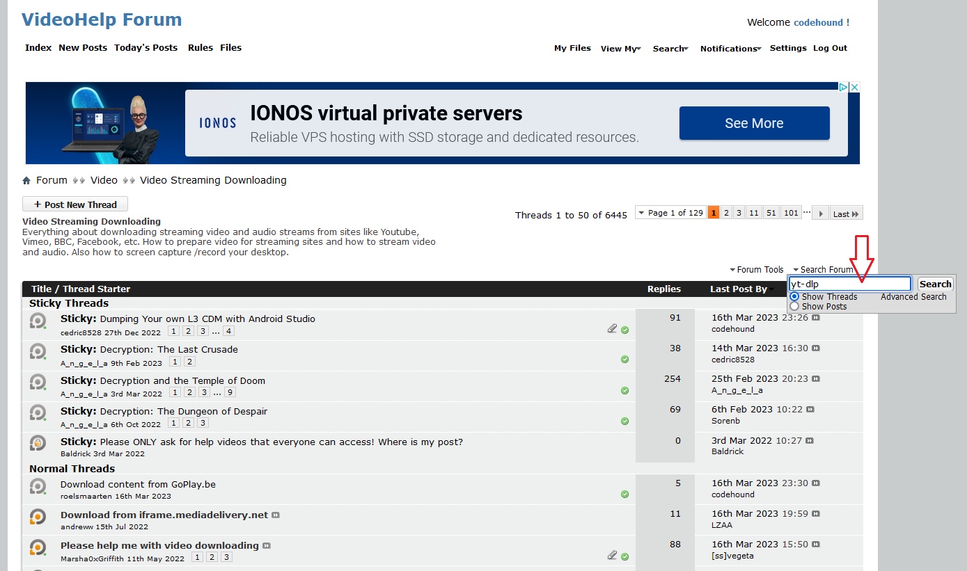

read this forum a little bit to get the basics -

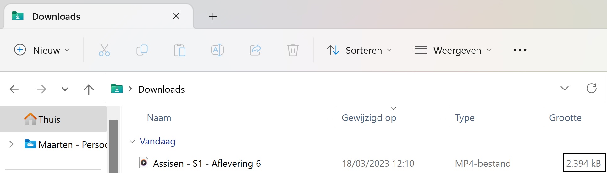

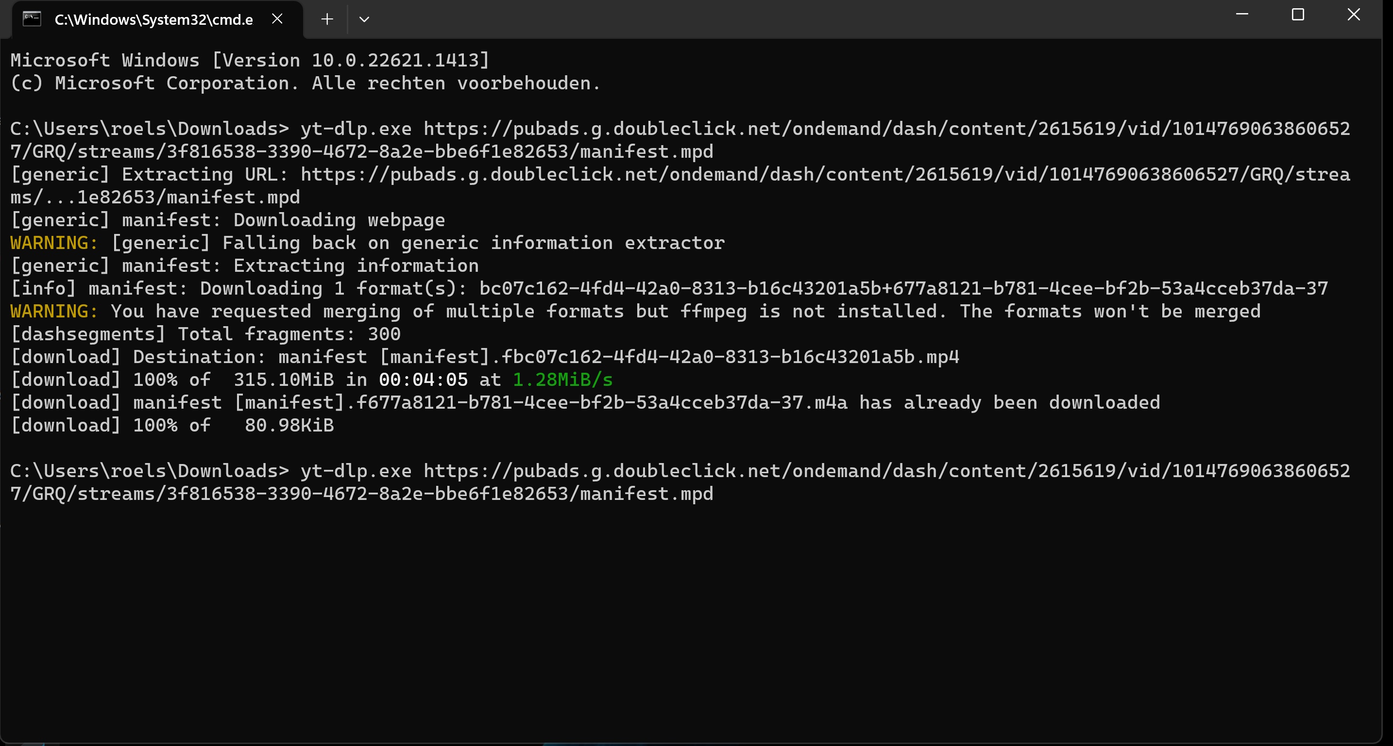

I think I managed to download a video after all.
But I have 2 problems:
1. Even though ffmpeg is in the same folder, yt-dlp says it is not installed.
2. I get no audio after download
(when downloading a Youtube video I do get audio).
Any idea what the solutions are for this? (See screenshots)

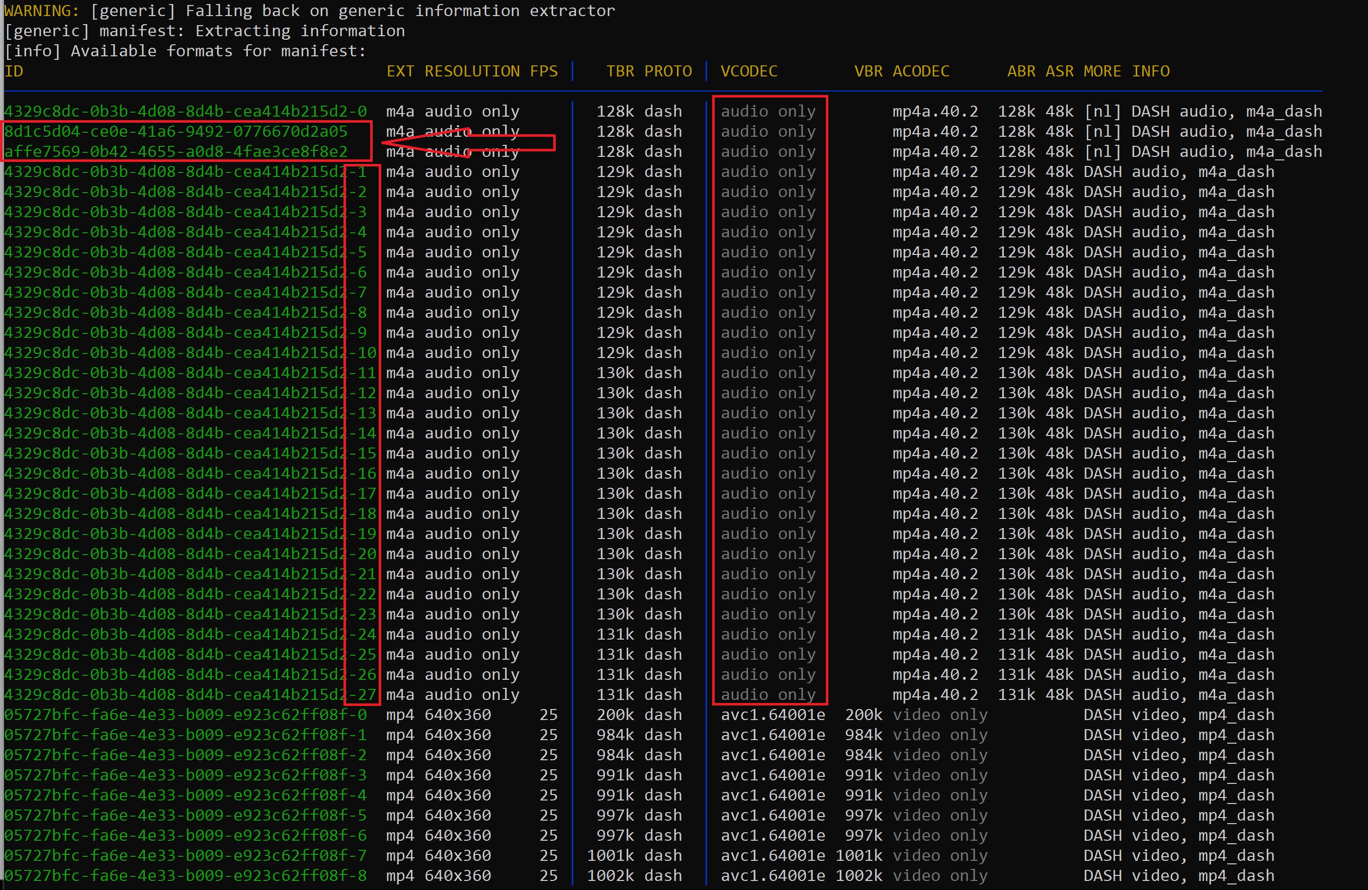

I bumped into the same issue, for me it downloaded only the audio of the first ad.
I did the following to solve it
This returns a list, in my case with a bunch of audio formats ending with -0 -1 -2 etc, all those are nasty ads.Code:yt-dlp --list-formats http://blabla.mpd
So I took the only 2 in the list that do not end with -number
[Attachment 69845 - Click to enlarge]
Then I used the following command
This produced a .mp4 file with the correct audio for meCode:yt-dlp -f bestvideo+8d1c5d04-ce0e-41a6-9492-0776670d2a05+affe7569-0b42-4655-a0d8-4fae3ce8f8e2 https:blabla.mpd

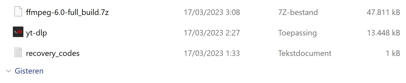

Install 7zip.
Then right click your 7z file and extract the contents. You are probably gonna find a bin folder with 3 exes, one of which will be ffmpeg.
Also, I gave you no link. That's the forum automatically doing it for the common software tools. -

Is it the same error as before?
If so, did you read the error?
"ffmpeg is not installed. Formats won't be merged."
Meaning that the video and audio files won't be merged together.
Also, it says that the audio has already been downloaded so it won't download it again. If you add ffmpeg correctly, yt-dlp should merge the video and audio properly even if already downloaded. If it doesn't, try deleting the video and audio files and try it again.

A programme like Firefox Downloadhelper is not a solution as you can see in the screenshot.
So: I have to extract the 7z file with 7zip and place the .exe file in the same folder.
Should I then follow the 'path' procedure for ffmpeg to work properly, or is this the only thing?

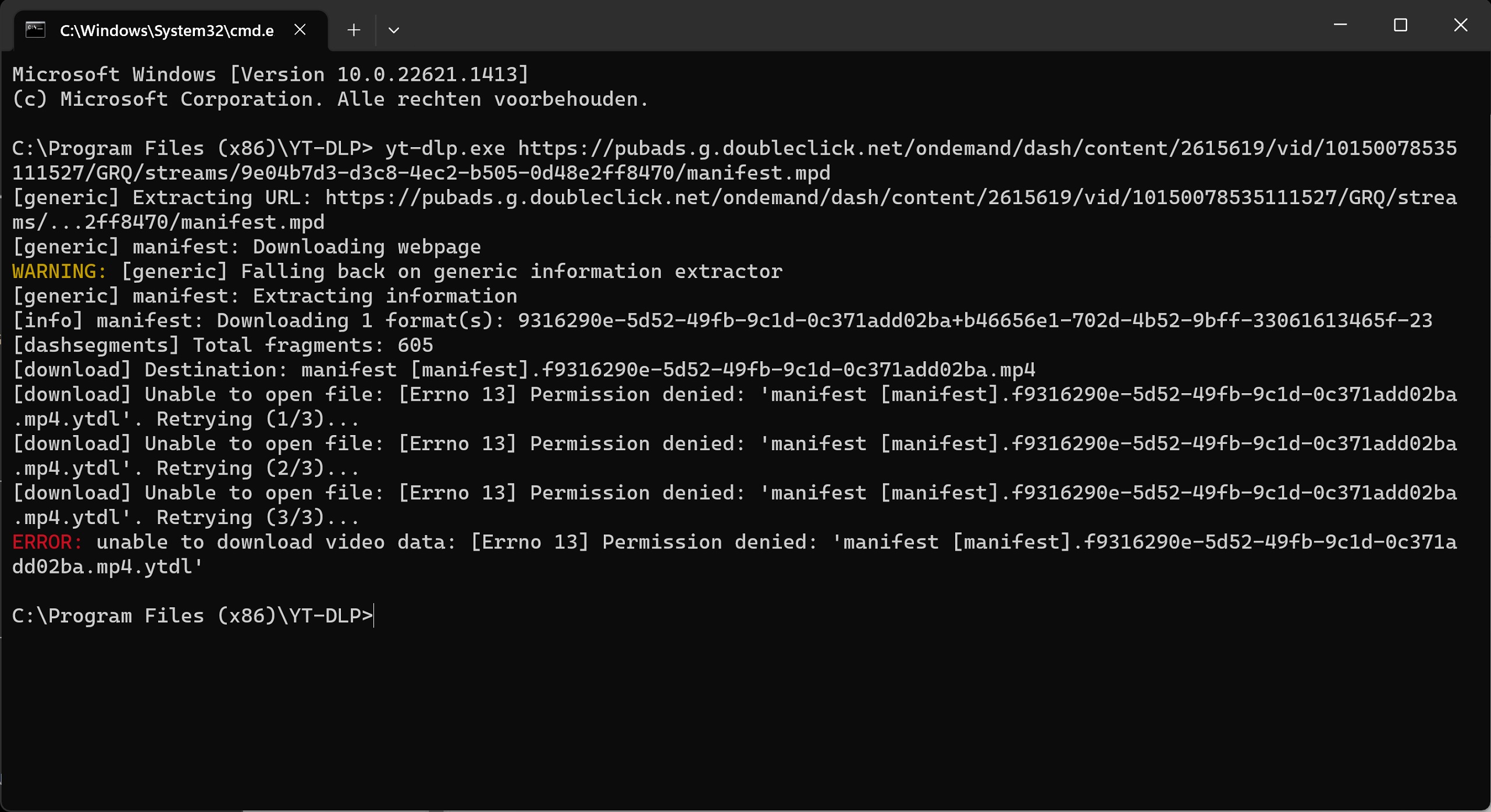

All I get on my screen now is this.
[Attachment 69854 - Click to enlarge]
I now have Yt-dlp and the .exe file of ffmpeg.exe in the same folder.
I did exactly what I was told. Any idea how to fix this? -
'Errno 13: Permission denied' indicates that you don't have permission to save the file in that path. Try saving it to another path, like a folder on desktop for example. You can use -P to specify:
Code:yt-dlp "MPD URL" -P C:\path\to\wherever
URL to the actual video page, not the mpd.
But judging by that mpd and jerry's post up there, they might have cut up the tracks in various ways in order to bundle in ads, and then stitch it together as you're playing the video. You might have to specifically download all tracks without a number and then merge with ffmpeg. Or try a different program like Streamlink. -
