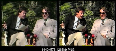

  9. Captures & Restoration lollo's Avatar
    Jul 2018
    Italy
    Is SCART better than S-Video?
    Scart can convey Composite, Y/C, and RGB signals, S-Video can convey only Y/C signal.
    Generally (not always) the S-Video cables are better quality than Scart cables , but the signals are the same quality (exept if inside of the device one of the 2 signal path is degraded, rare).
    Comparing your 2 videos, the second has different levels, and suffer less of horizontal jitter. Also color fluctuations are less evident. The second features slightly less details.
    Image comparison here: https://imgsli.com/MTYzMjMw
    Video comparison here: compare.mp4

  12. Originally Posted by lollo View Post
    [Attachment 69867 - Click to enlarge]
    Video comparison here: Image
    [Attachment 69866 - Click to enlarge]

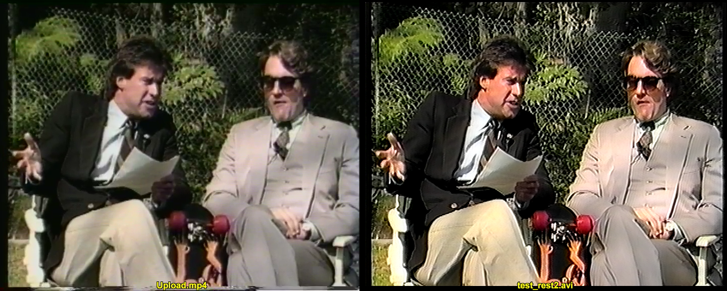

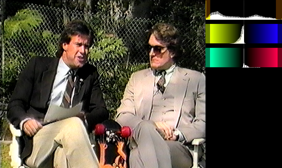

  17. Captures & Restoration lollo's Avatar
    Jul 2018
    Italy
    I ignore what is your new device, but here my comments:
    - the levels are crushed (should be avoided)
    [Attachment 69900 - Click to enlarge]
    - comparison between the original ClearClick capture (Upload.mp4) which includes deinterlacing and who knows what and last Unknown device capture (test.avi), where I applied a very basic not optimized AviSynth processing consisting of deinterlacing, denoise and light sharpening (probably not necessary because the capture is already over sharpened).
    Judge yourself.
    video comparison (compressed to h264 to save space): compare.mp4
    image slider comparison: https://imgsli.com/MTYzNzA0

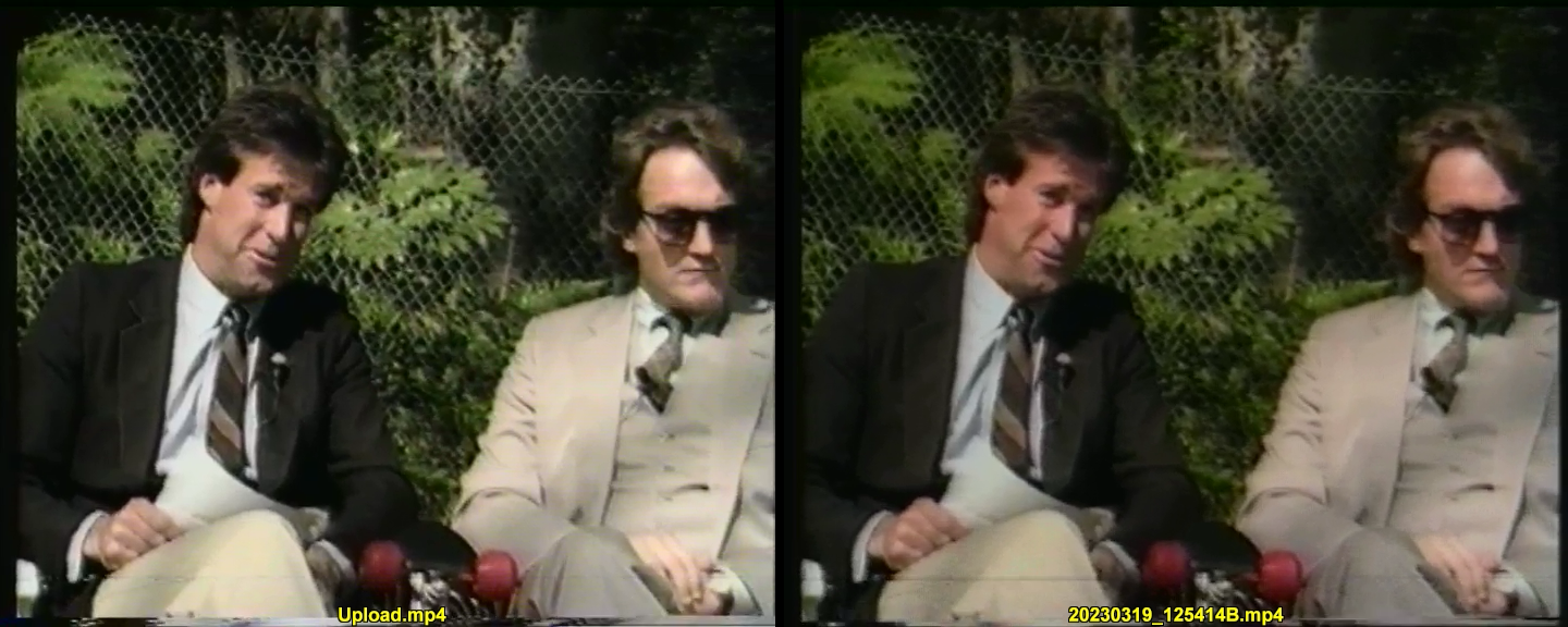

  19. lollo,
    thanks for doing that again. I did another capture. This time I did it on a Panasonic DMR-EX95V using S-Video, whereas before I used a Blaupunkt RTV 936 with RCA. The Blaupunkt is also new and I only cleaned the machine with a cleaning tape. Anyhow, I think this footage looks better.
    Thanks.
  20. Captures & Restoration lollo's Avatar
    Jul 2018
    Italy
    You should have all the elements now to perform a comparison and make a judgement by yourself. If something is not clear, just ask. Good luck with your captures!
