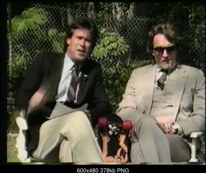

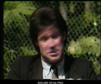

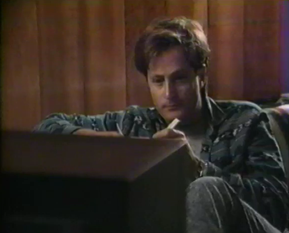

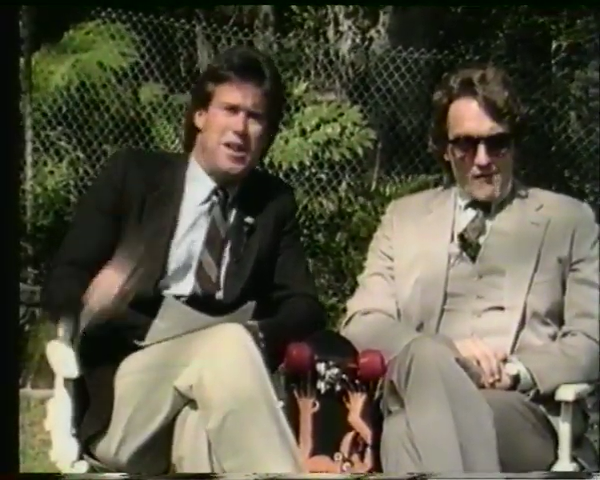

    So far, so good. The quality is alright I would say.
    I do not wish to criticize your work, just my not (so good) impressions:
    resolution/details

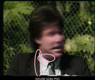

    edges

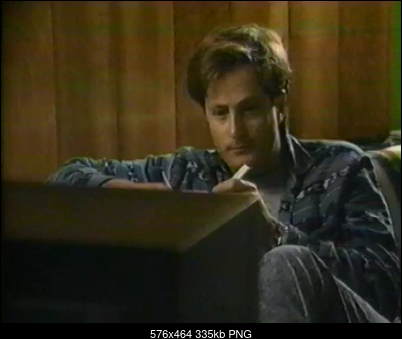

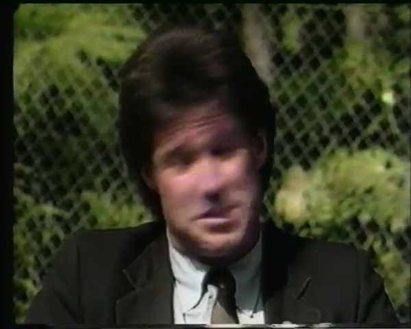

    motion

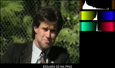

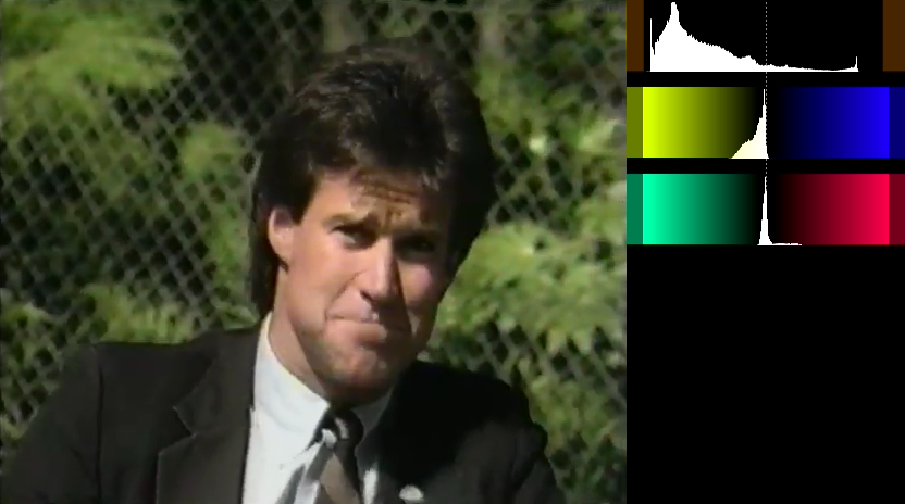

    crushed and clipped levels
    from green
    to purple
    Watching the video running instead of fixed images is even worst.
    Try to upload here on the forum the original capture, maybe is slightly better.

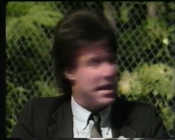

    The video vibrates left/right.
    That bad capture method (OBS to H.264, etc), no TBC whatsoever, the cheap $5 (sold for $110) capture card, has actually made the quality worse than what existed on the VHS tape. It should look better, not worse.
    It's pretty lousy in a small Youtube window. Viewed full screen on a large computer monitor, it looks like garbage. Anything larger, like a typical modern TV, and it's outright unviewable schlock.

    It does not look THAT bad. Yes, it is wobbly, which can be clearly seen on the first shot with vertical lines, but people usually expect this from VHS. In fact, there is a whole industry of pseudo-VHS filters that can make a pristine digital video look so bad as VHS had never looked. It is a fashionable trend.
    Levels are not exaggerated too much, and motion looks mostly ok.

  24. Originally Posted by Bwaak View Post
    It does not look THAT bad. Yes, it is wobbly, which can be clearly seen on the first shot with vertical lines,..
    Thanks for saying that it is not that bad, ha ha.
    ...but people usually expect this from VHS. In fact, there is a whole industry of pseudo-VHS filters that can make a pristine digital video look so bad as VHS had never looked. It is a fashionable trend.
    Thats what I meant. People are expecting this type of quality and they forget about it really fast, once they see themselves 30 years younger...
    For 625/50 region, capturing a movie at 25 fps progscan is fine. Still, if you want to capture true video, not a movie, you will need either 25 fps interlaced, or 50 fps progscan, can your box do that?
    Good question! Here is a link to the actual box I have. The one I talked about earlier just looks like mine. I remember ready somewhere that those boxes are pretty much all the same, just a different name. https://www.amazon.de/gp/product/B07X7633VR/ref=ppx_yo_dt_b_search_asin_image?ie=UTF8&psc=1
    The description says that it captures in 720x480, does it use this frame size for 625/50 as well? In this case you lose vertical resolution. Can it save in 720? Also, since it re-scales, it must deinterlace first, so I suppose it does not preserve interlacing. I hope you can get 50p from it.
    I have to apologize. Like I said, the box I listed first is not my box. I did not think that we are going to discuss the box because I thought it was doing a great job, ha ha. That said, my box does not have that many settings. Language, Date and Time, Watermark, Signal Detection (it stops recording when there is no signal detected), Auto-Stopp Function (Timer Function), Source (AV or S-Video) and last but not least: Video Quality. It says 640x480 (4:3) or Auto-Detection. But no matter what I try, all videos are 720x576!!! The Frame rate varies from 49,87 to 50,02. However, I have seen 25,something as well!?
    I tried the S-Video cable on 640x480 and Auto,and the RCA (Whie, Red, Yellow) cable on 640x480 and Auto, but its always 720x576!? I guess this really is a crappy $5 dollar machine, ha ha.
    Another issue is that it saves it in a widescreen file, which is surprizing, I would think that by default SD video would be saved as 4:3.
    Like I said, no matter what I do, it will not save in 4:3. Does this mean the box is making the video worse by saving it in 16:9?
