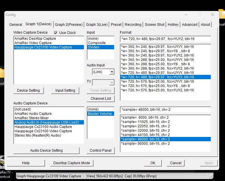

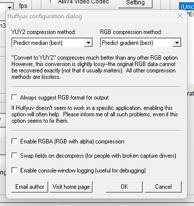

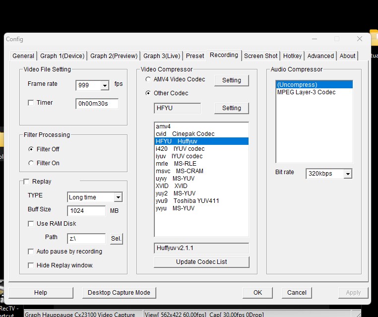

  1. I'm capturing laserdisc in amarectv and have a usb-live2. What I'm doing now (because it works) is capturing (my settings are below) taking the avi and putting that into avirecomp and then taking that file and making a dvd in dvd flick,burn with imgburn and that plays in a dvd player. If I just take the avi and put that in dvdflick and burn in imgburn the dvd plays in say vlc on my computer but in a dvd player it's just all pixels (I guess that's what you call it?) Is this normal or have I got a setting wrong?
    [Attachment 69739 - Click to enlarge]
    [Attachment 69740 - Click to enlarge]
    [Attachment 69741 - Click to enlarge]

  2. Don't know why you would need avirecomp as an intermediate step, but the framerate in AmarecTV of 999fps doesn't look reasonable to me.
  3. i've read that in amarectv 3.1 (which I'm using) it states use 999 and it will force amarectv to use same frame rate as your capture device.
    Setting 999 in AmarecTV is correct, because it forces the software to capture at the rate of the capture card (which must be properly set) rather than the capture software itself
