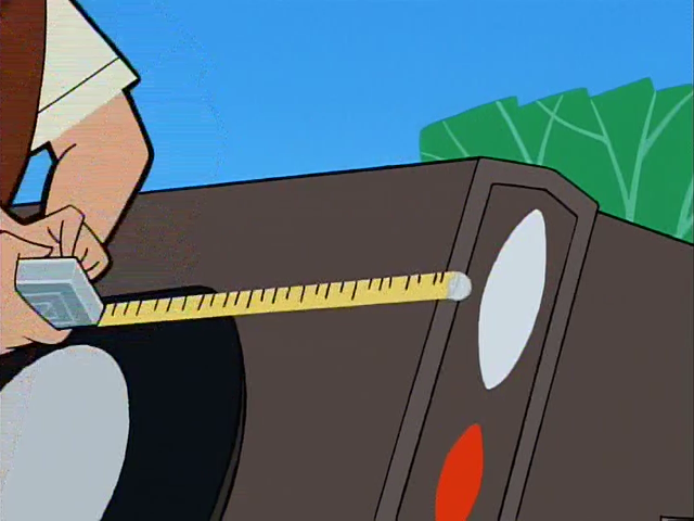

    I'm working on some video restoration with this cartoon clip that I have attached below.
    (I'm very new to this, so please go easy on me)
    The clip is 29.970 fps and clearly interlaced.
    But I have a feeling that whoever encoded it, made some serious mistakes and those mistakes are now hard baked into the video as a result. However I'm wondering if there are any plugins or filters that I can use to try and repair the damage.
    So I'm running the following script to detelecine, remove duplicate frames and most importantly restore the framerate to 23.976.
    LWLibavVideoSource("TEP_Sample.mkv")
    TFM()
    TDecimate()
    vinverse()
    crop(2,0,712,480)
    lanczosresize(640,480)
    I've been using that very basic script for years now and it's always done exactly what I need it to do. But for some reason, this particular sample clip won't play nicely. If you scroll through the clip, you will notice that there are signs of leftover ghosting and pixelated artifacts (every few frames). This is what I was talking about when I mentioned that the person who encoded the clip, made mistakes.
    [Attachment 69686 - Click to enlarge]
    [Attachment 69687 - Click to enlarge]

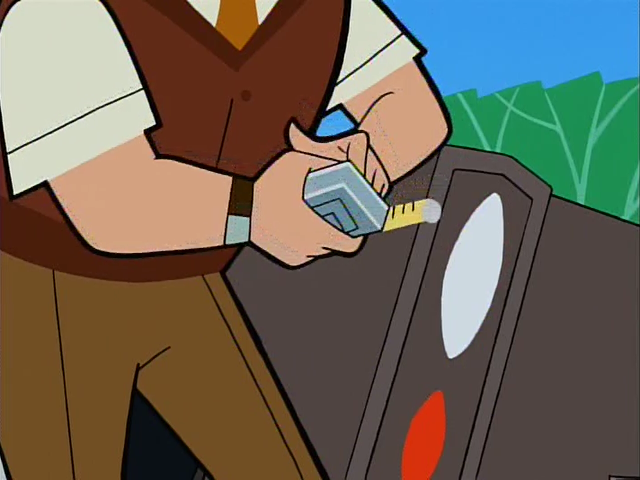

    If you look closely at the screenshots I provided above, you will see artifacts and ghosting around his arm and the tape measure.
    As an alternative I tried QTGMC using TFF and it provided similar results.
    This is where things get really interesting. I imported the video clip into VirtualDub and applied a deinterlace filter. I wanted to unfold the fields so I could see them next to each other as I slowly played back the video.
    So I'm not sure if that's supposed to be normal, but I'm guessing not. It's like each field has artifacts to the left and right. Then when trying to deinterlace it's kind of combining them together. -- Honestly I have no idea what I'm talking about or if I'm using the correct terminology hahaha...
    tl;dr is this video damaged or can it still be salvaged?
    Like I said, I've attached the sample clip below, if anyone wants to have a play around, I'd be so grateful!
    Cheers!
