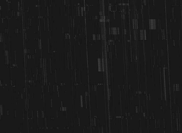

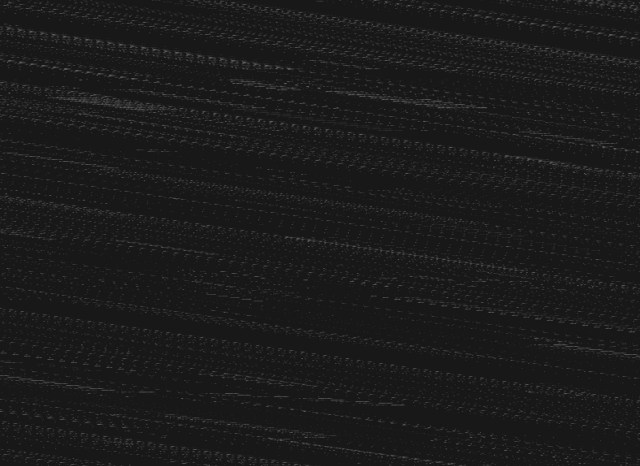

Should've made and attached screenshots right away.... sorry. This is the output of the LG VCR during playback:
[Attachment 69668 - Click to enlarge]
[Attachment 69669 - Click to enlarge]
While the white lines are moving around the screen in a random way, the sound playback is mostly OK with some distortion here and there. Could be due tape degradation but I don't know at this point.
there was no frame TBC in between the camcorder and the recording VCR there is nothing you can do here, The artifacts are baked in -
It is not really easy to troubleshoot a problem like this over a forum, I don't know the origin of the tapes, I don't know the condition of your VCR, I don't know how you are playing back the tapes and the connections used, I'm afraid that there is nothing I can help with here, If you would post a video sample with audio I may try to guess something.
