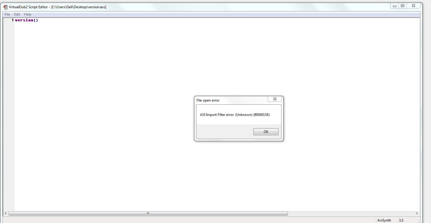

    I've tried the LWLibavVideoSource . But I still get the same error. I also tried it on virtualdub2 and got this error message. Thanks.

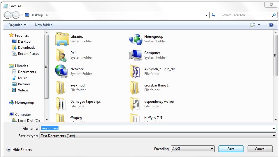

    Thanks davexnet & Sharc. I tried version() and get the same error message with Avidemux. Virtualdub2 loads the script however when I select file>save & open as AVI I get an error message also. Thanks.

    Mar 2008
    You're doing something wrong. Just drag the avs script into vdub2.
    Regarding version(), you can't save it, it's not a video

  8. ^ this,
    or Save & Refresh..... (F5), rather than Save & Open as avi (F7)

  12. With VirtualDub2 be sure to use File -> Open Video File (or drag/drop an AVS script), not File -> Run Script. The latter is for VirtualDub2's own scripting language, not AviSynth scripts. And when using 32 bit AviSynth you must use 32 bit VirtualDub2; when using 64 bit AviSynth you must use 64 bit VirtualDub2.

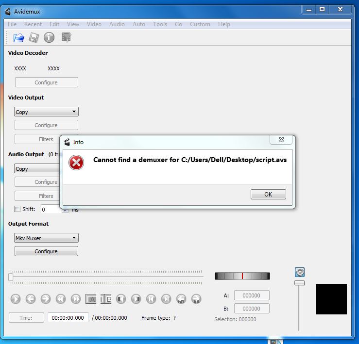

    Thanks Sharc, jagabo & lollo. I've finally been able to open a script in vdub2! I've installed vdub2 32-bit. I can open them with file> open video file or Tools > script editor and also drag/drop method which is fantastic. I've installed Avidemux 2.7.4 32-bit (they don't seem to have version 2.8.1 in 32-bit) but it gives an error message see attached.

    I couldn't get Avidemux to open Avisynth scripts at all, but it kind of works if you run Avsproxy from the command line,
    then in Avidemux file/connect to avsproxy.

  25. I bet the typical Avidemux user does not use Avisynth scripts at all. He opens his sources directly in Avidemux and does the rest with the tools which are provided by the GUI. And eventually lives with what the GUI offers to him. That's the purpose of such GUIs.
  26. Originally Posted by davexnet View Post
    I couldn't get Avidemux to open Avisynth scripts at all, .....
    It seems to work here for YV12() 4:2:0 sources only. It fails however for the 4:2:2 YUY2 (huffyuv) captures. Hence these must be converted with ConvertToYV12(.....) in the script.
    No warranty though, but this seems to be the rule here to let Avidemux open .avs scripts.
  27. AviDemux doesn't work for YV12 scripts here. I also tried YV24, YV16, YUY2, RGB24 and RGB32. All give the same "Cannot find a demuxer..." error that SkyBlues2021 is reporting. It may be because I use it as a portable application (it's never been "installed" on this computer). Maybe there's something in the installation procedure that is needed to enable AviSynth import.
