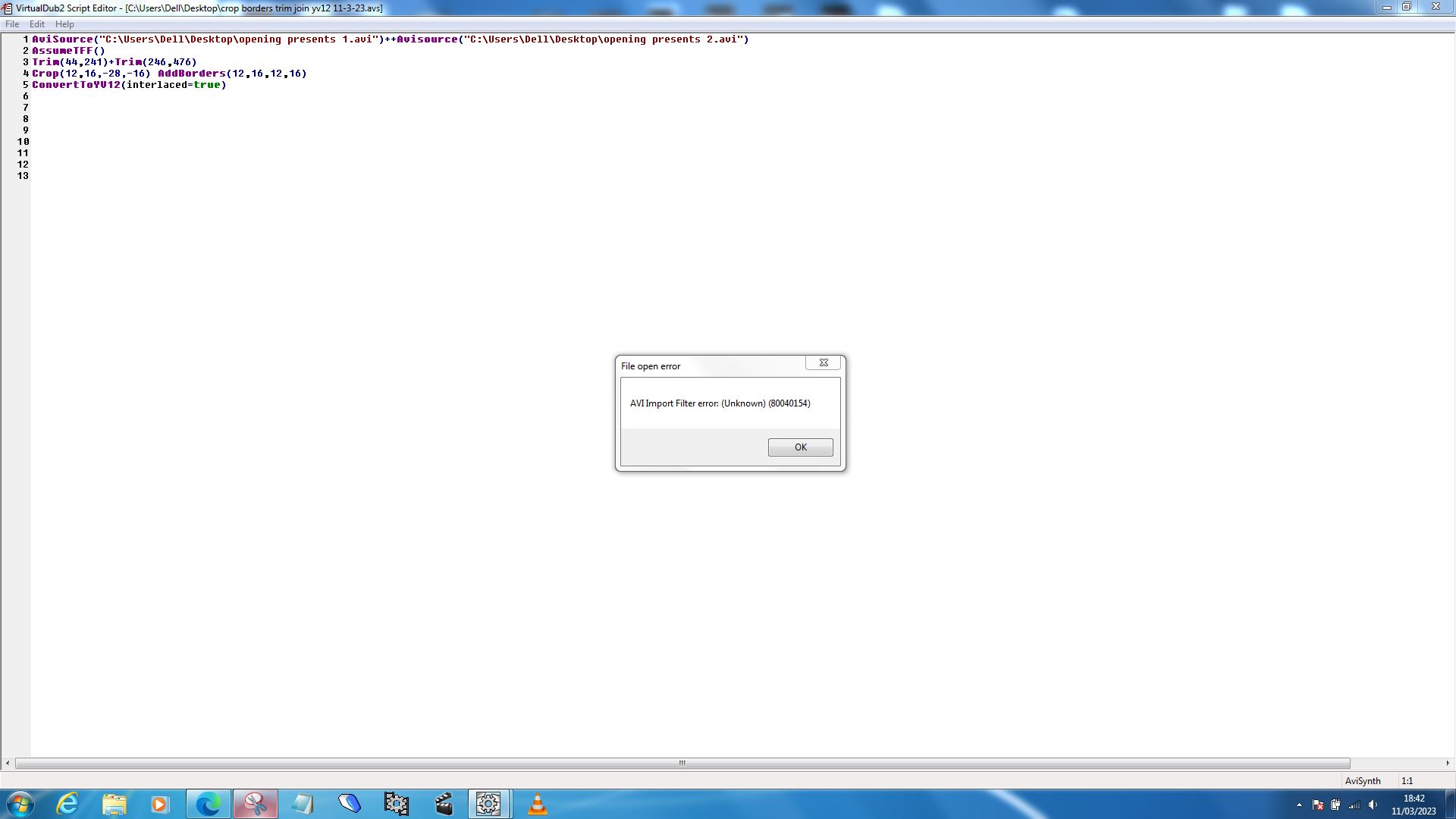

    When I select Tools>Script editor>Open> Crop border trim join yv12 11-3-23(AVS file)> Save & Open as AVI. I get the follow error message (attached). Thanks.
Name:	Virtualdub2 error message.JPG

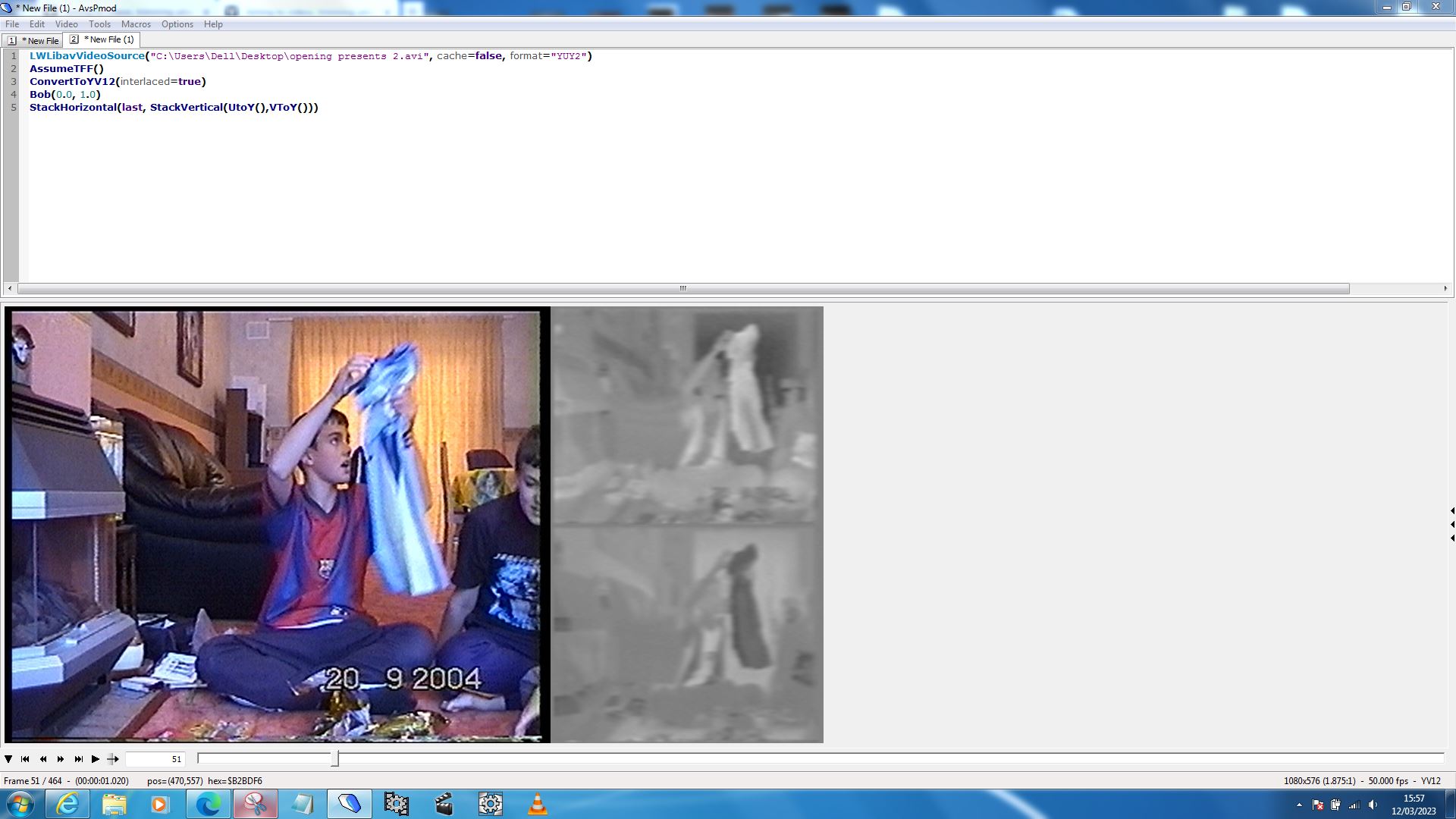

    Thanks jagabo. I looked at the huffyuv.avi with the colours going from right to left. But I was unsure what it meant?
    The code below didn't load was I meant to change something before I ran it? Sorry.
    AviSource("huffyuv.avi") # LWlibavVideoSource("huffyuv.avi", cache=false, format="YUY2")
    AssumeTFF()
    Bob(0.0, 1.0)
    ConvertToYV12(interlaced=true)
    StackHorizontal(last, StackVertical(UtoY(),VToY()))
  10. The huffyuv codec is probably missing in your installation. Either install it, or try the proposed alternative source filter:
    AssumeTFF()
    Bob(0.0, 1.0)
    And yes, I imagine that the intermediate avi which you created could be the source of the troubles

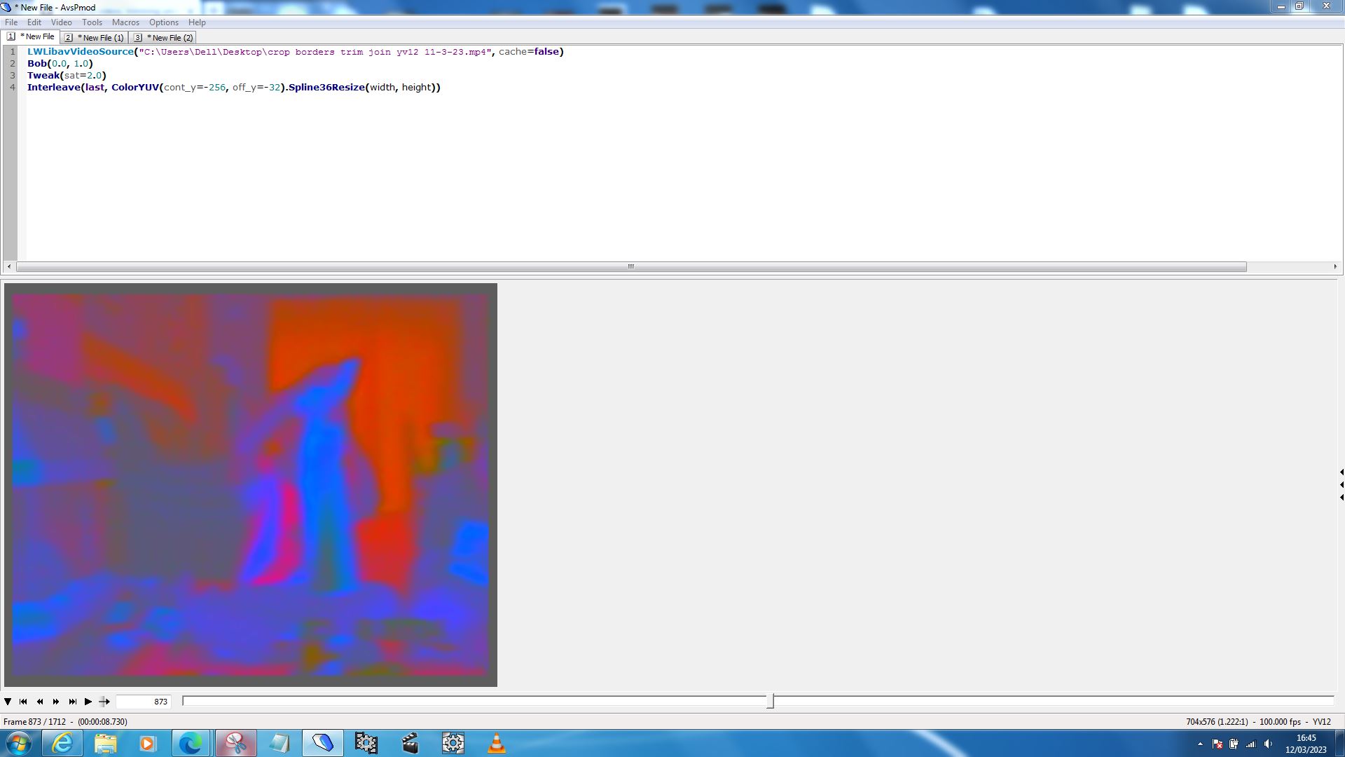

  13. Originally Posted by SkyBlues2021 View Post
    What do you think the reason is that my video hasn't got enough motion?
    I took another look at the video in post #30. Pumping up the saturation makes the chroma more visible and the motion matches the luma. So I'd say it's fine now.
    LWLibavVideoSource("crop borders trim join yv12 11-3-23.mp4", cache=false)
    Bob(0.0, 1.0)
    Tweak(sat=2.0)
    Interleave(last, ColorYUV(cont_y=-256, off_y=-32).Spline36Resize(width, height))
  14. After all it's surprising that one would not even easily notice the jerky luma/chroma mismatch (ghosts) when just viewing the VHS encodes casually.

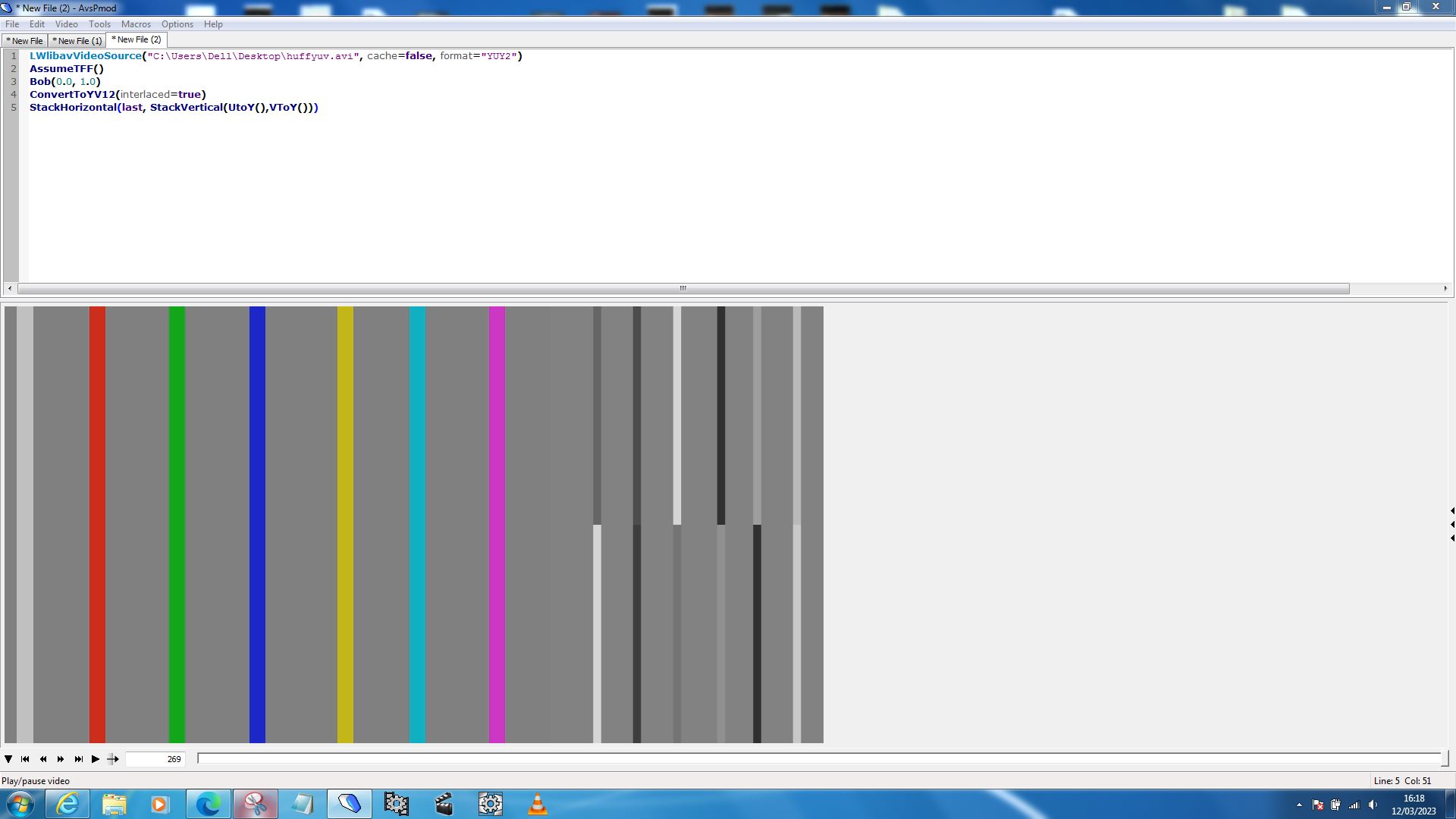

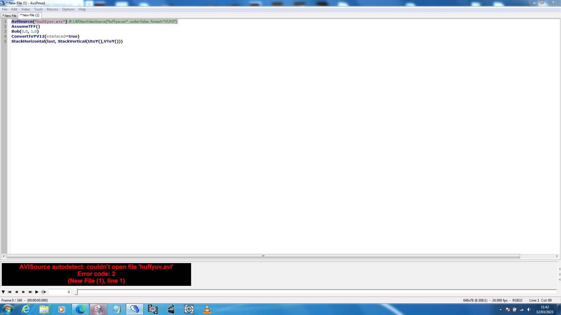

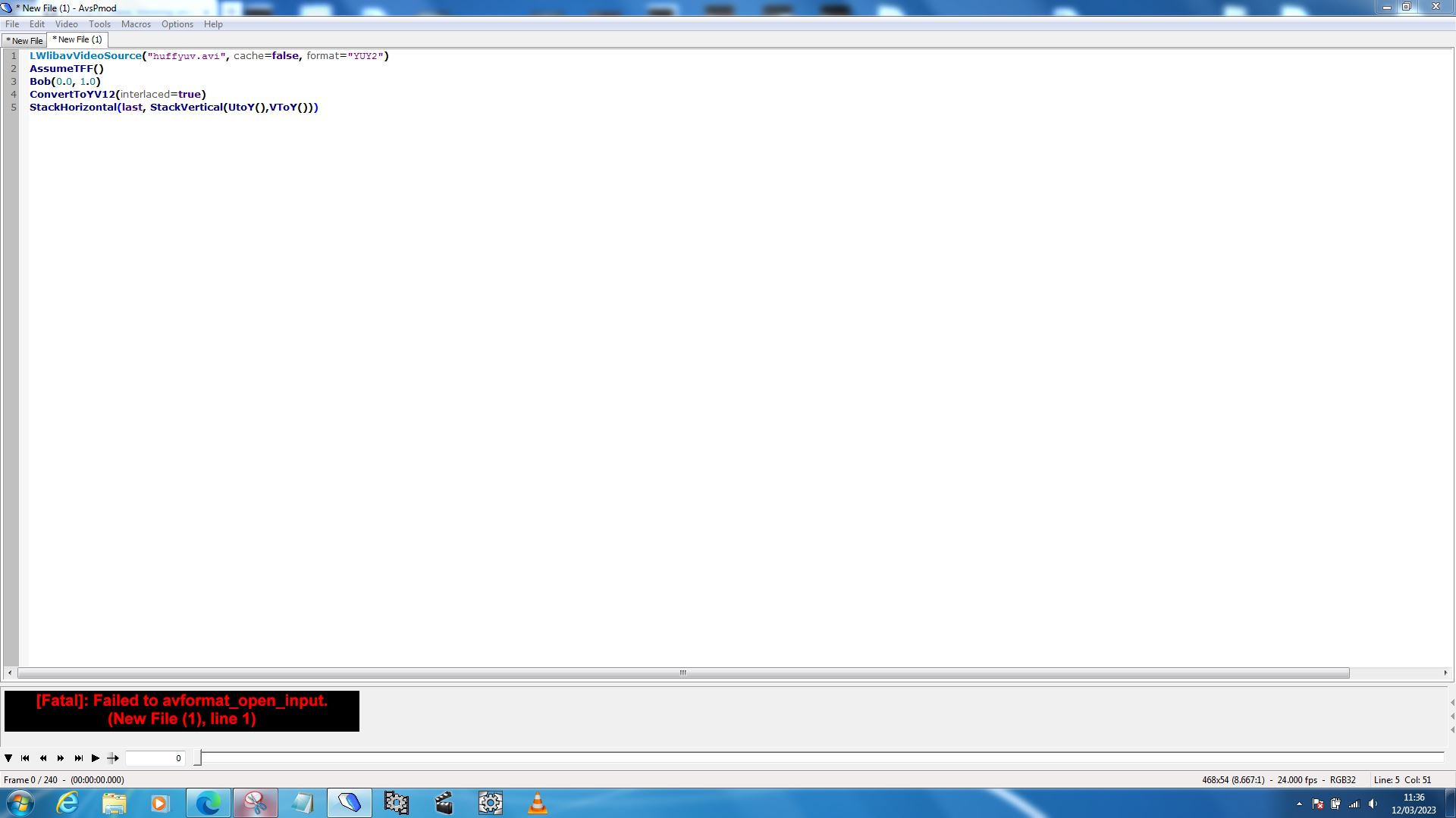

    Thanks Sharc & jagabo. I've attached the error message's that I get with the Huffyuv codes. Should I be putting the path to my video in the Avisource brackets?
    Also I used the code from jagabo's post 43# and watched the clip but I'm not sure what this means? Thanks.
Name:	huffyuv error 12-3.JPG

  16. Is the AVS script in the same folder as huffyuv.avi? If not, you'll have to provide a full path.
  17. Originally Posted by SkyBlues2021 View Post
    That was to visualize that the Chroma (color) moves temprally and spatially in synchronism with the luma (the shapes, objects of the picture), at the same pace. Means no lagging or displacement between Chroma and Luma which would create 'ghosts' or tearing.

    I was able to get script 20# working and script 43# but if I'm honest I don't really understand what I'm looking for.

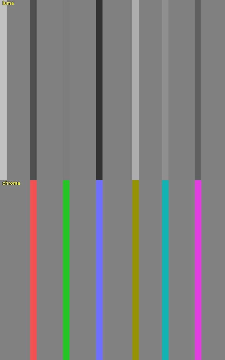

  20. YUV video contains a luma (greyscale) channel and two chroma channels (U and V, technically "Cb" and "Cr"). On-screen RGB colors are created by adding or subtracting the chroma channels from the greyscale channel (that is a simplified description). With YUV 4:2:0 (YV12) video the chroma channels are half the resolution of the luma channel. So for PAL YV12 video the luma is 720x576, but the chroma 360x288. The chroma has to be scaled to match the size of the luma to create the final picture. How that scaling takes place can effect the position of the chroma relative to the luma (ie, the alignment of the colors). This video might make it easier for you to understand what's going on. The luma (at the top) and chroma (at the bottom):
    AssumeTFF()
    Bob(0.0, 1.0)
    StackVertical(last.GreyScale().Subtitle("luma"), ColorYUV(cont_y=-256).Spline36Resize(width, height).Subtitle("chroma"))
    [Attachment 69751 - Click to enlarge]
    The chroma channels in the image are mapped to a flat grey plane, not the actual luma values of the original video. So the colors are not the same as those in the original video. But they have to be mapped onto something for you to see colors.
    Both should move an equal distance (within a pixel) from left to right as you step from frame to frame. I.e. the vertical bars should stay aligned. Change the ConvertToYV12 from interlaced=true to interlaced=false to see the type of error you had in the original encodings.
    VHS of course has very poor resolution horizontally so the colors are much blurrier. That can make it harder to tell when there are problems.
  21. Originally Posted by SkyBlues2021 View Post
    Thanks Sharc. Sorry I didn't see your post before posting. Is mine good or bad? How do you assess it? Thanks.
    Yes, it's good. You would however have to step frame by frame through the video and check whether the Chroma moves (and matches) the luma with every new step. Select a scene with movement/action for this, like the moving towel.
    But yes, it's good, and you may continue.

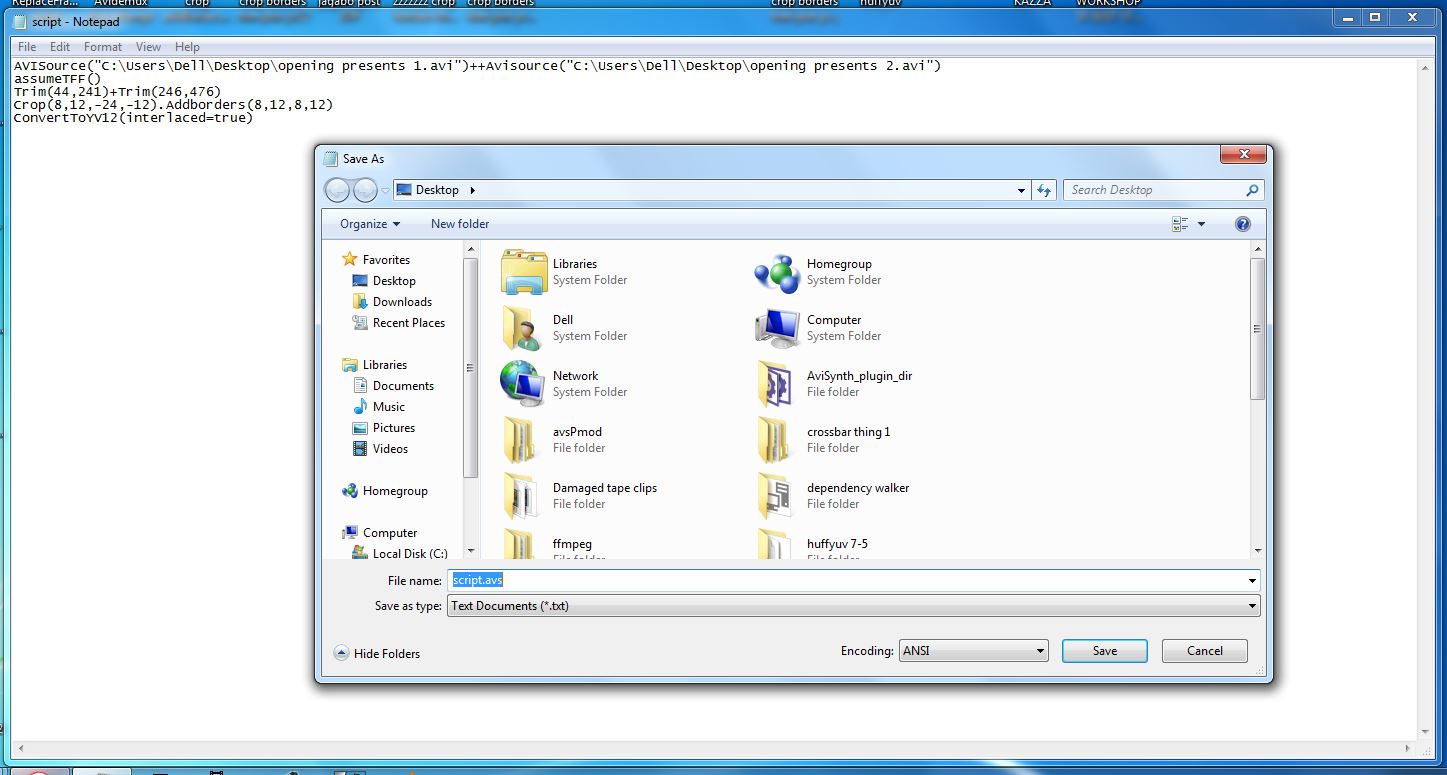

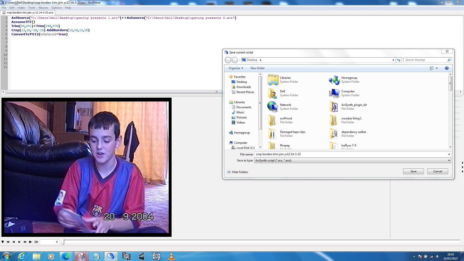

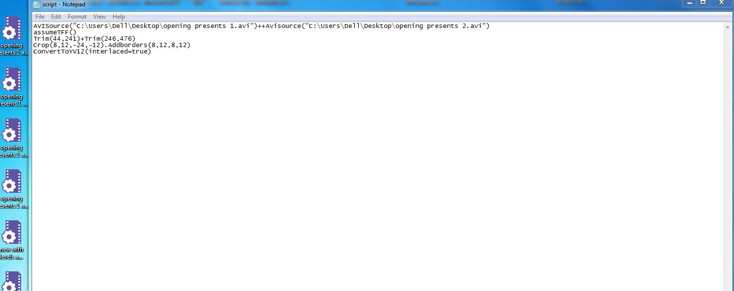

  27. You have to save the script in a file. This is a text file with the extension .avs instead of .txt. (Attachment)
    In Avidemux
    i) File->open ...... -> select the script.avs file
    or
    ii) Simply drag and drop the script.avs onto the Window of Avidemux

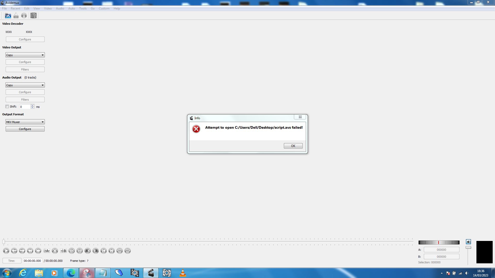

    I've been trying to load Sharc's script in Avidemux without success. I've only changed the path in the script. It's the same problem I have in virtualdub2 in that if I don't save the script as a intermediate AVI file in virtualdub I can't load it. So my problem seems to be running .avs files in Avidemux & virtualdub2. I can load all my AVI files. I don't know if I'm not saving them correctly I tried to show examples in my attachments. It wouldn't have anything to do with both encoders being 64 bit? but my virtualdub 1.9.11 and Avisynth+ are 32 bit Thanks.
