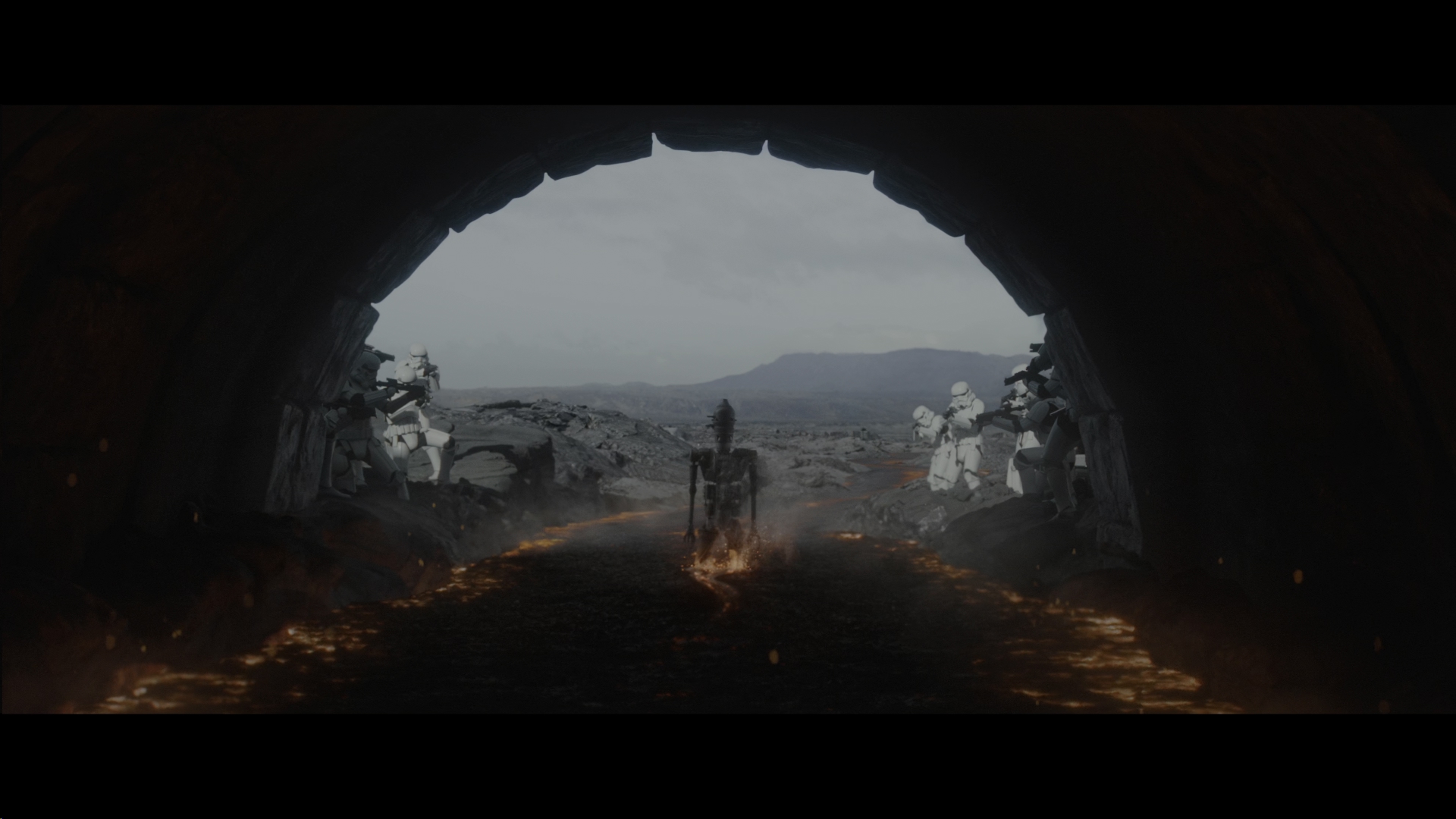

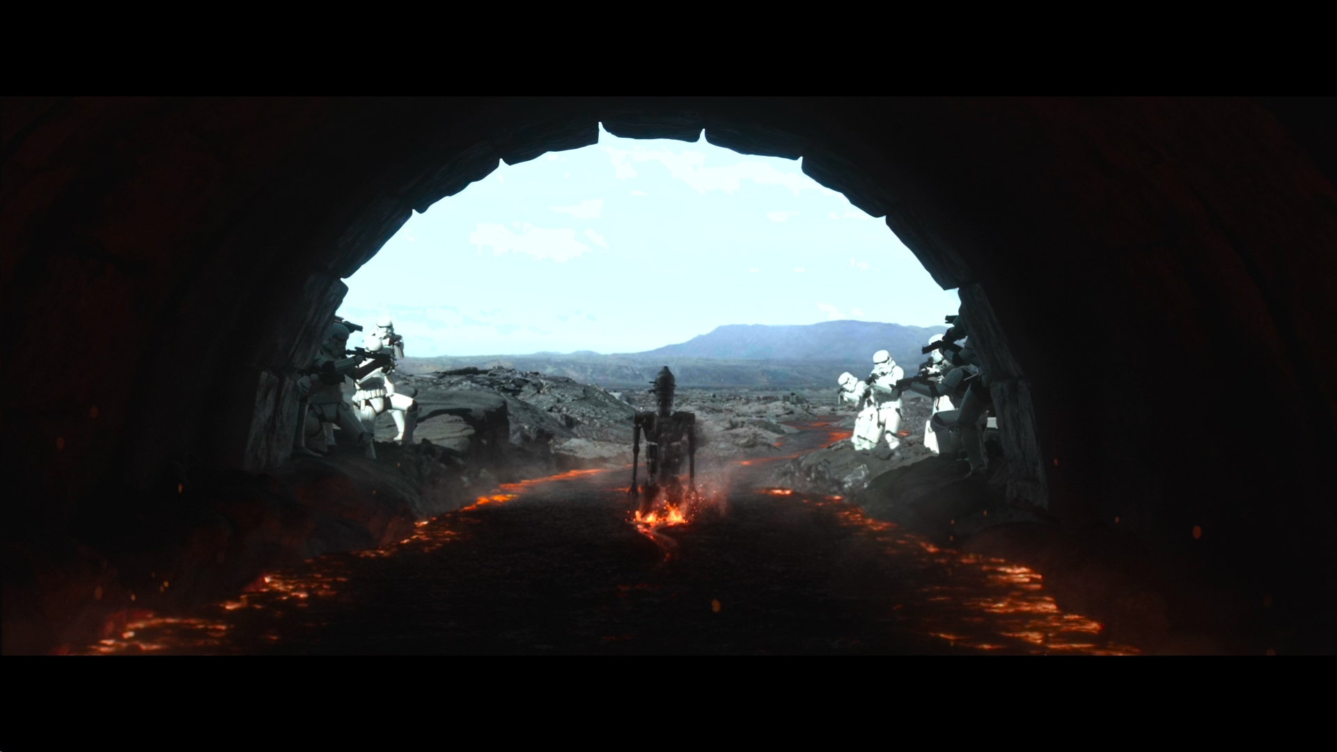

    I've trying to encode HDR 4k, But it dosnt being like source movie.
    my output movie is too shining, but source file is really darkest:
    my release: Image
    [Attachment 69620 - Click to enlarge]
    source release: Image
    [Attachment 69621 - Click to enlarge]
    and this is my preset:
    --deblock -3:-3:-3 --output-depth 10 --frame-threads 12 --rc-lookahead 60 --subme 4 --colorprim bt2020 --transfer smpte2084 --colormatrix bt2020nc --master-display G(8500,39850)B(6550,2300)R(35400,14600)WP(15635,16450)L(10000000,0) --max-cll 711,617

    Really i encoded through avisynth, from premiere.

    i've tested it without avisynth and premiere and the problem was fixed.
    i have to do some edit on movie first (with Premiere), and then encode it with the help of frameserver (on Premiere) and avisynth (on ffmpeg).
    i guess the problem is related to the avisynth script or frameserver plugin of preimere.
    in your opinion, could it related to the avisynth script, like YV12 code or etc?

  14. my 2cents:
    Assuming you are encoding to HDR10 as output and not to SDR.
    My guess is what happens:
    When Premiere opens the source file directly, it sees that the content is HDR10 and copied the hdr metadata from the input to the output. (or configured the Premiere project accordingly)
    When Premiere opens the source through AviSynth, that metadata is missing, thus Premiere handles the content as SDR.
    So to let Premiere know that the content is HDR you need to add the metadata manually. Since I never used Premiere, I have no clue how to set color matrix, min/max light level, master display info and luma range, but from what I read this seems to be the issue to me.
    Cu Selur

  16. Originally Posted by Selur View Post
    my 2cents:
    Cu Selur
    so as you said, the outputs from premiere, all are SDRs and its useless for me that i use HDR presets for this project, is this right?
