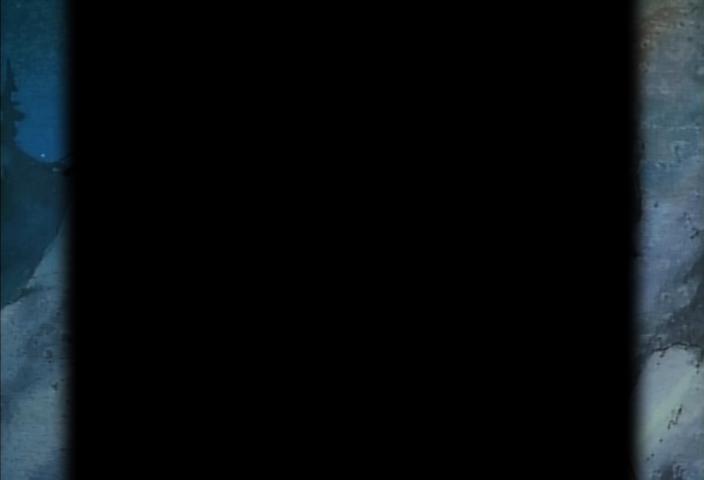

Use Overlay() with an alpha mask. I don't think blurring the center will work. But replacing it with black should:
Code:# input previously cropped to 704x480 with Crop(4,0,-12,-0) black = BlankClip(last) alpha = BlankClip(last, width=576, height=480, color=$ffffff).AddBorders(64, 0, 64, 0, color=$000000).ColorYUV(cont_y=50).BilinearResize(44, 30).Spline36Resize(704, 480) Overlay(last, black, mask=alpha)
[Attachment 69616 - Click to enlarge]
It works ok with the provided sample but there may not be enough detail left at the edges for other shots. Which means you will have to isolate the problematic shots. In which case using dymax=0 would be much easier.Last edited by jagabo; 7th Mar 2023 at 08:08.

I think jagabo has what I need. I had not thought to exploit resizing artifacts to produce a gradient. That's a nice little hack. This technique can also be applied vertically for more width information. I will need to keep an eye on pans, but that is hardly unique. The resize and alpha did noticeably slow things down, but the rest of my filter chain is so slow I hope I won't notice on the batch job.
Code:inter = Interleave(temp.Repair(clp.TemporalSoften(1,255,255,25,2)),clp) border = 64 alpha = BlankClip(inter, width=inter.width-2*border, height=inter.height-2*border, color=$ffffff).AddBorders(border, border, border, border, color=$000000).ColorYUV(cont_y=50).BilinearResize(12, 8).Spline36Resize(inter.width, inter.height) mfilter = Overlay(inter, BlankClip(inter), mask=alpha) mdata = DePanEstimate(mfilter,range=range,trust=trust,winx=winx,winy=winy,wleft=wleft,wtop=wtop,dxmax=dxmax,dymax=dymax)
It might not even be necessary to blur the edges of the mask. That would make it even simpler, just overlay a black box.
It might be useful to have StabInside() and StabOutside() user supplied block coordinates. Or maybe StabMask() with a user supplied mask.Last edited by jagabo; 7th Mar 2023 at 11:19.
I don't understand the FFT comparison mechanism well enough, but I think the gradient is desirable. If you just have a black box, the edge of that represents a significant element that is temporally stable. Having the gradient instead allows the unstable elements to fade instead of wink preserving the FFT differences from the edge better. I would need someone more familiar with what dePanEstimate() is doing to opine.
