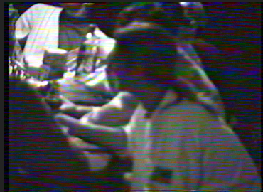

    I'm facing several difficulties when digitizing VHS tapes. My goal is to digitize at a lower cost and at the most original quality.
    This is why I use a passthrough via a camcorder (Sony DCR-TRV345E) to my PC via Firewire (picture below).
    *It's a PAL camcorder*
    I was able to do this, but some of the tapes didn't show colour with a degraded image. (like this)
    *VCR (Sharp VC-MH68FPM) can read PAL/SECAM/MESECAM*
    I could deduce that the problem came from the formats, I am French, here we used SECAM/MESECAM and SCART.
    About the VHS that I can't digitize, they have TV/Film recordings and footage from camcorders (I think VHS-C, which uses the SECAM standard recording in France)

    Or just get a decent NTSC/PAL/SECAM capture device and don't have to worry about converting the signal which always come at a price or quality loss.

    A pure French Secam-L recording gives you very limited choices. If the camcorder can output Secam-L, you can use a standard usb capture device from camcorder to PC setting the format to Secam.
    A somewhat more expensive option is to use a ADVC 300 from the camcorder to PC over firewire which 'converts' the Secam output to Pal input .
    The final option, as again stated, is a multi-system vcr that outputs pure Secam-L which then allows you to capture as in the first option.
    Not having such a vcr, a 'shot in the dark' is to set up your vcr for Secam but the capture device as Pal

    The OP has stated clearly that he has true SECAM VHS tapes, The reason why he is getting B&W is because the camcorder he is using in Passthrough does not support SECAM.

    He already has the SECAM VCR, He doesn't have a way to capture native SECAM tapes, He used a PAL camcorder as a capture device to DV that is obviously incompatible with SECAM, I gave him the solution in the second post.
