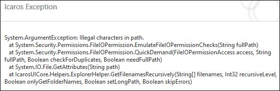

    Jagabo - Icaros failed for the reasons shown in the attachment. I presume those same reasons are causing 'the problem' in the first place.
    S-mp Use VLC to change icons to thumbnails - how ?
    PCspeak - I can't understand your instructions and there seems to be a contradiction about K-Lite

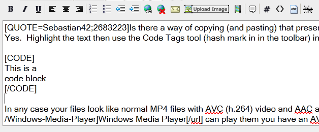

  22. Originally Posted by Sebastian42 View Post
    Is there a way of copying (and pasting) that preserves the format as YOU show it ?
    Yes. Highlight the text then use the Code Tags tool (hash mark icon in in the toolbar) in toolbar above the edit box. Or type in the code block text:
    This is a
    code block
    [Attachment 69613 - Click to enlarge]
    In any case your files look like normal MP4 files with AVC (h.264) video and AAC audio. Since Windows Media Player can play them you have an AVC decoder installed -- so you should have thumbnails instead of a generic icon. I don't know what the problem is.
