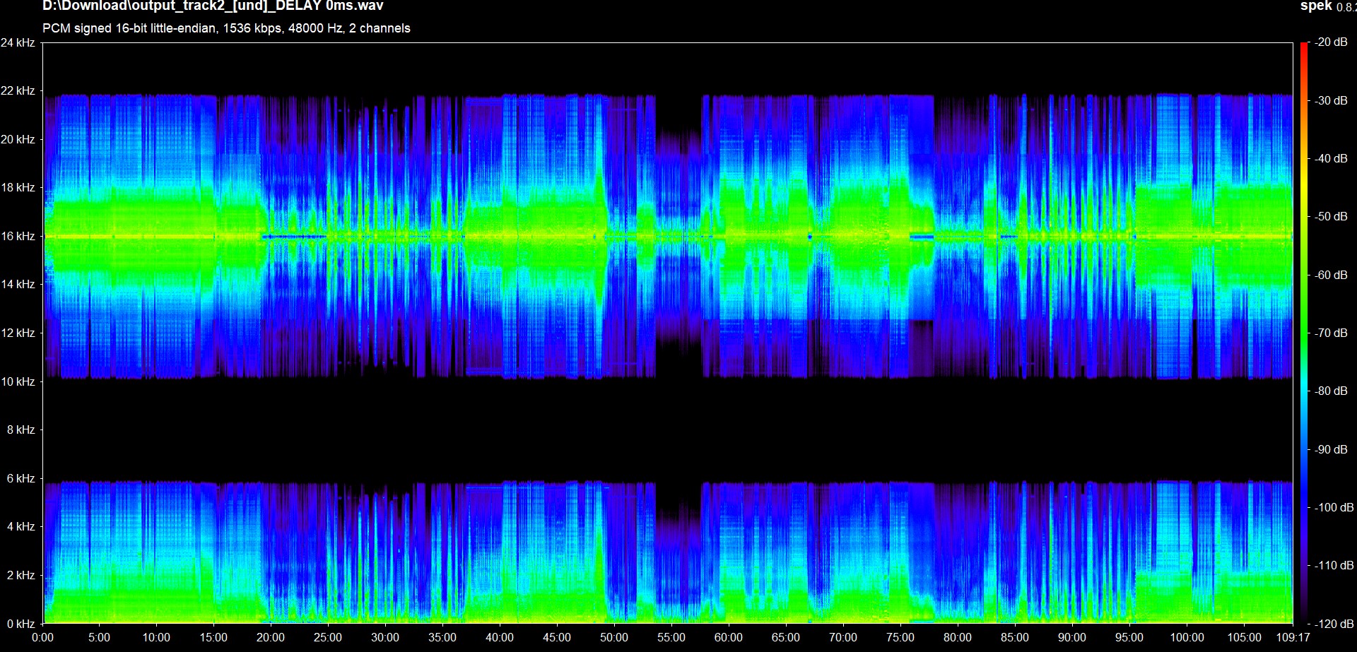

I used dBpoweramp to converted it to wav. Looks strange
[Attachment 69528 - Click to enlarge] -

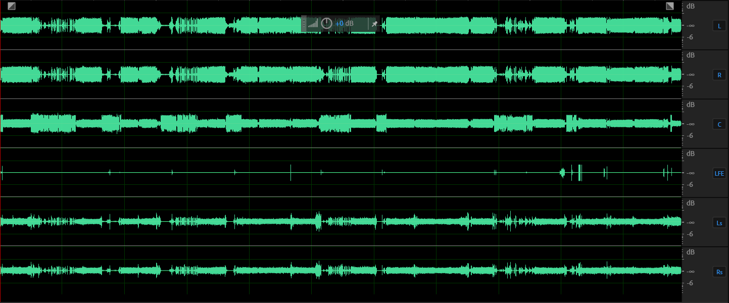

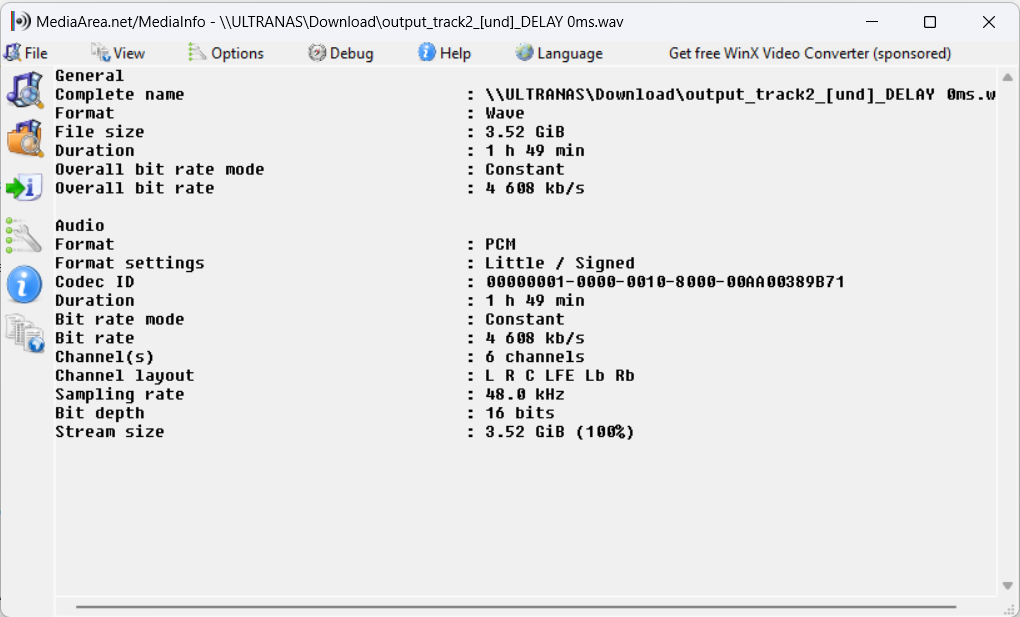

I installed dbpoweramp, which is using LAV filters + Directshow to decode AC3, and it's decoding the 2.0 AC3 to 5.1 WAV:
[Attachment 69529 - Click to enlarge]
It is inventing 5.1 as well as Adobe Audition, and again the LFE is pretty blank:
[Attachment 69530 - Click to enlarge]
Audition uses Windows Media Foundation to decode, which might be relaying on Directshow, too.

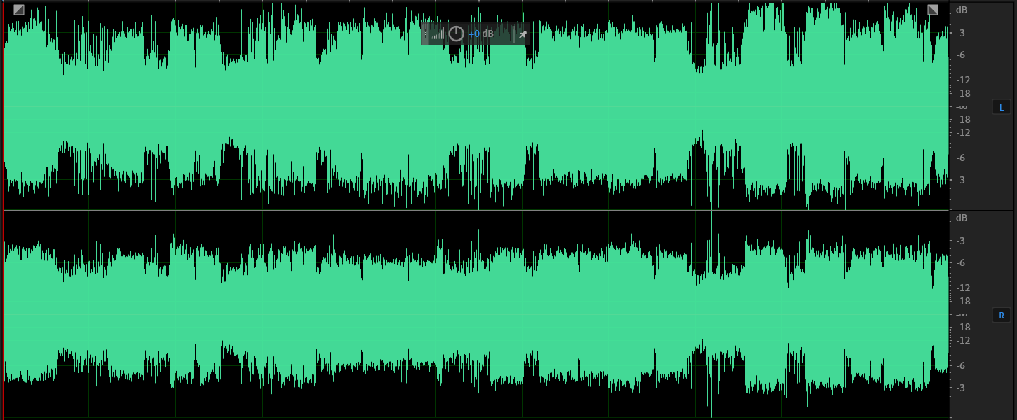

In the meanwhile, if I directly open the AC3 track I uploaded, which is simply extracted from the MKV by MKVextract, I have readable content but L channel is louder then R channel:
[Attachment 69531 - Click to enlarge]
It's becoming stunning
Still can only imagine this is the result of any matrix encoding, can't imagine any other reasons...

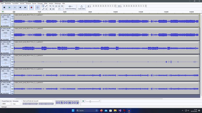

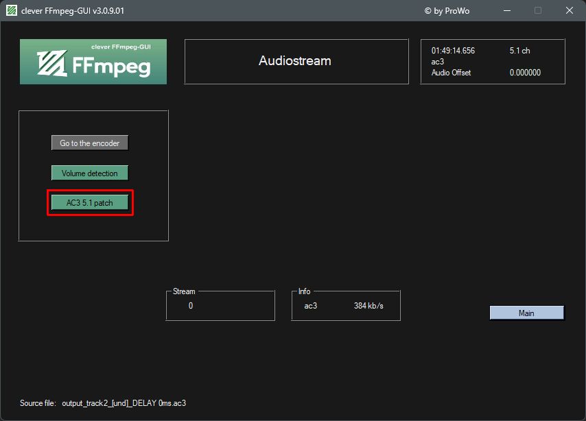

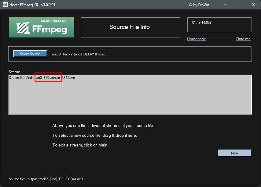

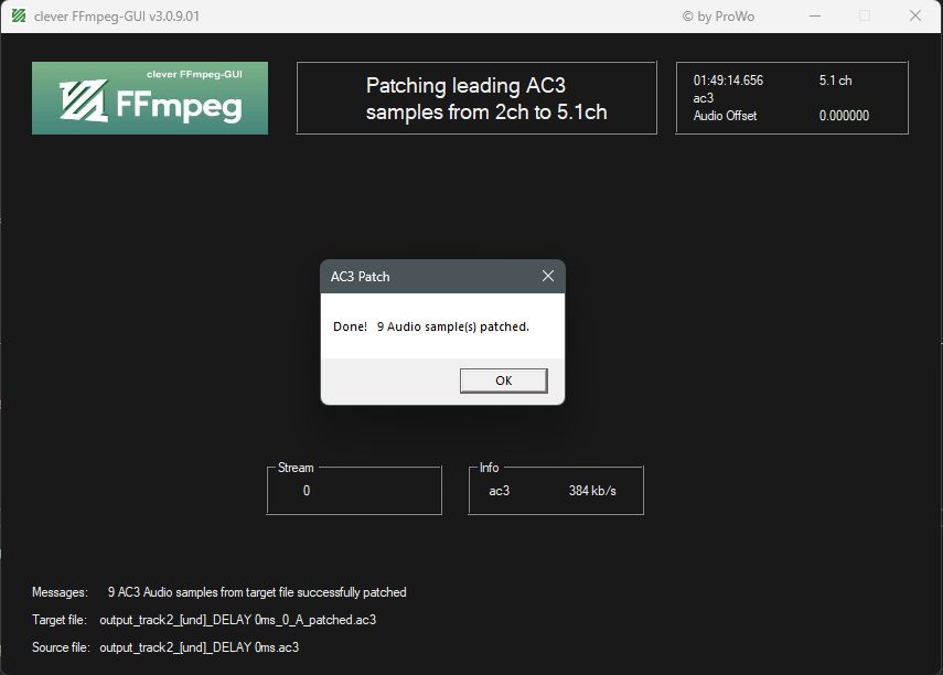

As i sayed, ac3 5.1 with leading 2ch samples (9).
Use clever FFmpeg-GUI to patch such ac3 audio files.

So you think it's 2.0 AC3 with Pro Logic?
By the way this is exactly the same output I have with Audition, with LFE pretty absent...
Moreover I couldn't find FFmpeg-GUI 3.0.9.01, and on FFmpeg-GUI 3.0.9 I don't have the AC3 5.1 Patch button.

Got it definitely, thanks.
Ok, sorry but at this point I might have lost a bit.
If it is already 5.1, why should I use the AC3 5.1 Patch?
What is it exactly doing?

In your opinion, the LFE pretty blank, is an error or a strange choice of production?
Regards -
It is a NORMAL choice of production. You want the LFE to be as loud as your main signal? That would shake your house apart! (only partly exaggerating)
Most balanced mixes have a quite small amount of LFE - remember LFE properly used should only include Low Frequency Effects, not standard LF or subwoofer-intended sound.
The choice of going to main vs subwoofer speakers, etc is determined by the playback decode software/device, based on the room's equipment.
