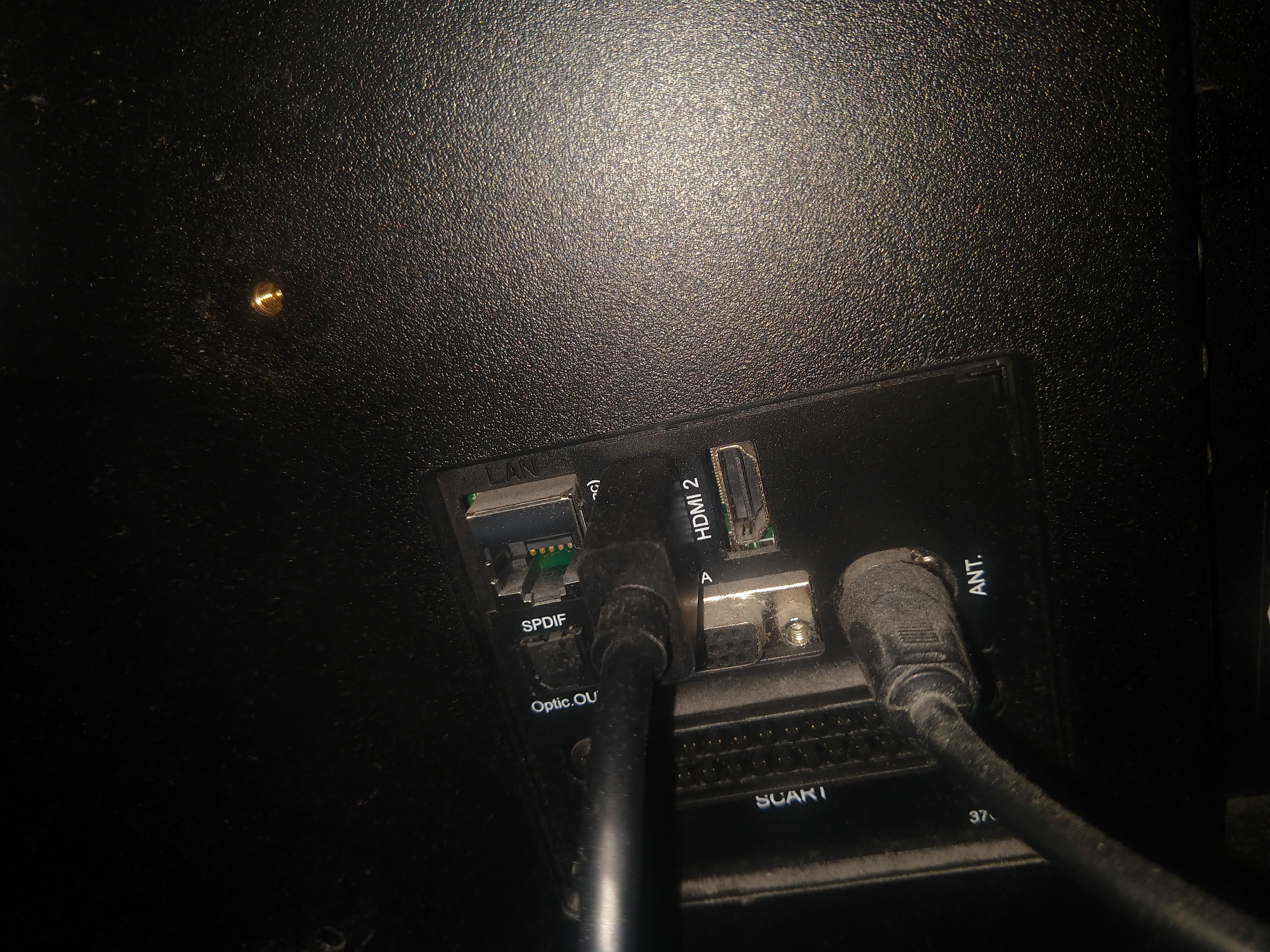

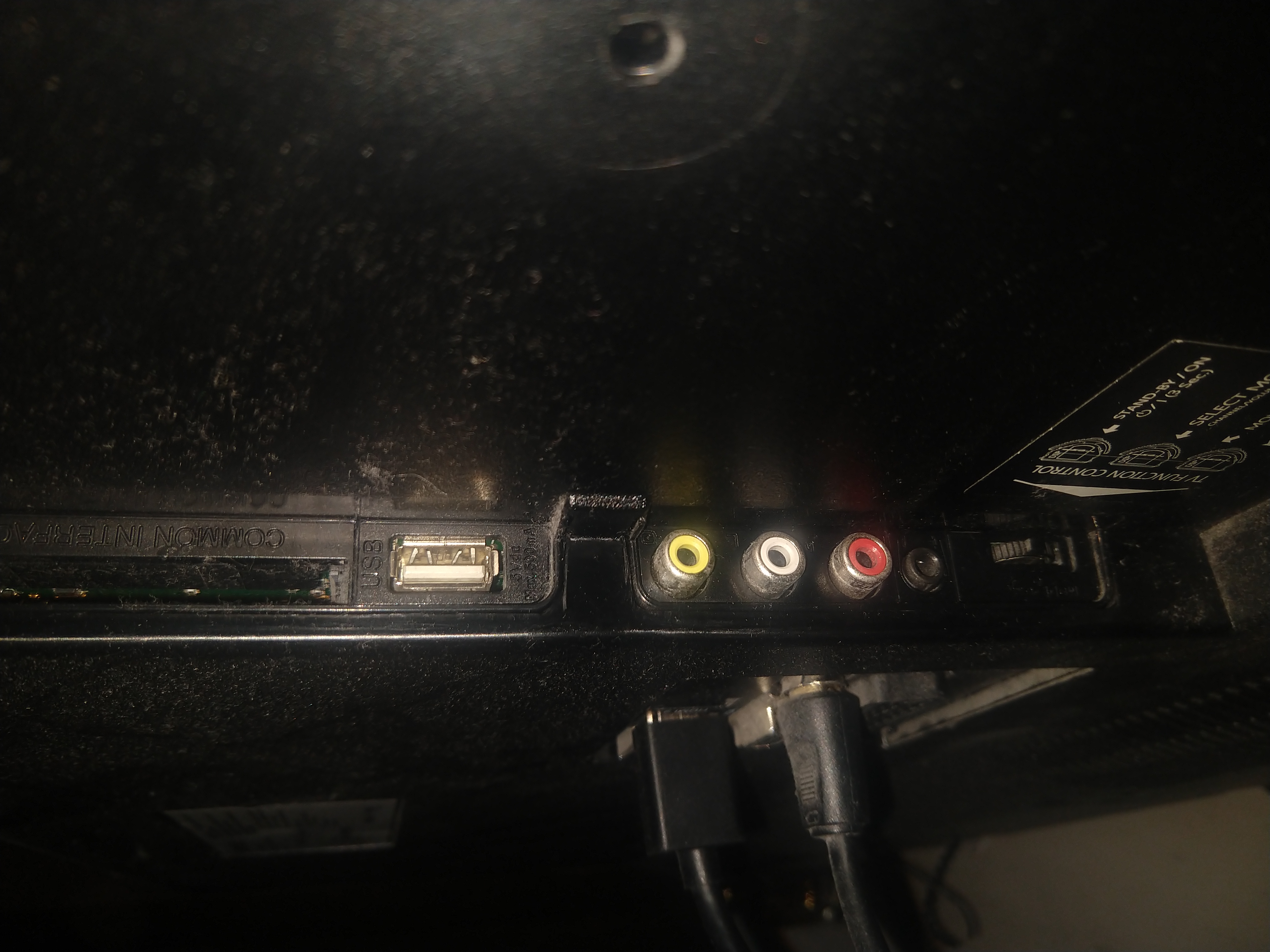

    I can't work out what sockets you have on your TV. Could you post a pic?

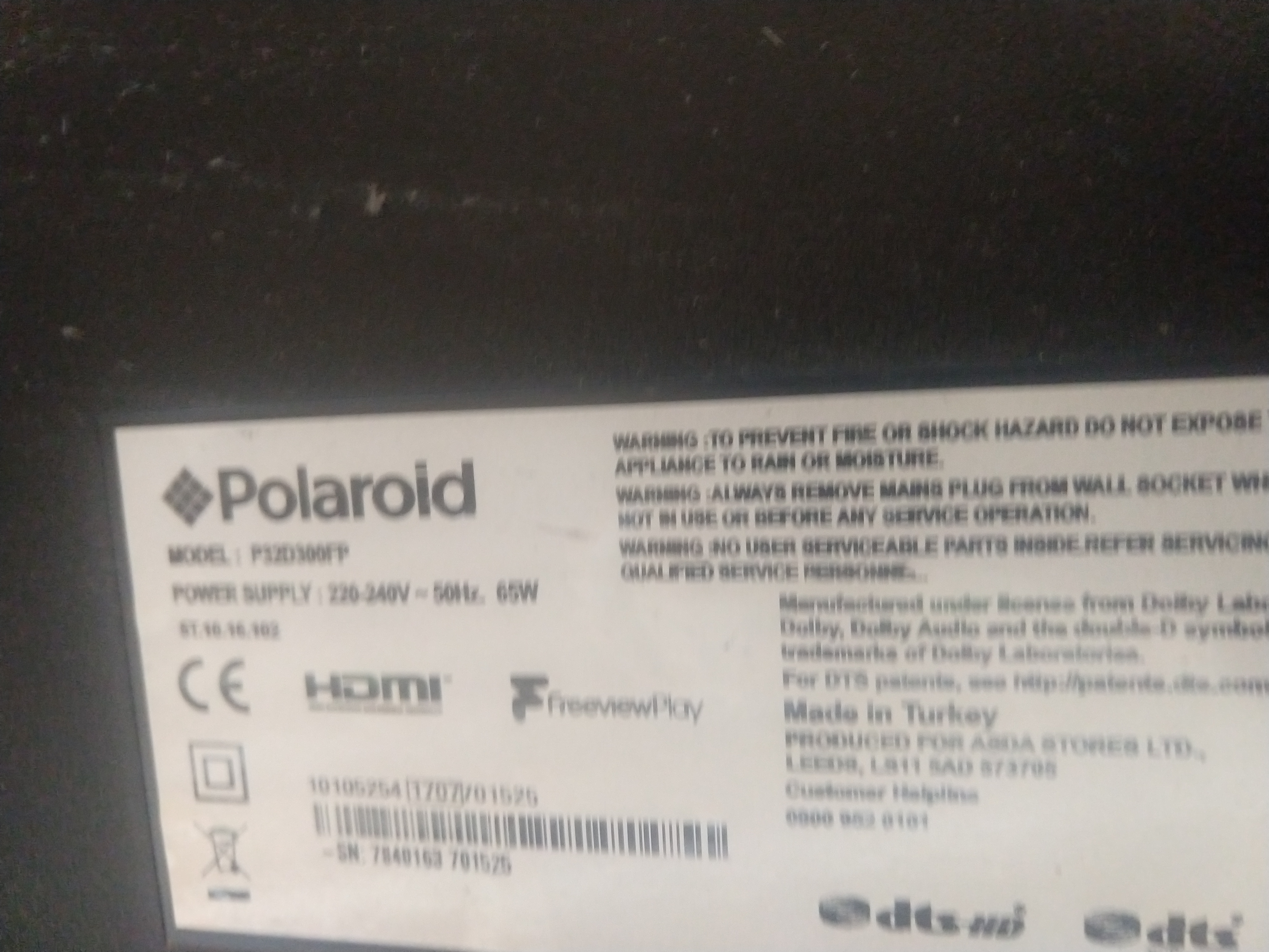

  24. Originally Posted by Alwyn View Post
    I see it.
    i have attached picsImage
    [Attachment 69970 - Click to enlarge]
    [Attachment 69971 - Click to enlarge]
    [Attachment 69972 - Click to enlarge]

  26. Originally Posted by lollo View Post
    I can't really help you with SCART because I don't know enough about it. We never had SCART in N. America. Someone from an EU country that uses SCART needs to help you diagnose your problem.
    It is not clear for me what is the problem.
    To OP: what happens if you just connect the Camera to your TV. No capture devices, dvd recorders or whatever else in the middle (just the player and the display)? .Do you have a "clean" and stable image?
    ok got round to doing this on both polaroid tv and samsung tv,im amazed actually, i thought it would have played ok that way,but its still a bit wavy and blurry.
    playing 100 percent through the viewfinder on cam.

    Try another lead. It doesn't need to be yellow; you can use the red RCA audio lead, just connect to both yellow sockets eg that side yellow Composite socket on your Polaroid.
    If the viewfinder's good, the only common factor is the lead.
