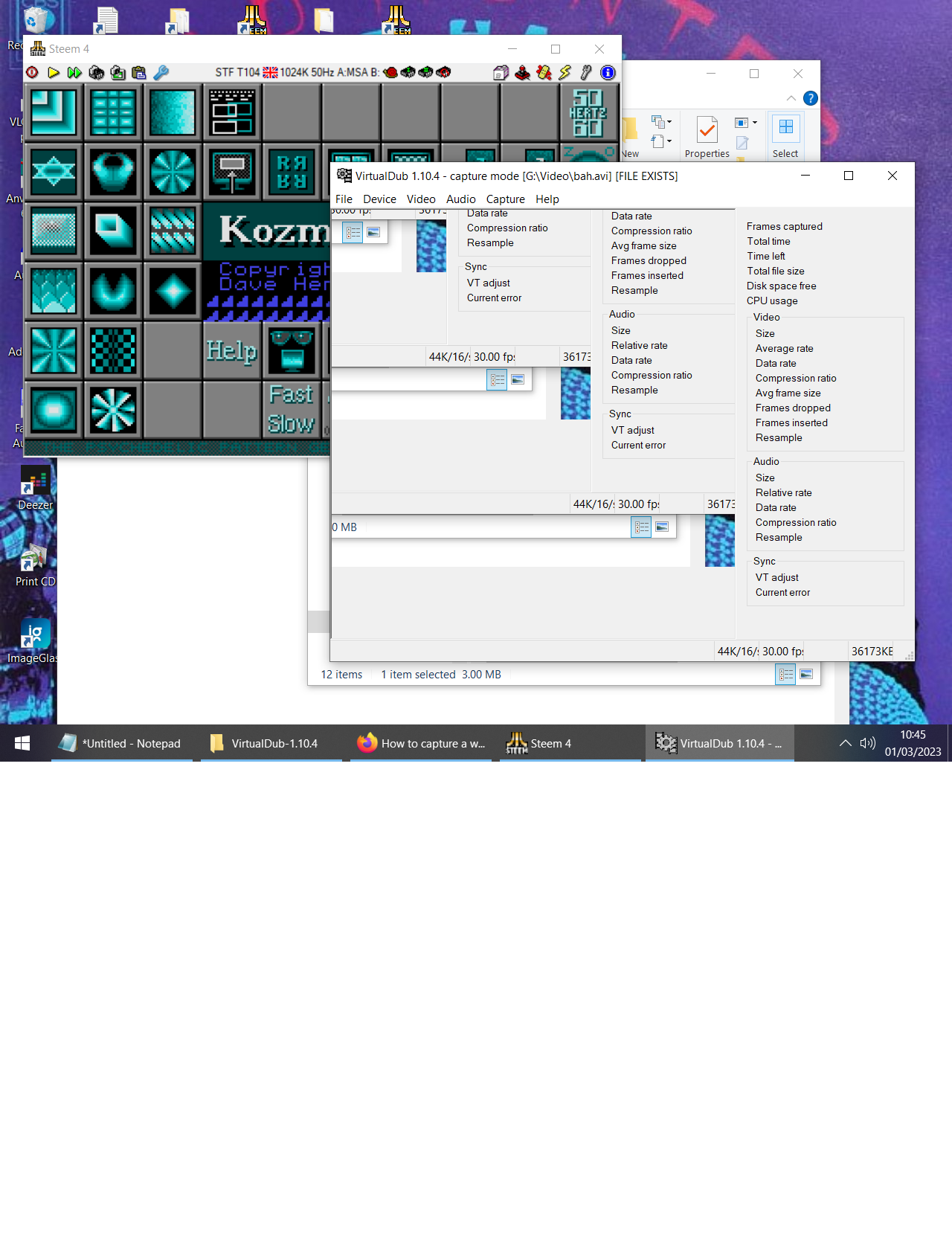

    I want to capture a full window using virtualdub 1.10.4. (Capturing Steem, an Atari Emulator)
    It captures the top left of the screen, but previously I had it set so it would capture the whole Window of the screen after clicking maximise.
    If I do this now, it only captures the top left.
    Does anyone know how to set it so it captures a window?
    I might be wrong but I think I was running windows 7, I'm now on windows 10, although I do remember that when you select capture, by default it captures the top left.

    Yes, that's how I'm doing this you're right.
    Here's my process so far.
    Capture AVI
    Set Capture file
    Set Custom Format:
    Frame Size-
    640 x 480
    Data Format-
    32-bit ARGB
    (would it help to try a different data format?)

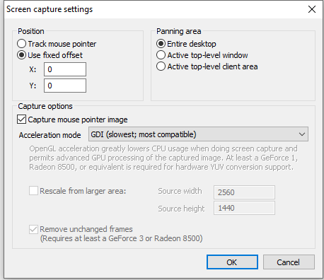

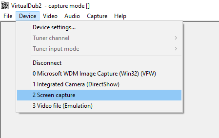

    I have the 'source' settings as you've posted above,
    along with the screen capture selected under 'device'.
    I've tried various settings but haven't managed to achieve the same result as I did a few years ago. I'll give OBS another try today, but thanks, if you have any ideas on capturing the Steem window (usually full desktop) that'd be great. I wondered if maybe it's the resolution settings of windows which is causing it to not capture the full screen of the window when I maximize it? I'm always a little over careful when it comes to changing settings like that, but do you think its worth a try?

    If you change Frame size to the size of your desktop resolution does it capture all off it?
